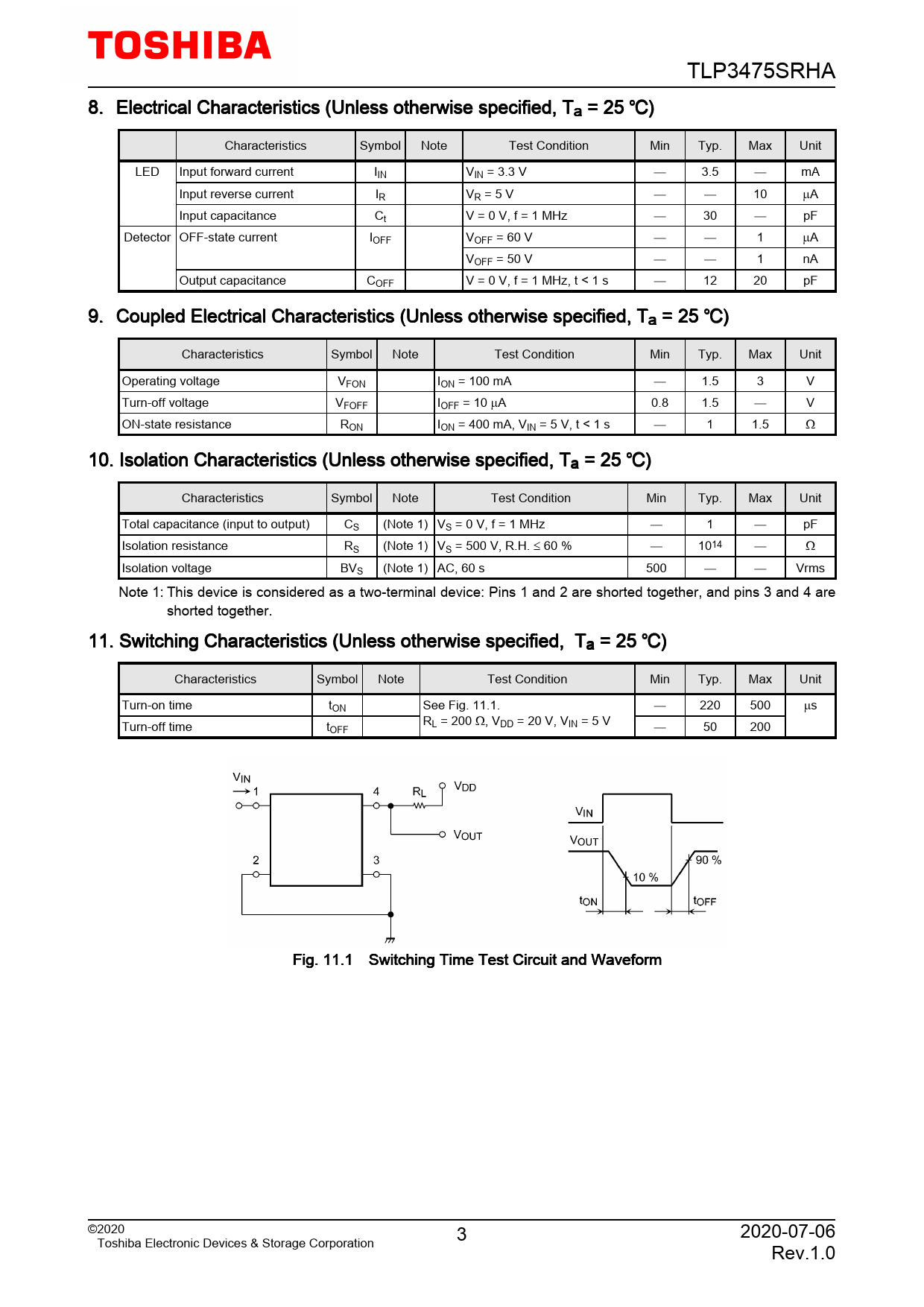

TLP3475SRHA. 8. Electrical. Characteristics. (Unless. otherwise. specified,. Ta. =. 25. ). Characteristics. Symbol. Note. Test. Condition. Min. Typ. Max
TLP3475SRHA 8 Electrical Characteristics (Unless otherwise specified, Ta = 25 ) Characteristics Symbol Note Test Condition Min Typ Max
TLP3475SRHA 8. Electrical Characteristics (Unless otherwise specified, Ta = 25 ) Characteristics Symbol Note Test Condition Min Typ. Max Unit LED Input forward current IIN VIN = 3.3 V  3.5  mA Input reverse current IR VR = 5 V   10 µA Input capacitance Ct V = 0 V, f = 1 MHz  30  pF Detector OFF-state current IOFF VOFF = 60 V   1 µA VOFF = 50 V   1 nA Output capacitance COFF V = 0 V, f = 1 MHz, t < 1 s  12 20 pF 9. Coupled Electrical Characteristics (Unless otherwise specified, Ta = 25 ) Characteristics Symbol Note Test Condition Min Typ. Max Unit Operating voltage VFON ION = 100 mA  1.5 3 V Turn-off voltage VFOFF IOFF = 10 µA 0.8 1.5  V ON-state resistance RON ION = 400 mA, VIN = 5 V, t < 1 s  1 1.5 Ω 10. Isolation Characteristics (Unless otherwise specified, Ta = 25 ) Characteristics Symbol Note Test Condition Min Typ. Max Unit Total capacitance (input to output) CS (Note 1) VS = 0 V, f = 1 MHz  1  pF Isolation resistance RS (Note 1) VS = 500 V, R.H. ≤ 60 %  1014  Ω Isolation voltage BVS (Note 1) AC, 60 s 500   Vrms Note 1: This device is considered as a two-terminal device: Pins 1 and 2 are shorted together, and pins 3 and 4 are shorted together. 11. Switching Characteristics (Unless otherwise specified, Ta = 25 ) Characteristics Symbol Note Test Condition Min Typ. Max Unit Turn-on time tON See Fig. 11.1.  220 500 µs Turn-off time t RL = 200 Ω, VDD = 20 V, VIN = 5 V OFF  50 200 Fig. 11.1 Switching Time Test Circuit and Waveform ©2020 3 2020-07-06 Toshiba Electronic Devices & Storage Corporation Rev.1.0
