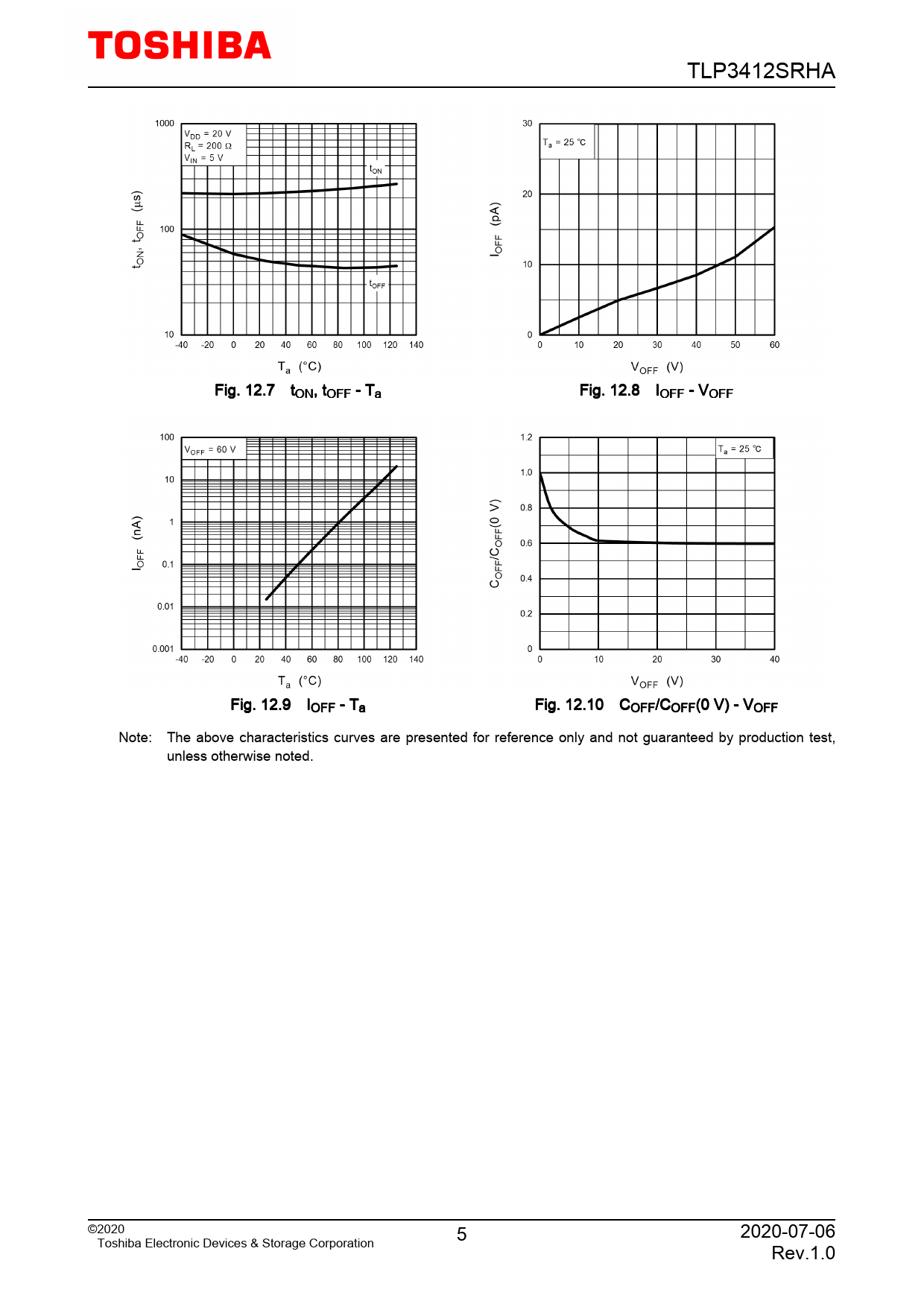

Pages / Page11 / 5 — TLP3412SRHA. Fig. 12.7. tON,. tOFF. -. Ta. Fig. 12.8. IOFF. -. VOFF. Fig. …
File Format / SizePDF / 325 Kb
TLP3412SRHA. Fig. 12.7. tON,. tOFF. -. Ta. Fig. 12.8. IOFF. -. VOFF. Fig. 12.9. IOFF. -. Ta. Fig. 12.10. COFF/COFF(0. V). -. VOFF. Note:. The. above. characteristics. curves
TLP3412SRHA Fig 12.7 tON, tOFF - Ta Fig 12.8 IOFF - VOFF Fig 12.9 IOFF - Ta Fig 12.10 COFF/COFF(0 V) - VOFF Note: The above characteristics curves
TLP3412SRHA Fig. 12.7 tON, tOFF - Ta Fig. 12.8 IOFF - VOFF Fig. 12.9 IOFF - Ta Fig. 12.10 COFF/COFF(0 V) - VOFF Note: The above characteristics curves are presented for reference only and not guaranteed by production test, unless otherwise noted. ©2020 5 2020-07-06 Toshiba Electronic Devices & Storage Corporation Rev.1.0
