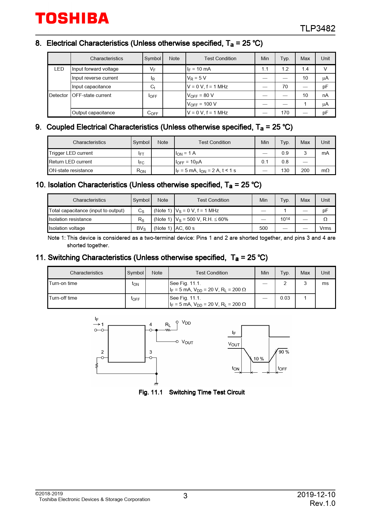

TLP3482. 8. Electrical. Characteristics. (Unless. otherwise. specified,. Ta. =. 25. ). Characteristics. Symbol. Note. Test. Condition. Min. Typ. Max. Unit. LED
TLP3482 8 Electrical Characteristics (Unless otherwise specified, Ta = 25 ) Characteristics Symbol Note Test Condition Min Typ Max Unit LED
TLP3482 8. Electrical Characteristics (Unless otherwise specified, Ta = 25 ) Characteristics Symbol Note Test Condition Min Typ. Max Unit LED Input forward voltage VF IF = 10 mA 1.1 1.2 1.4 V Input reverse current IR VR = 5 V   10 µA Input capacitance Ct V = 0 V, f = 1 MHz  70  pF Detector OFF-state current IOFF VOFF = 80 V   10 nA VOFF = 100 V   1 µA Output capacitance COFF V = 0 V, f = 1 MHz  170  pF 9. Coupled Electrical Characteristics (Unless otherwise specified, Ta = 25 ) Characteristics Symbol Note Test Condition Min Typ. Max Unit Trigger LED current IFT ION = 1 A  0.9 3 mA Return LED current IFC IOFF = 10µA 0.1 0.8  ON-state resistance RON IF = 5 mA, ION = 2 A, t < 1 s  130 200 mΩ 10. Isolation Characteristics (Unless otherwise specified, Ta = 25 ) Characteristics Symbol Note Test Condition Min Typ. Max Unit Total capacitance (input to output) CS (Note 1) VS = 0 V, f = 1 MHz  1  pF Isolation resistance RS (Note 1) VS = 500 V, R.H. ≤ 60%  1014  Ω Isolation voltage BVS (Note 1) AC, 60 s 500   Vrms Note 1: This device is considered as a two-terminal device: Pins 1 and 2 are shorted together, and pins 3 and 4 are shorted together. 11. Switching Characteristics (Unless otherwise specified, Ta = 25 ) Characteristics Symbol Note Test Condition Min Typ. Max Unit Turn-on time tON See Fig. 11.1.  2 3 ms IF = 5 mA, VDD = 20 V, RL = 200 Ω Turn-off time tOFF See Fig. 11.1.  0.03 1 IF = 5 mA, VDD = 20 V, RL = 200 Ω Fig. 11.1 Switching Time Test Circuit ©2018-2019 3 2019-12-10 Toshiba Electronic Devices & Storage Corporation Rev.1.0
