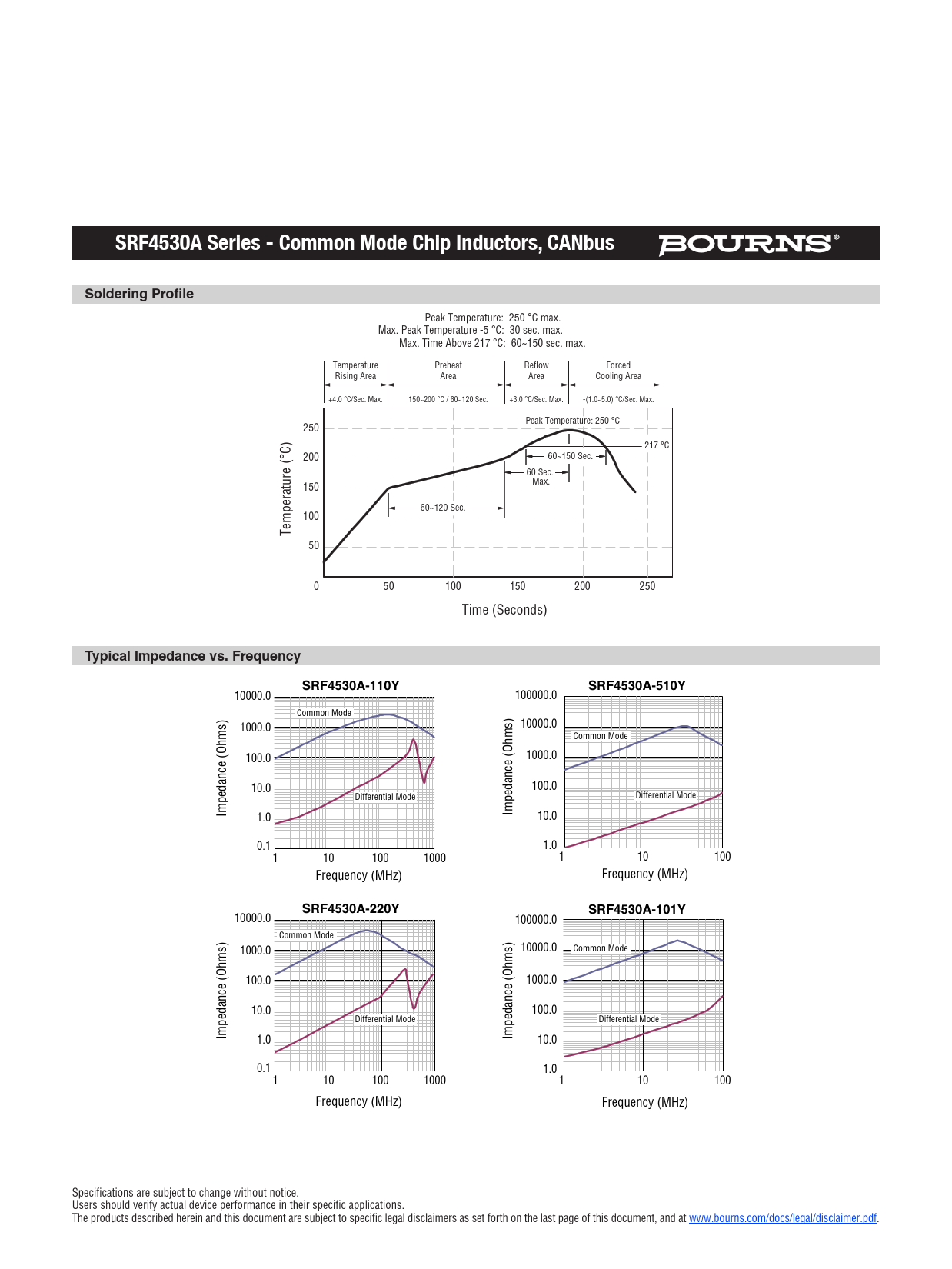

SRF4530A Series - Common Mode Chip Inductors, CANbus. Soldering Profile. Typical Impedance vs. Frequency. SRF4530A-110Y
SRF4530A Series - Common Mode Chip Inductors, CANbus Soldering Profile Typical Impedance vs Frequency SRF4530A-110Y
Peak Temperature: 250 °C max. Max. Peak Temperature -5 °C: 30 sec. max. Max. Time Above 217 °C: 60~150 sec. max. Temperature Preheat Reflow Forced Rising Area Area Area Cooling Area +4.0 °C/Sec. Max. 150~200 °C / 60~120 Sec. +3.0 °C/Sec. Max. -(1.0~5.0) °C/Sec. Max. Peak Temperature: 250 °C 250 217 °C 200 60~150 Sec. 60 Sec. 150 Max. 60~120 Sec. 100 Temperature (°C) 50 0 50 100 150 200 250 Time (Seconds)
Typical Impedance vs. Frequency SRF4530A-110Y SRF4530A-510Y
10000.0 100000.0 Common Mode 1000.0 10000.0 Common Mode 100.0 1000.0 10.0 100.0 Differential Mode Differential Mode Impedance (Ohms) Impedance (Ohms) 1.0 10.0 0.1 1.0 1 10 100 1000 1 10 100 Frequency (MHz) Frequency (MHz)
SRF4530A-220Y SRF4530A-101Y
10000.0 100000.0 Common Mode 1000.0 10000.0 Common Mode 100.0 1000.0 10.0 100.0 Differential Mode Differential Mode Impedance (Ohms) 1.0 Impedance (Ohms) 10.0 0.1 1.0 1 10 100 1000 1 10 100 Frequency (MHz) Frequency (MHz) Specifications are subject to change without notice. Users should verify actual device performance in their specific applications.
60.0 70.0 The products described herein and this document are subject to specific legal disclaimers as set forth on the last page of this document, and at www.bourns.com/docs/legal/disclaimer.pdf. ΔT @ 25 °C ΔT @ 25 °C 50.0 60.0 50.0 40.0 40.0 T (°C) 30.0 T (°C) Δ Δ 30.0 20.0 20.0 10.0 10.0 0.0 0.0 0.0 0.2 0.4 0.6 0.8 1.0 0.0 0.1 0.2 0.3 0.4 0.5 0.6 0.7 IDC (A) IDC (A)
60.0 60.0 ΔT @ 25 °C ΔT @ 25 °C 50.0 50.0 40.0 40.0 T (°C) 30.0 T (°C) 30.0 Δ Δ 20.0 20.0 10.0 10.0 0.0 0.0 0.0 0.2 0.4 0.6 0.8 0.0 0.1 0.2 0.3 0.4 0.5 IDC (A) IDC (A)
