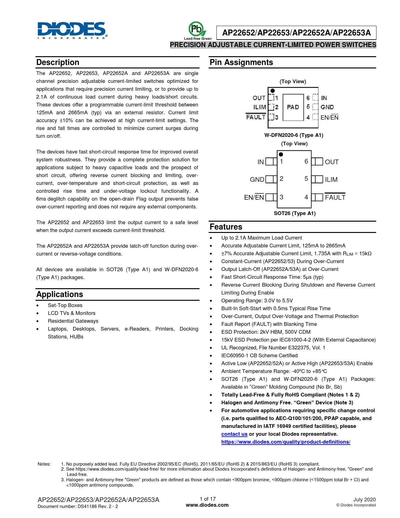

AP22652/AP22653/AP22652A/AP22653A. PRECISION ADJUSTABLE CURRENT-LIMITED POWER SWITCHES. Description. Pin Assignments
Datasheet AP22652, AP22653, AP22652A, AP22653A Diodes
AP22652/AP22653/AP22652A/AP22653A PRECISION ADJUSTABLE CURRENT-LIMITED POWER SWITCHES Description Pin Assignments
The AP22652, AP22653, AP22652A and AP22653A are single channel precision adjustable current-limited switches optimized for
(Top View)
applications that require precision current limiting, or to provide up to 2.1A of continuous load current during heavy loads/short circuits. These devices offer a programmable current-limit threshold between 125mA and 2665mA (typ) via an external resistor. Current limit EN/EN accuracy ±10% can be achieved at high current-limit settings. The rise and fall times are controlled to minimize current surges during turn on/off.
W-DFN2020-6 (Type A1) (Top View)
The devices have fast short-circuit response time for improved overall system robustness. They provide a complete protection solution for IN 1 6 OUT applications subject to heavy capacitive loads and the prospect of short circuit, offering reverse current blocking and limiting, over- GND 2 5 ILIM current, over-temperature and short-circuit protection, as well as controlled rise time and under-voltage lockout functionality. A 6ms deglitch capability on the open-drain Flag output prevents false EN/EN EN 3 4 FAULT over-current reporting and does not require any external components.
SOT26 (Type A1)
The AP22652 and AP22653 limit the output current to a safe level
Features
when the output current exceeds current-limit threshold. Up to 2.1A Maximum Load Current The AP22652A and AP22653A provide latch-off function during over- Accurate Adjustable Current Limit, 125mA to 2665mA current or reverse-voltage conditions. ±7% Accurate Adjustable Current Limit, 1.735A with RLIM = 15kΩ Constant-Current (AP22652/53) During Over-Current All devices are available in SOT26 (Type A1) and W-DFN2020-6 Output Latch-Off (AP22652A/53A) at Over-Current (Type A1) packages. Fast Short-Circuit Response Time: 5µs (typ) Reverse Current Blocking During Shutdown and Reverse Current
Applications
Limiting During Enable Operating Range: 3.0V to 5.5V Set-Top Boxes Built-In Soft-Start with 0.5ms Typical Rise Time LCD TVs & Monitors Over-Current, Output Over-Voltage and Thermal Protection Residential Gateways Fault Report (FAULT) with Blanking Time Laptops, Desktops, Servers, e-Readers, Printers, Docking ESD Protection: 2kV HBM, 500V CDM Stations, HUBs 15kV ESD Protection per IEC61000-4-2 (With External Capacitance) UL Recognized, File Number E322375, Vol. 1 IEC60950-1 CB Scheme Certified Active Low (AP22652/52A) or Active High (AP22653/53A) Enable Ambient Temperature Range: -40ºC to +85°C SOT26 (Type A1) and W-DFN2020-6 (Type A1) Packages: Available in “Green” Molding Compound (No Br, Sb)
Totally Lead-Free & Fully RoHS Compliant (Notes 1 & 2) Halogen and Antimony Free. “Green” Device (Note 3) For automotive applications requiring specific change control (i.e. parts qualified to AEC-Q100/101/200, PPAP capable, and manufactured in IATF 16949 certified facilities), please contact us or your local Diodes representative. https://www.diodes.com/quality/product-definitions/
Notes: 1. No purposely added lead. Fully EU Directive 2002/95/EC (RoHS), 2011/65/EU (RoHS 2) & 2015/863/EU (RoHS 3) compliant. 2. See https://www.diodes.com/quality/lead-free/ for more information about Diodes Incorporated’s definitions of Halogen- and Antimony-free, "Green" and Lead-free. 3. Halogen- and Antimony-free "Green” products are defined as those which contain <900ppm bromine, <900ppm chlorine (<1500ppm total Br + Cl) and <1000ppm antimony compounds.
AP22652/AP22653/AP22652A/AP22653A 1 of 17 July 2020 Document number: DS41186 Rev. 2 - 2
