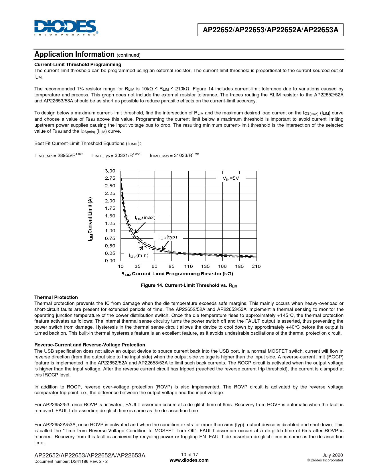

Current-Limit Threshold Programming
The current-limit threshold can be programmed using an external resistor. The current-limit threshold is proportional to the current sourced out of ILIM. The recommended 1% resistor range for RLIM is 10kΩ ≤ RLIM ≤ 210kΩ. Figure 14 includes current-limit tolerance due to variations caused by temperature and process. This graph does not include the external resistor tolerance. The traces routing the RLIM resistor to the AP22652/52A and AP22653/53A should be as short as possible to reduce parasitic effects on the current-limit accuracy. To design below a maximum current-limit threshold, find the intersection of RLIM and the maximum desired load current on the IOS(max) (ILIM) curve and choose a value of RLIM above this value. Programming the current limit below a maximum threshold is important to avoid current limiting upstream power supplies causing the input voltage bus to drop. The resulting minimum current-limit threshold is the intersection of the selected value of RLIM and the IOS(min) (ILIM) curve. Best Fit Current-Limit Threshold Equations (ILIMIT): ILIMIT_Min = 28955/R1.075 ILIMIT_Typ = 30321/R1.055 ILIMIT_Max = 31033/R1.031
Figure 14. Current-Limit Threshold vs. RLIM Thermal Protection
