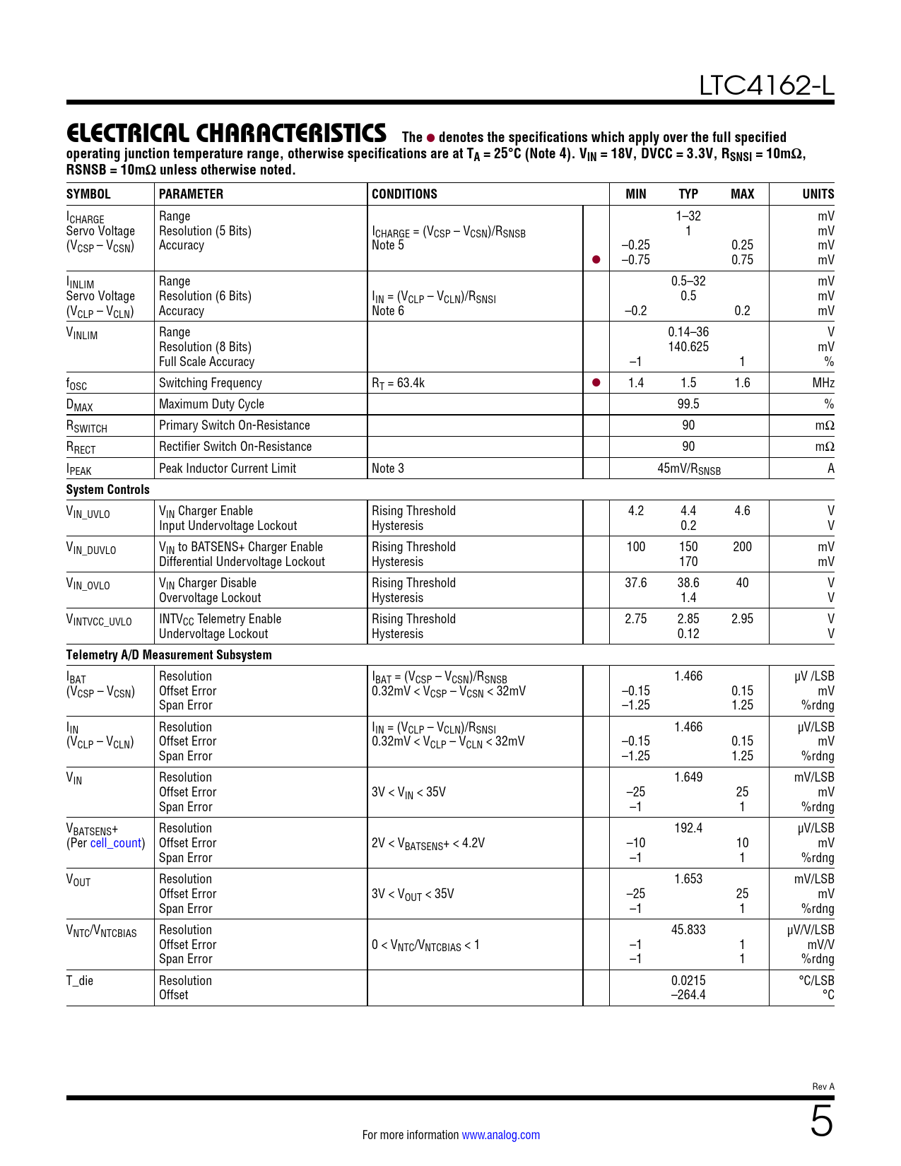

ELECTRICAL CHARACTERISTICS. The. denotes the specifications which apply over the full specified
link to page 46 LTC4162-L
l
denotes the specifications which apply over the full specified operating junction temperature range, otherwise specifications are at TA = 25°C (Note 4). VIN = 18V, DVCC = 3.3V, RSNSI = 10mΩ, RSNSB = 10mΩ unless otherwise noted. SYMBOL PARAMETER CONDITIONS MIN TYP MAX UNITS
ICHARGE Range 1–32 mV Servo Voltage Resolution (5 Bits) ICHARGE = (VCSP – VCSN)/RSNSB 1 mV (VCSP – VCSN) Accuracy Note 5 –0.25 0.25 mV l –0.75 0.75 mV IINLIM Range 0.5–32 mV Servo Voltage Resolution (6 Bits) IIN = (VCLP – VCLN)/RSNSI 0.5 mV (VCLP – VCLN) Accuracy Note 6 –0.2 0.2 mV VINLIM Range 0.14–36 V Resolution (8 Bits) 140.625 mV Full Scale Accuracy –1 1 % fOSC Switching Frequency RT = 63.4k l 1.4 1.5 1.6 MHz DMAX Maximum Duty Cycle 99.5 % RSWITCH Primary Switch On-Resistance 90 mΩ RRECT Rectifier Switch On-Resistance 90 mΩ IPEAK Peak Inductor Current Limit Note 3 45mV/RSNSB A
System Controls
VIN_UVLO VIN Charger Enable Rising Threshold 4.2 4.4 4.6 V Input Undervoltage Lockout Hysteresis 0.2 V VIN_DUVLO VIN to BATSENS+ Charger Enable Rising Threshold 100 150 200 mV Differential Undervoltage Lockout Hysteresis 170 mV VIN_OVLO VIN Charger Disable Rising Threshold 37.6 38.6 40 V Overvoltage Lockout Hysteresis 1.4 V VINTVCC_UVLO INTVCC Telemetry Enable Rising Threshold 2.75 2.85 2.95 V Undervoltage Lockout Hysteresis 0.12 V
