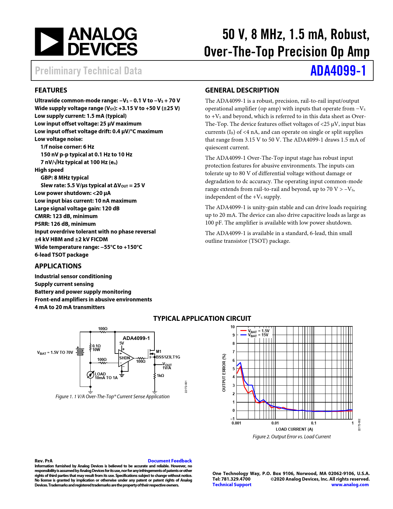

50 V, 8 MHz, 1.5 mA, Robust, Over-The-Top Precision Op Amp Preliminary Technical Data ADA4099-1 FEATURES GENERAL DESCRIPTION Ultrawide common-mode range: −VS – 0.1 V to −VS + 70 V
The ADA4099-1 is a robust, precision, rail-to-rail input/output
Wide supply voltage range (VSY): +3.15 V to +50 V (±25 V)
operational amplifier (op amp) with inputs that operate from −VS
Low supply current: 1.5 mA (typical)
to +VS and beyond, which is referred to in this data sheet as Over-
Low input offset voltage: 25 μV maximum
The-Top. The device features offset voltages of <25 μV, input bias
Low input offset voltage drift: 0.4 μV/°C maximum
currents (IB) of <4 nA, and can operate on single or split supplies
Low voltage noise:
that range from 3.15 V to 50 V. The ADA4099-1 draws 1.5 mA of
1/f noise corner: 6 Hz
quiescent current.
150 nV p-p typical at 0.1 Hz to 10 Hz
The ADA4099-1 Over-The-Top input stage has robust input
7 nV/√Hz typical at 100 Hz (en)
protection features for abusive environments. The inputs can
High speed
tolerate up to 80 V of differential voltage without damage or
GBP: 8 MHz typical
degradation to dc accuracy. The operating input common-mode
Slew rate: 5.5 V/μs typical at ΔVOUT = 25 V
range extends from rail-to-rail and beyond, up to 70 V > –VS,
Low power shutdown: <20 μA
independent of the +VS supply.
Low input bias current: 10 nA maximum Large signal voltage gain: 120 dB
The ADA4099-1 is unity-gain stable and can drive loads requiring
CMRR: 123 dB, minimum
up to 20 mA. The device can also drive capacitive loads as large as
PSRR: 126 dB, minimum
100 pF. The amplifier is available with low power shutdown.
Input overdrive tolerant with no phase reversal
The ADA4099-1 is available in a standard, 6-lead, thin small
±4 kV HBM and ±2 kV FICDM
outline transistor (TSOT) package.
Wide temperature range: −55°C to +150°C 6-lead TSOT package APPLICATIONS Industrial sensor conditioning Supply current sensing Battery and power supply monitoring Front-end amplifiers in abusive environments 4 mA to 20 mA transmitters TYPICAL APPLICATION CIRCUIT 100Ω 10 VBAT = 1.5V 9 V ADA4099-1 BAT = 15V 5V 8 0.1Ω 10W V M1 BAT = 1.5V TO 70V 7 ) BSS123LT1G 100Ω SHDN (% 100Ω 6 V R OUT 1V/A 5 RRO LOAD 1kΩ E 10mA TO 1A 4 UT P
001
3 UT
172-
O
22
2
Figure 1. 1 V/A Over-The-Top® Current Sense Application
1 0 –1 0.001 0.01 0.1 1
002 2-
LOAD CURRENT (A)
2217 Figure 2. Output Error vs. Load Current
