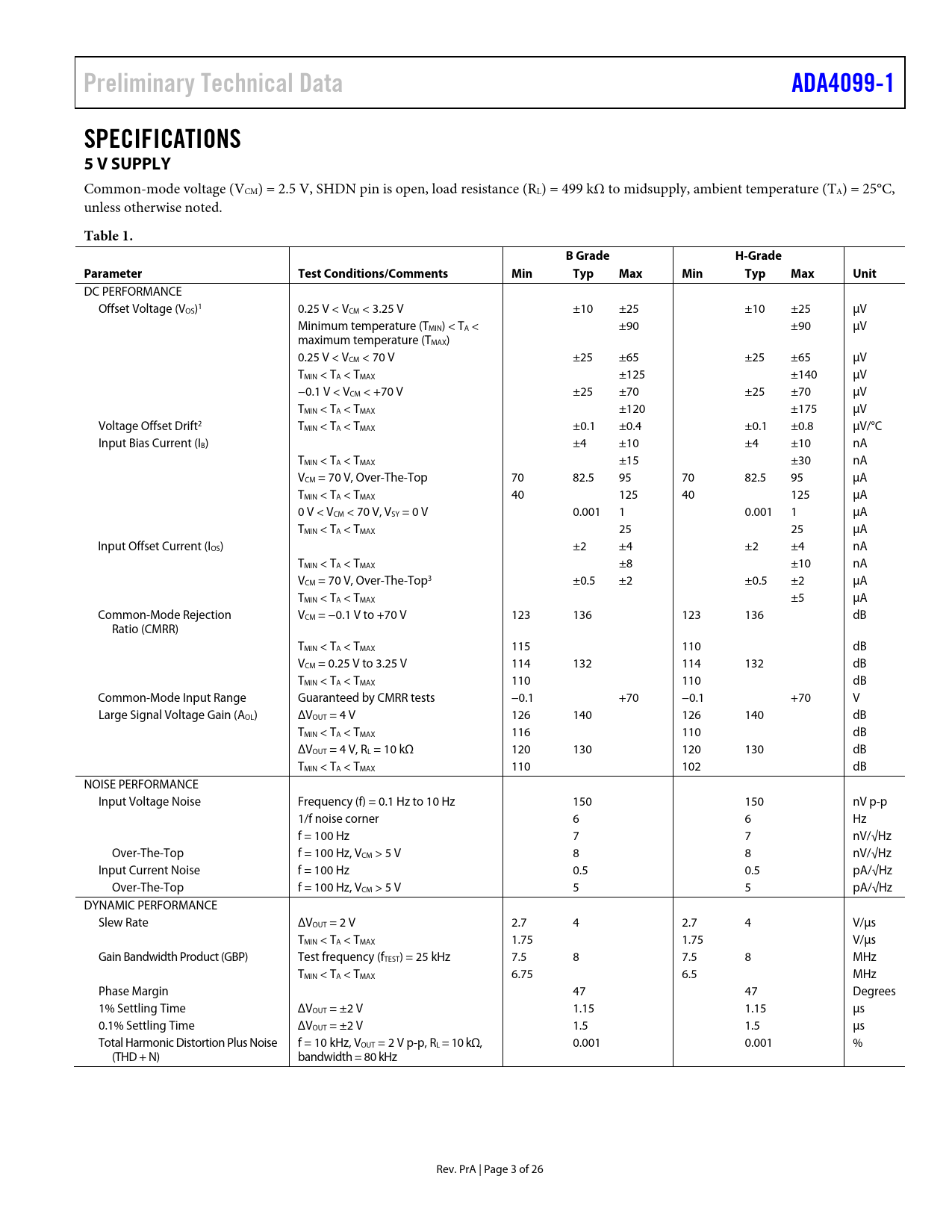

Preliminary Technical Data. ADA4099-1. SPECIFICATIONS 5 V SUPPLY. Table 1. B Grade. H-Grade. Parameter Test. Conditions/Comments. Min
Preliminary Technical Data ADA4099-1 SPECIFICATIONS 5 V SUPPLY Table 1 B Grade H-Grade Parameter Test Conditions/Comments Min
link to page 4 link to page 4 link to page 4
Common-mode voltage (VCM) = 2.5 V, SHDN pin is open, load resistance (RL) = 499 kΩ to midsupply, ambient temperature (TA) = 25°C, unless otherwise noted.
Table 1. B Grade H-Grade Parameter Test Conditions/Comments Min Typ Max Min Typ Max Unit
DC PERFORMANCE Offset Voltage (VOS)1 0.25 V < VCM < 3.25 V ±10 ±25 ±10 ±25 μV Minimum temperature (TMIN) < TA < ±90 ±90 μV maximum temperature (TMAX) 0.25 V < VCM < 70 V ±25 ±65 ±25 ±65 μV TMIN < TA < TMAX ±125 ±140 μV −0.1 V < VCM < +70 V ±25 ±70 ±25 ±70 μV TMIN < TA < TMAX ±120 ±175 μV Voltage Offset Drift2 TMIN < TA < TMAX ±0.1 ±0.4 ±0.1 ±0.8 μV/°C Input Bias Current (IB) ±4 ±10 ±4 ±10 nA TMIN < TA < TMAX ±15 ±30 nA VCM = 70 V, Over-The-Top 70 82.5 95 70 82.5 95 μA TMIN < TA < TMAX 40 125 40 125 μA 0 V < VCM < 70 V, VSY = 0 V 0.001 1 0.001 1 μA TMIN < TA < TMAX 25 25 μA Input Offset Current (IOS) ±2 ±4 ±2 ±4 nA TMIN < TA < TMAX ±8 ±10 nA VCM = 70 V, Over-The-Top3 ±0.5 ±2 ±0.5 ±2 μA TMIN < TA < TMAX ±5 μA Common-Mode Rejection VCM = −0.1 V to +70 V 123 136 123 136 dB Ratio (CMRR) TMIN < TA < TMAX 115 110 dB VCM = 0.25 V to 3.25 V 114 132 114 132 dB TMIN < TA < TMAX 110 110 dB Common-Mode Input Range Guaranteed by CMRR tests −0.1 +70 −0.1 +70 V Large Signal Voltage Gain (AOL) ΔVOUT = 4 V 126 140 126 140 dB TMIN < TA < TMAX 116 110 dB ΔVOUT = 4 V, RL = 10 kΩ 120 130 120 130 dB TMIN < TA < TMAX 110 102 dB NOISE PERFORMANCE Input Voltage Noise Frequency (f) = 0.1 Hz to 10 Hz 150 150 nV p-p 1/f noise corner 6 6 Hz f = 100 Hz 7 7 nV/√Hz Over-The-Top f = 100 Hz, VCM > 5 V 8 8 nV/√Hz Input Current Noise f = 100 Hz 0.5 0.5 pA/√Hz Over-The-Top f = 100 Hz, VCM > 5 V 5 5 pA/√Hz DYNAMIC PERFORMANCE Slew Rate ΔVOUT = 2 V 2.7 4 2.7 4 V/μs TMIN < TA < TMAX 1.75 1.75 V/μs Gain Bandwidth Product (GBP) Test frequency (fTEST) = 25 kHz 7.5 8 7.5 8 MHz TMIN < TA < TMAX 6.75 6.5 MHz Phase Margin 47 47 Degrees 1% Settling Time ΔVOUT = ±2 V 1.15 1.15 μs 0.1% Settling Time ΔVOUT = ±2 V 1.5 1.5 μs Total Harmonic Distortion Plus Noise f = 10 kHz, VOUT = 2 V p-p, RL = 10 kΩ, 0.001 0.001 % (THD + N) bandwidth = 80 kHz Rev. PrA | Page 3 of 26 Document Outline FEATURES APPLICATIONS GENERAL DESCRIPTION TYPICAL APPLICATION CIRCUIT TABLE OF CONTENTS SPECIFICATIONS 5 V SUPPLY ±15 V SUPPLY ABSOLUTE MAXIMUM RATINGS MAXIMUM POWER DISSIPATION THERMAL RESISTANCE ESD CAUTION PIN CONFIGURATION AND FUNCTION DESCRIPTIONS TYPICAL PERFORMANCE CHARACTERISTICS THEORY OF OPERATION INPUT PROTECTION OVER-THE-TOP OPERATION CONSIDERATIONS OUTPUT SHUTDOWN PIN (SHDN) APPLICATIONS INFORMATION LARGE RESISTOR GAIN OPERATION RECOMMENDED VALUES FOR VARIOUS GAINS NOISE DISTORTION POWER DISSIPATION AND THERMAL SHUTDOWN CIRCUIT LAYOUT CONSIDERATIONS POWER SUPPLY BYPASSING GROUNDING ESD PROTECTION WHEN POWERED RELATED PRODUCTS TYPICAL APPLICATIONS OUTLINE DIMENSIONS
