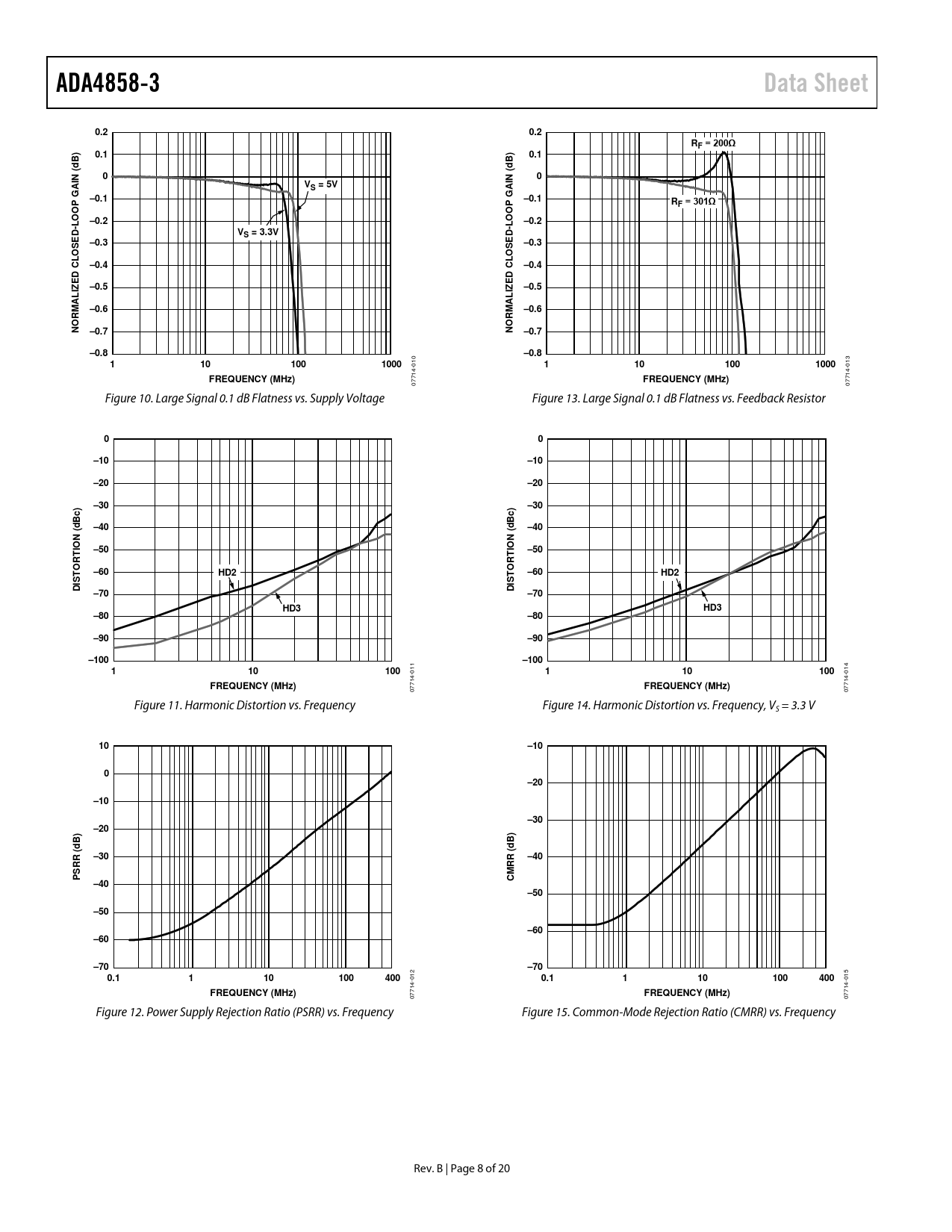

ADA4858-3. Data Sheet. 0.2. RF = 200Ω. 0.1. VS = 5V. –0.1. RF = 301Ω. –0.2. -LOOP. VS = 3.3V. –0.3. LOS. –0.4. –0.5. LIZE. –0.6. –0.7. –0.8. 100. 1000
ADA4858-3 Data Sheet 0.2 RF = 200Ω 0.1 VS = 5V –0.1 RF = 301Ω –0.2 -LOOP VS = 3.3V –0.3 LOS –0.4 –0.5 LIZE –0.6 –0.7 –0.8 100 1000
ADA4858-3 Data Sheet 0.2 0.2 RF = 200Ω ) 0.1 ) 0.1 dB dB ( ( 0 IN 0 IN VS = 5V GA –0.1 GA –0.1 RF = 301Ω –0.2 –0.2 -LOOP -LOOP D VS = 3.3V D E –0.3 E –0.3 LOS LOS –0.4 C –0.4 C D D –0.5 –0.5 LIZE LIZE A A M –0.6 M –0.6 OR OR N –0.7 N –0.7 –0.8 –0.8 1 10 100 1000

07714- Figure 10. Large Signal 0.1 dB Flatness vs. Supply Voltage Figure 13. Large Signal 0.1 dB Flatness vs. Feedback Resistor

07714- 07714- Figure 11. Harmonic Distortion vs. Frequency Figure 14. Harmonic Distortion vs. Frequency, VS = 3.3 V

07714- 07714- Figure 12. Power Supply Rejection Ratio (PSRR) vs. Frequency Figure 15. Common-Mode Rejection Ratio (CMRR) vs. Frequency Rev. B | Page 8 of 20 Document Outline Features Applications General Description Connection Diagram Table of Contents Revision History Specifications Absolute Maximum Ratings Maximum Power Dissipation ESD Caution Pin Configuration and Function Descriptions Typical Performance Characteristics Theory of Operation Overview Charge Pump Operation Applications Information Gain Configurations DC-Coupled Video Signal Multiple Video Driver DC Restore Function Clamp Amplifier PD (Power-Down) Pin Power Supply Bypassing Layout Outline Dimensions Ordering Guide
