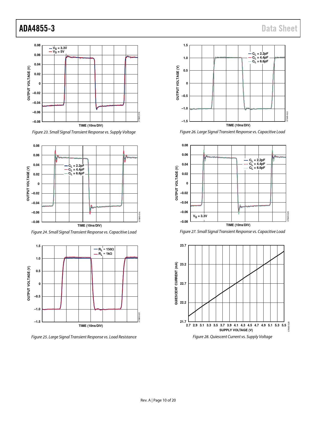

ADA4855-3. Data Sheet. 0.08. 1.5. VS = 3.3V. VS = 5V. 0.06. CL = 2.2pF. 1.0. CL = 4.4pF CL = 6.6pF. 0.04. 0.5. 0.02. OLTA. T V. –0.02. TP –0.5. –0.04. –1.0
ADA4855-3 Data Sheet 0.08 1.5 VS = 3.3V VS = 5V 0.06 CL = 2.2pF 1.0 CL = 4.4pF CL = 6.6pF 0.04 0.5 0.02 OLTA T V –0.02 TP –0.5 –0.04 –1.0
ADA4855-3 Data Sheet 0.08 1.5 VS = 3.3V VS = 5V 0.06 CL = 2.2pF 1.0 CL = 4.4pF CL = 6.6pF 0.04 ) ) V V ( ( 0.5 GE 0.02 GE OLTA 0 OLTA 0 T V T V U U –0.02 TP TP –0.5 OU OU –0.04 –1.0 –0.06

Figure 23. Small Signal Transient Response vs. Supply Voltage Figure 26. Large Signal Transient Response vs. Capacitive Load

Figure 24. Small Signal Transient Response vs. Capacitive Load Figure 27. Small Signal Transient Response vs. Capacitive Load
1.5 23.7 RL = 150Ω RL = 1kΩ 1.0 23.2 ) V mA) ( ( 0.5 NT GE OLTA 0 22.7 CURRE T V U NT TP CE –0.5 S E OU UI 22.2 Q –1.0

TIME (10ns/DIV) 2.7 2.9 3.1 3.3 3.5 3.7 3.9 4.1 4.3 4.5 4.7 4.9 5.1 5.3 5.5 SUPPLY VOLTAGE (V)
07685- Figure 25. Large Signal Transient Response vs. Load Resistance Figure 28. Quiescent Current vs. Supply Voltage Rev. A | Page 10 of 20 Document Outline Features Applications Connection Diagram General Description Revision History Specifications 5 V Operation 3.3 V Operation Absolute Maximum Ratings Thermal Resistance Maximum Power Dissipation ESD Caution Pin Configuration and Function Descriptions Typical Performance Characteristics Test Circuits Theory of Operation Applications Information Gain Configurations 20 MHz Active Low-Pass Filter RGB Video Driver Driving Multiple Video Loads PD (Power-Down) Pin Single-Supply Operation Power Supply Bypassing Layout Outline Dimensions Ordering Guide
