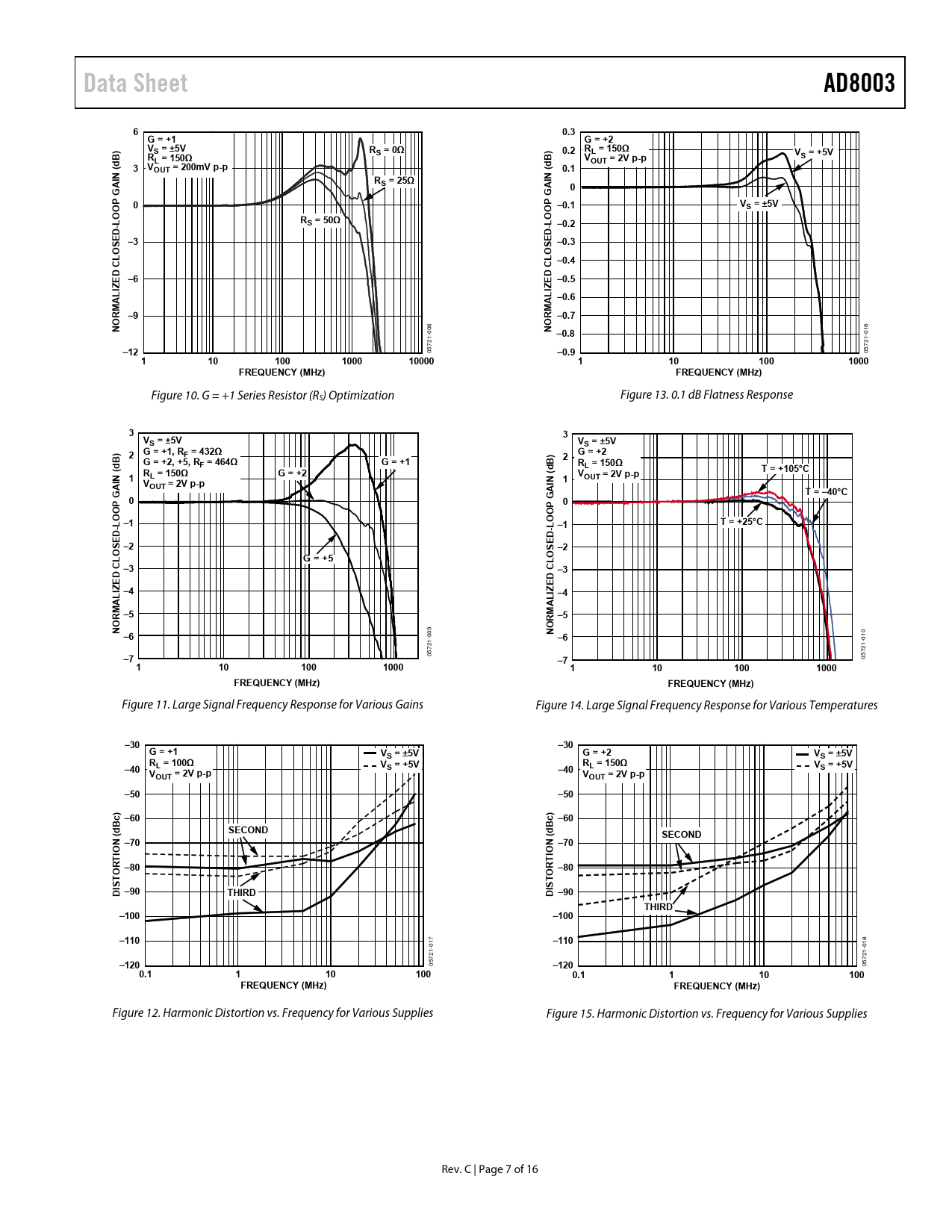

Data Sheet. AD8003. 0.3. G = +1. G = +2. S = ±5V. 0.2 RL = 150Ω. S = 0Ω. VS = +5V. L = 150Ω. OUT = 2V p-p. 3 VOUT = 200mV p-p. 0.1. N (. RS = 25Ω
Data Sheet AD8003 6 0.3 G = +1 G = +2 V ) S = ±5V R ) 0.2 RL = 150Ω B R S = 0Ω VS = +5V L = 150Ω B V d OUT = 2V p-p d 3 VOUT = 200mV p-p 0.1 N ( N ( AI RS = 25Ω AI 0 G G P 0 P O –0.1 O VS = ±5V O O -L RS = 50Ω -L –0.2 D D E E S –3 S –0.3 O O L L –0.4 C C D D E –6 E –0.5 IZ IZ AL –0.6 AL RM –9 RM –0.7
06
NO
16
NO
0 0
–0.8
1- 1- 72 72 05
–12
05
–0.9 1 10 100 1000 10000 1 10 100 1000 FREQUENCY (MHz) FREQUENCY (MHz)
Figure 10. G = +1 Series Resistor (RS) Optimization Figure 13. 0.1 dB Flatness Response
3 3 VS = ±5V VS = ±5V ) 2 G = +1, RF = 432Ω ) G = +2 B 2 d G = +2, +5, RF = 464Ω G = +1 B RL = 150Ω ( d R ( T = +105°C 1 G = +2 V IN L = 150Ω 1 OUT = 2V p-p IN A VOUT = 2V p-p A T = –40°C 0 P G 0 P G O O O –1 O -L –1 T = +25°C -L D E D S E –2 S –2 O G = +5 O CL –3 CL D –3 E D E IZ –4 IZ –4 AL AL –5 RM –5 RM NO
09 0
NO
0
–6 –6
01 1- 1- 72 72 05
–7
05
–7 1 10 100 1000 1 10 100 1000 FREQUENCY (MHz) FREQUENCY (MHz)
Figure 11. Large Signal Frequency Response for Various Gains Figure 14. Large Signal Frequency Response for Various Temperatures
–30 –30 G = +1 VS = ±5V G = +2 VS = ±5V RL = 100Ω V R –40 S = +5V L = 150Ω VS = +5V V –40 OUT = 2V p-p VOUT = 2V p-p –50 –50 c) –60 c) –60 B B d d ( SECOND ( SECOND –70 –70 ION ION T T –80 OR –80 OR T T IS IS D –90 THIRD D –90 THIRD –100 –100 –110
17
–110
18 0 0 1- 1- 572 572 0
–120
0
–120 0.1 1 10 100 0.1 1 10 100 FREQUENCY (MHz) FREQUENCY (MHz)
Figure 12. Harmonic Distortion vs. Frequency for Various Supplies Figure 15. Harmonic Distortion vs. Frequency for Various Supplies Rev. C | Page 7 of 16 Document Outline Features Applications Connection Diagram General Description Table of Contents Revision History Specifications with ±5 V Supply Specifications with +5 V Supply Absolute Maximum Ratings Thermal Resistance Maximum Power Dissipation ESD Caution Typical Performance Characteristics Applications Information Gain Configurations RGB Video Driver Printed Circuit Board Layout Low Distortion Pinout Signal Routing Exposed Paddle Power Supply Bypassing Grounding Outline Dimensions Ordering Guide
