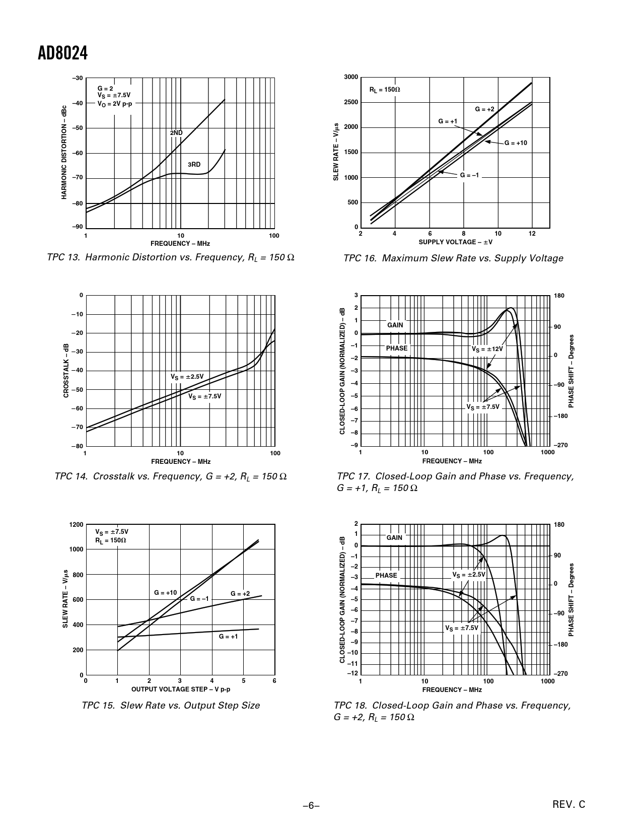

AD8024. –30. 3000. G = 2. RL = 150. VS =. 7.5V. –40. 2500. O = 2V p-p. G = +2. dBc –. G = +1. –50. 2000. 2ND. V/ –. G = +10. –60. 1500. 3RD. –70. G = –1. SLEW RATE
AD8024 –30 3000 G = 2 RL = 150 VS = 7.5V –40 V 2500 O = 2V p-p G = +2 dBc – G = +1 s –50 2000 2ND V/ – G = +10 –60 1500 3RD –70 G = –1 SLEW RATE 1000 HARMONIC DISTORTION –80 500 –90 0 1 10 100 2 4 6 8 10 12 FREQUENCY – MHz SUPPLY VOLTAGE – V
TPC 13. Harmonic Distortion vs. Frequency, RL = 150 Ω TPC 16. Maximum Slew Rate vs. Supply Voltage
0 3 180 2 10 dB – 1 GAIN 90 20 0 –1 rees PHASE dB 30 V g S = 12V – 0 –2 De – 40 –3 VS = 2.5V –4 –90 50 CROSSTALK VS = 7.5V –5 PHASE SHIFT 60 V –6 S = 7.5V –180 –7 70 CLOSED-LOOP GAIN (NORMALIZED) –8 80 –9 –270 1 10 100 1 10 100 1000 FREQUENCY – MHz FREQUENCY – MHz
TPC 14. Crosstalk vs. Frequency, G = +2, RL = 150 Ω TPC 17. Closed-Loop Gain and Phase vs. Frequency, G = +1, RL = 150 Ω
1200 2 180 VS = 7.5V 1 R GAIN L = 150 dB 0 1000 – –1 90 –2 s 800 rees –3 PHASE VS = 2.5V g V/ 0 – –4 De G = +10 G = +2 – 600 G = –1 –5 –6 –90 –7 SLEW RATE 400 VS = 7.5V –8 G = +1 PHASE SHIFT –9 –180 200 –10 CLOSED-LOOP GAIN (NORMALIZED) –11 0 –12 –270 0 1 2 3 4 5 6 1 10 100 1000 OUTPUT VOLTAGE STEP – V p-p FREQUENCY – MHz
TPC 15. Slew Rate vs. Output Step Size TPC 18. Closed-Loop Gain and Phase vs. Frequency, G = +2, RL = 150 Ω –6– REV. C
