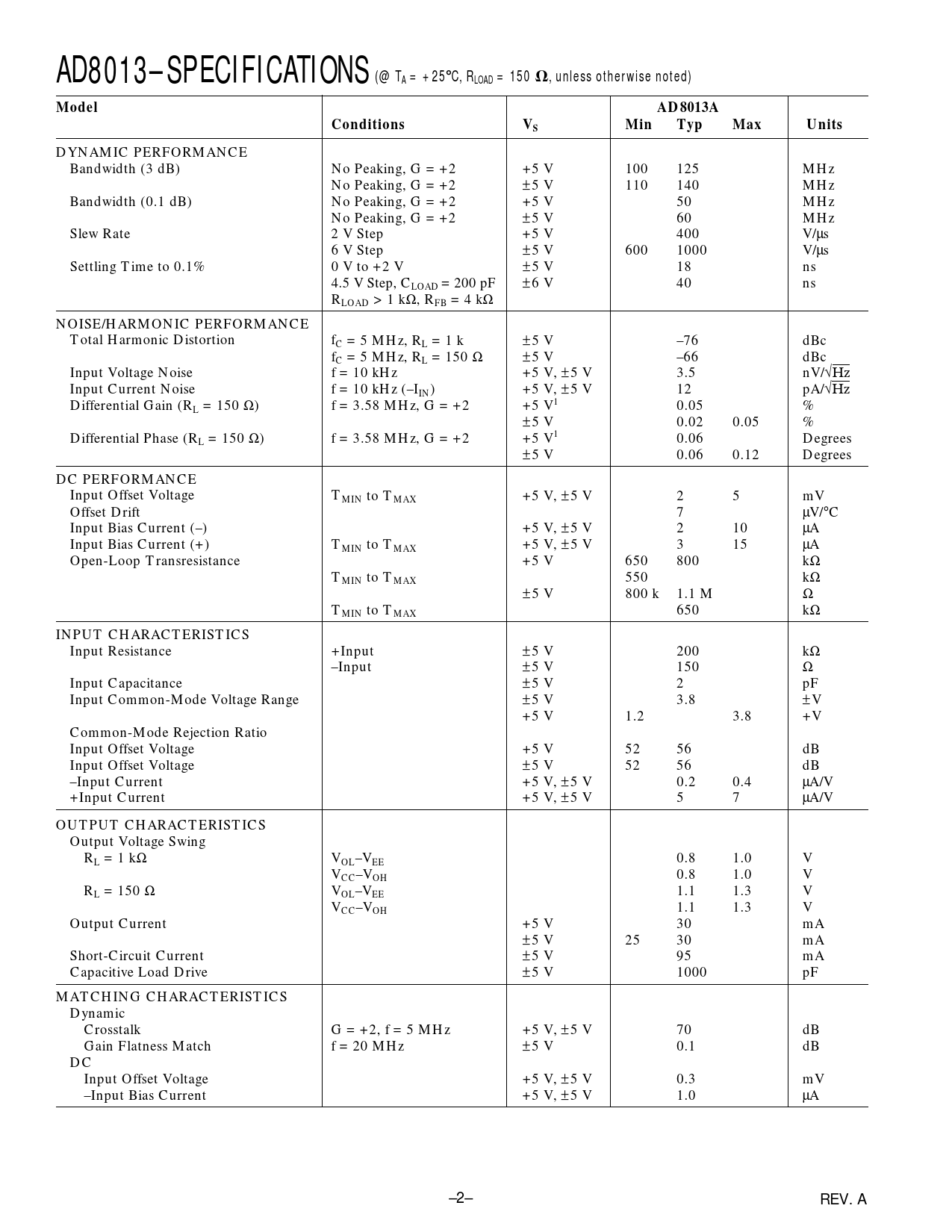

AD8013–SPECIFICATIONS (@ TA = +25. C, RLOAD = 150. , unless otherwise noted) Model. AD8013A. Conditions. Min. Typ. Max. Units
AD8013–SPECIFICATIONS (@ TA = +25 C, RLOAD = 150 , unless otherwise noted) Model AD8013A Conditions Min Typ Max Units
8
C, RLOAD = 150
V
, unless otherwise noted) Model AD8013A Conditions VS Min Typ Max Units
DYNAMIC PERFORMANCE Bandwidth (3 dB) No Peaking, G = +2 +5 V 100 125 MHz No Peaking, G = +2 ±5 V 110 140 MHz Bandwidth (0.1 dB) No Peaking, G = +2 +5 V 50 MHz No Peaking, G = +2 ±5 V 60 MHz Slew Rate 2 V Step +5 V 400 V/µs 6 V Step ±5 V 600 1000 V/µs Settling Time to 0.1% 0 V to +2 V ±5 V 18 ns 4.5 V Step, CLOAD = 200 pF ±6 V 40 ns RLOAD > 1 kΩ, RFB = 4 kΩ NOISE/HARMONIC PERFORMANCE Total Harmonic Distortion fC = 5 MHz, RL = 1 k ±5 V –76 dBc fC = 5 MHz, RL = 150 Ω ±5 V –66 dBc Input Voltage Noise f = 10 kHz +5 V, ± 5 V 3.5 nV/√Hz Input Current Noise f = 10 kHz (–IIN) +5 V, ± 5 V 12 pA/√Hz Differential Gain (RL = 150 Ω) f = 3.58 MHz, G = +2 +5 V1 0.05 % ±5 V 0.02 0.05 % Differential Phase (RL = 150 Ω) f = 3.58 MHz, G = +2 +5 V1 0.06 Degrees ±5 V 0.06 0.12 Degrees DC PERFORMANCE Input Offset Voltage TMIN to TMAX +5 V, ± 5 V 2 5 mV Offset Drift 7 µV/°C Input Bias Current (–) +5 V, ± 5 V 2 10 µA Input Bias Current (+) TMIN to TMAX +5 V, ± 5 V 3 15 µA Open-Loop Transresistance +5 V 650 800 kΩ TMIN to TMAX 550 kΩ ±5 V 800 k 1.1 M Ω TMIN to TMAX 650 kΩ INPUT CHARACTERISTICS Input Resistance +Input ±5 V 200 kΩ –Input ±5 V 150 Ω Input Capacitance ±5 V 2 pF Input Common-Mode Voltage Range ±5 V 3.8 ±V +5 V 1.2 3.8 +V Common-Mode Rejection Ratio Input Offset Voltage +5 V 52 56 dB Input Offset Voltage ±5 V 52 56 dB –Input Current +5 V, ± 5 V 0.2 0.4 µA/V +Input Current +5 V, ± 5 V 5 7 µA/V OUTPUT CHARACTERISTICS Output Voltage Swing RL = 1 kΩ VOL–VEE 0.8 1.0 V VCC–VOH 0.8 1.0 V RL = 150 Ω VOL–VEE 1.1 1.3 V VCC–VOH 1.1 1.3 V Output Current +5 V 30 mA ±5 V 25 30 mA Short-Circuit Current ±5 V 95 mA Capacitive Load Drive ±5 V 1000 pF MATCHING CHARACTERISTICS Dynamic Crosstalk G = +2, f = 5 MHz +5 V, ± 5 V 70 dB Gain Flatness Match f = 20 MHz ±5 V 0.1 dB DC Input Offset Voltage +5 V, ± 5 V 0.3 mV –Input Bias Current +5 V, ± 5 V 1.0 µA –2– REV. A
