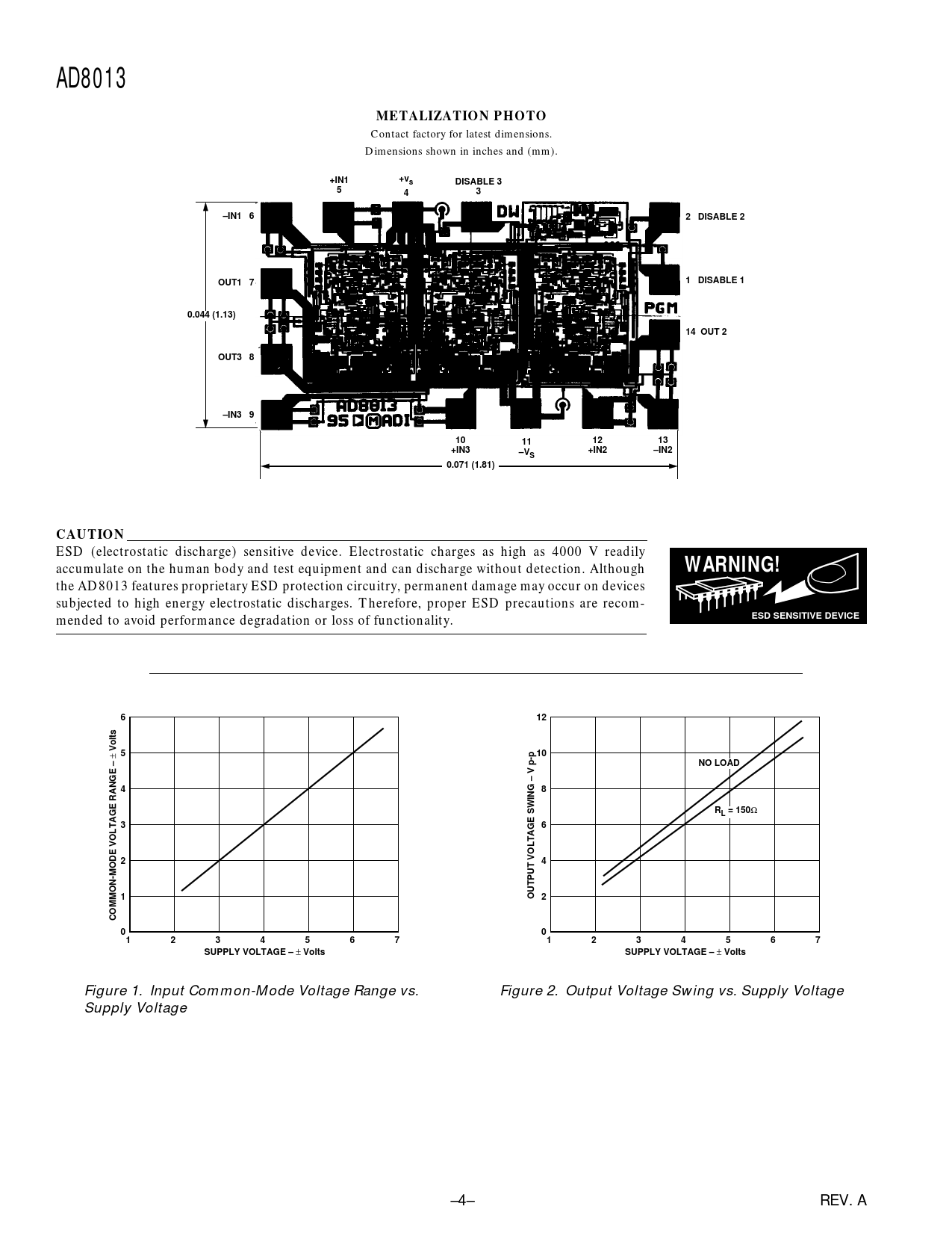

Pages / Page12 / 4 — AD8013. METALIZATION PHOTO. +IN1. +vs. DISABLE 3. –IN1 6. 2 DISABLE 2. 1 …
RevisionA
File Format / SizePDF / 327 Kb
AD8013. METALIZATION PHOTO. +IN1. +vs. DISABLE 3. –IN1 6. 2 DISABLE 2. 1 DISABLE 1. OUT1 7. 0.044 (1.13). 14 OUT 2. OUT3 8. –IN3 9. +IN3. +IN2. –IN2
AD8013 METALIZATION PHOTO +IN1 +vs DISABLE 3 –IN1 6 2 DISABLE 2 1 DISABLE 1 OUT1 7 0.044 (1.13) 14 OUT 2 OUT3 8 –IN3 9 +IN3 +IN2 –IN2
Contact factory for latest dimensions. Dimensions shown in inches and (mm).
+IN1 +vs DISABLE 3 5 4 3 –IN1 6 2 DISABLE 2 1 DISABLE 1 OUT1 7 0.044 (1.13) 14 OUT 2 OUT3 8 –IN3 9 10 11 12 13 +IN3 –V +IN2 –IN2 S 0.071 (1.81) CAUTION

Volts 5 10 NO LOAD 4 8 RL = 150
3 6 2 4 1 OUTPUT VOLTAGE SWING – V p-p 2 COMMON-MODE VOLTAGE RANGE – 0 0 1 2 3 4 5 6 7 1 2 3 4 5 6 7 SUPPLY VOLTAGE –
Volts SUPPLY VOLTAGE –
Volts
Figure 1. Input Common-Mode Voltage Range vs. Figure 2. Output Voltage Swing vs. Supply Voltage Supply Voltage –4– REV. A
