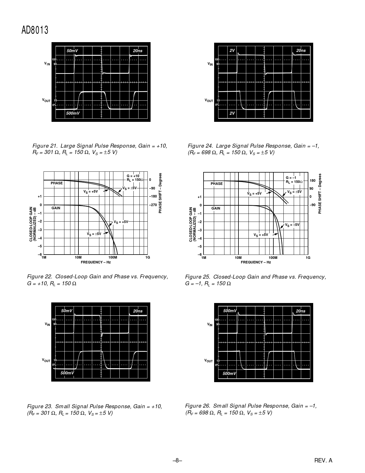

AD8013. 50mV. 20ns. 100. VIN 90. VOUT 10. OUT. 500mV. G = +10. G = –1. L = 150. 180. PHASE. RL = 150. –90. S =. VS = +5V. VS =. –180. –270. GAIN
AD8013 50mV 20ns 2V 20ns 100 100 VIN 90 V 90 IN VOUT 10 V 10 OUT 0% 0% 500mV 2V
Figure 21. Large Signal Pulse Response, Gain = +10, Figure 24. Large Signal Pulse Response, Gain = –1, RF = 301 Ω, RL = 150 Ω, VS = ±5 V) (RF = 698 Ω, RL = 150 Ω, VS = ±5 V)
G = +10 G = –1 R 0 L = 150
Ω
180 PHASE RL = 150
Ω
PHASE V –90 S =
5V 90 VS = +5V VS =
5V VS = +5V +1 –180 +1 0 0 –270 0 –90 GAIN GAIN –1 PHASE SHIFT – Degrees –1 PHASE SHIFT – Degrees –2 VS = +5V –2 VS =
5V –3 –3 VS =
5V VS = +5V –4 –4 CLOSED-LOOP GAIN (NORMALIZED) – dB CLOSED-LOOP GAIN (NORMALIZED) – dB –5 –5 –6 –6 1M 10M 100M 1G 1M 10M 100M 1G FREQUENCY – Hz FREQUENCY – Hz
Figure 22. Closed-Loop Gain and Phase vs. Frequency, Figure 25. Closed-Loop Gain and Phase vs. Frequency, G = +10, RL = 150 Ω G = –1, RL = 150 Ω
50mV 20ns 500mV 20ns 100 100 V 90 IN V 90 IN V 10 OUT V 10 OUT 0% 0% 500mV 500mV
Figure 23. Small Signal Pulse Response, Gain = +10, Figure 26. Small Signal Pulse Response, Gain = –1, (R (R F = 301 Ω, RL = 150 Ω, VS = ±5 V) F = 698 Ω, RL = 150 Ω, VS = ±5 V) –8– REV. A
