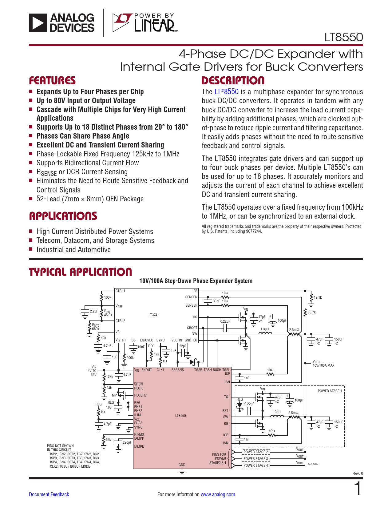

TYPICAL APPLICATION 10V/100A Step-Down Phase Expander System
CTRL1 FB 10Ω 100k SENSEN 12.1k 33nF 10Ω V SENSEP REF VIN 2.2µF RHOT 88.7k 45.3k LT3741 HG 47µF + CTRL2 0.22µF ×2 100µF RNTC CBOOT 680k 1.3µH VC 2.5mΩ SW 10k VIN RT SS EN/UVLO SYNC VCC_INT GND LG 47µF 150µF ×2 ×2 4.7nF 10nF REG 22µF 1nF 47k 1µF 200k 1Ω VOUT V 10V/100A MAX IN V 14V TO IN ENOUT CLK1 REGSNS TGSR TGSH BGSH TGSL 10Ω 36V 4.7µF ISP 137k 1nF ISN SHDN 24k REGIS VIN POWER STAGE 1 MP REGDRV TG1 47µF + REG 100µF ×2 REG REG REG 0.22µF 10µF PHS1 PHS2 BST1 1Ω 1.3µH ILIM 2.5mΩ LT8550 SW1 VCC 4.7µF PHS3 BG1 47µF 150µF ×2 ×2 SYNC 10Ω RT/MS ISP1 IAMPP 62k 1nF 220pF ISN1 PINS NOT SHOWN IAMPN V IN THIS CIRCUIT: POWER STAGE 2 OUT ISP2, ISN2, BST2, TG2, SW2, BG2 PINS FOR V ISP3, ISN3, BST3, TG3, SW3, BG3 POWER POWER STAGE 3 OUT ISP4, ISN4, BST4, TG4, SW4, BG4, STAGE2,3,4 V GND OUT 8550 TA01a POWER STAGE 4 CLK2, TGBUF, BGBUF, MODE Rev. 0 Document Feedback For more information www.analog.com 1
