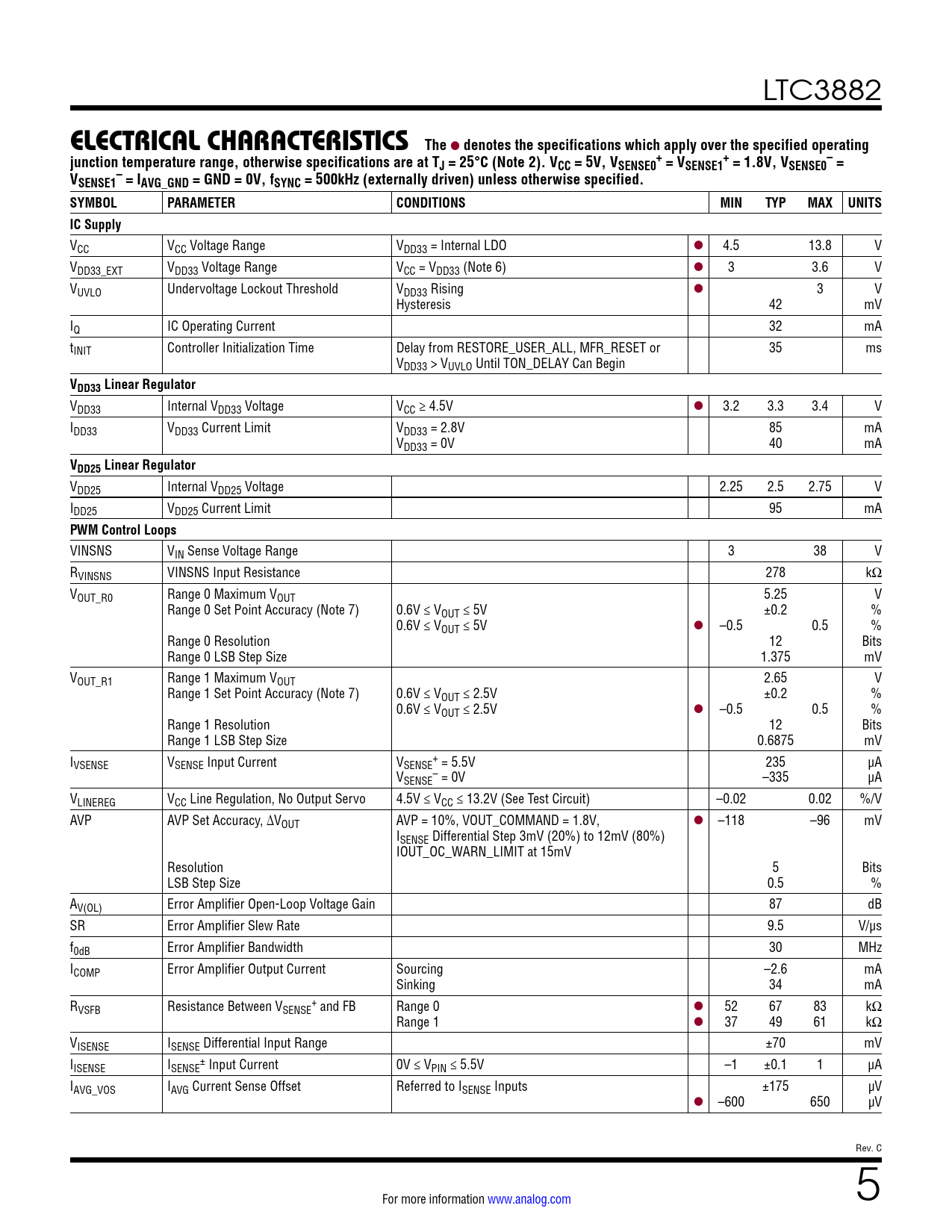

ELECTRICAL CHARACTERISTICS. The. denotes the specifications which apply over the specified operating
ELECTRICAL CHARACTERISTICS The denotes the specifications which apply over the specified operating
LTC3882
l
denotes the specifications which apply over the specified operating junction temperature range, otherwise specifications are at T + + J = 25°C (Note 2). VCC = 5V, VSENSE0 = VSENSE1 = 1.8V, VSENSE0 = V SENSE1 = IAVG_GND = GND = 0V, fSYNC = 500kHz (externally driven) unless otherwise specified. SYMBOL PARAMETER CONDITIONS MIN TYP MAX UNITS IC Supply
VCC VCC Voltage Range VDD33 = Internal LDO l 4.5 13.8 V VDD33_EXT VDD33 Voltage Range VCC = VDD33 (Note 6) l 3 3.6 V VUVLO Undervoltage Lockout Threshold VDD33 Rising l 3 V Hysteresis 42 mV IQ IC Operating Current 32 mA tINIT Controller Initialization Time Delay from RESTORE_USER_ALL, MFR_RESET or 35 ms VDD33 > VUVLO Until TON_DELAY Can Begin
VDD33 Linear Regulator
VDD33 Internal VDD33 Voltage VCC ≥ 4.5V l 3.2 3.3 3.4 V IDD33 VDD33 Current Limit VDD33 = 2.8V 85 mA VDD33 = 0V 40 mA
VDD25 Linear Regulator
VDD25 Internal VDD25 Voltage 2.25 2.5 2.75 V IDD25 VDD25 Current Limit 95 mA
