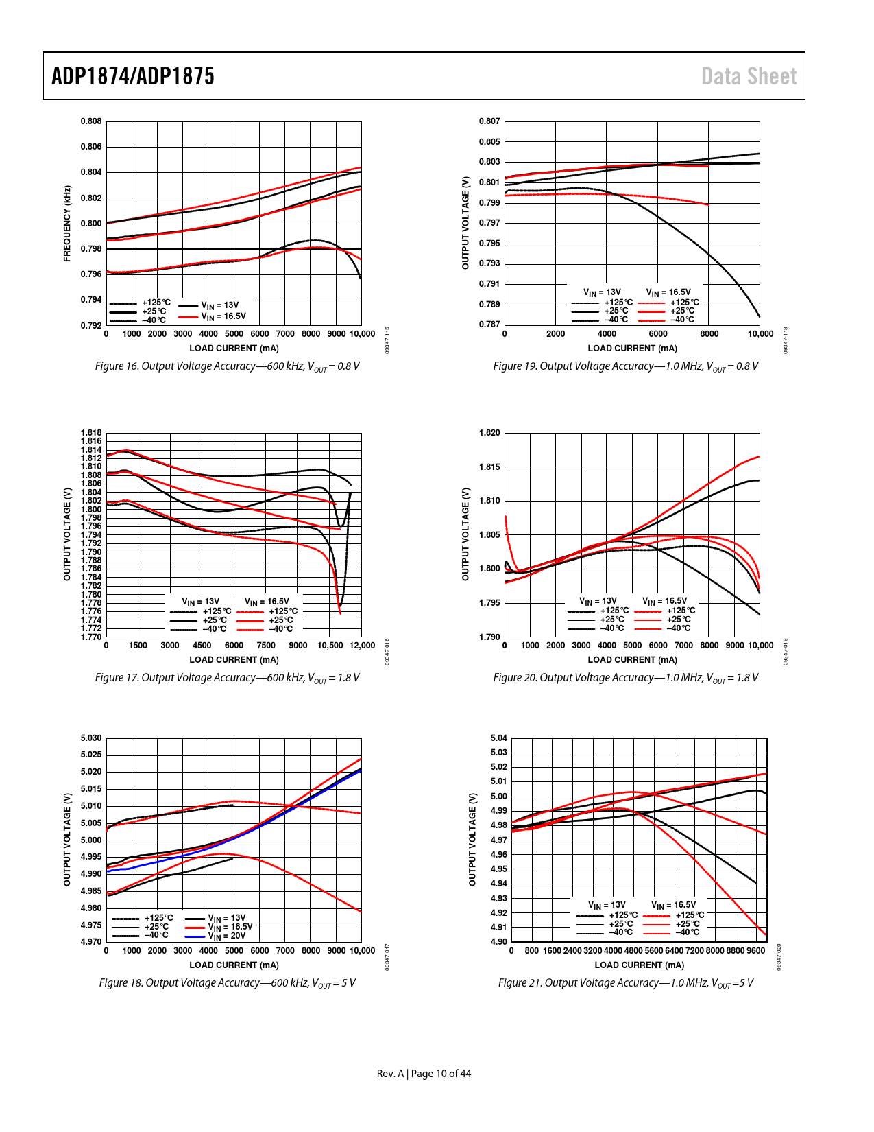

DescriptionSynchronous Buck Controller with Constant On-Time, Valley Current Mode, and Power Saving Mode
Pages / Page44 / 10 — ADP1874/ADP1875. Data Sheet. 0.808. 0.807. 0.805. 0.806. 0.803. 0.804. …
RevisionA
ADP1874/ADP1875. Data Sheet. 0.808. 0.807. 0.805. 0.806. 0.803. 0.804. 0.801. 0.802. kHz. 0.799. NCY. 0.800. OLTA. 0.797. T V. 0.795. 0.798. 0.793. 0.796. 0.791
ADP1874/ADP1875 Data Sheet 0.808 0.807 0.805 0.806 0.803 0.804 0.801 0.802 kHz 0.799 NCY 0.800 OLTA 0.797 T V 0.795 0.798 0.793 0.796 0.791
ADP1874/ADP1875 Data Sheet 0.808 0.807 0.805 0.806 0.803 0.804 ) ) V 0.801 ( 0.802 kHz GE ( 0.799 NCY 0.800 OLTA 0.797 UE T V Q U 0.795 0.798 RE TP F OU 0.793 0.796 0.791 VIN = 13V VIN = 16.5V 0.794 +125°C V +125°C +125°C 0.789 +25°C IN = 13V +25°C +25°C –40°C VIN = 16.5V –40°C –40°C 0.792 0.787 0 1000 2000 3000 4000 5000 6000 7000 8000 9000 10,000

09347- 09347- Figure 16. Output Voltage Accuracy—600 kHz, VOUT = 0.8 V Figure 19. Output Voltage Accuracy—1.0 MHz, VOUT = 0.8 V

09347- 09347- Figure 17. Output Voltage Accuracy—600 kHz, VOUT = 1.8 V Figure 20. Output Voltage Accuracy—1.0 MHz, VOUT = 1.8 V

09347- 09347- Figure 18. Output Voltage Accuracy—600 kHz, VOUT = 5 V Figure 21. Output Voltage Accuracy—1.0 MHz, VOUT =5 V Rev. A | Page 10 of 44 Document Outline Features Applications General Description Typical Applications Circuit Table of Contents Revision History Specifications Absolute Maximum Ratings Thermal Resistance Boundary Condition ESD Caution Pin Configuration and Function Descriptions Typical Performance Characteristics ADP1874/ADP1875 Block Digram Theory of Operation Startup Soft Start Precision Enable Circuitry Undervoltage Lockout On-Board Low Dropout Regulator Thermal Shutdown Programming Resistor (RES) Detect Circuit Valley Current-Limit Setting Hiccup Mode During Short Circuit Synchronous Rectifier ADP1875 Power Saving Mode (PSM) Timer Operation Pseudo-Fixed Frequency Power Good Monitoring Voltage Tracking Applications Information Feedback Resistor Divider Inductor Selection Output Ripple Voltage (ΔVRR) Output Capacitor Selection Compensation Network Output Filter Impedance (ZFILT) Error Amplifier Output Impedance (ZCOMP) Error Amplifier Gain (Gm) Current-Sense Loop Gain (GCS) Crossover Frequency Efficiency Consideration Channel Conduction Loss MOSFET Driver Loss Switching Loss Diode Conduction Loss Inductor Loss Input Capacitor Selection Thermal Considerations Design Example Input Capacitor Inductor Current Limit Programming Output Capacitor Feedback Resistor Network Setup Compensation Network Loss Calculations External Component Recommendations Layout Considerations IC Section (Left Side of Evaluation Board) Power Section Differential Sensing Typical Application Circuits 12 A, 300 kHz High Current Application Circuit 5.5 V Input, 600 kHz Application Circuit 300 kHz High Current Application Circuit Outline Dimensions Ordering Guide
