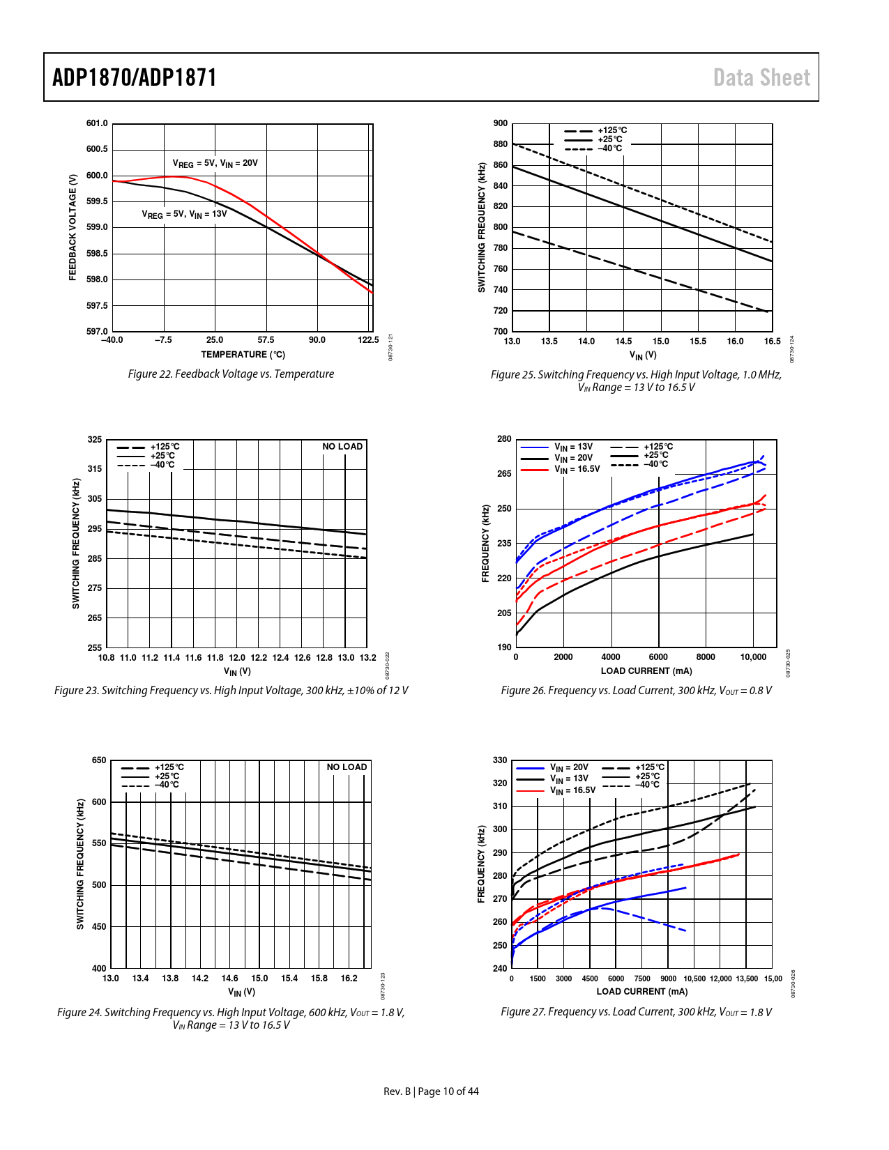

ADP1870/ADP1871. Data Sheet. 601.0. 900. +125°C +25°C. 880. 600.5. –40°C. REG = 5V, VIN = 20V. 860. 600.0. 840. Y C. 599.5. 820. VREG = 5V, VIN = 13V
ADP1870/ADP1871 Data Sheet 601.0 900 +125°C +25°C 880 600.5 –40°C REG = 5V, VIN = 20V 860 600.0 840 Y C 599.5 820 VREG = 5V, VIN = 13V
ADP1870/ADP1871 Data Sheet 601.0 900 +125°C +25°C 880 600.5 –40°C V ) REG = 5V, VIN = 20V z 860 ) 600.0 H V k ( ( 840 E Y C 599.5 AG N T E 820 L VREG = 5V, VIN = 13V O QU 599.0 E 800 R K V G F 780 598.5 IN DBAC H E E 760 F 598.0 ITC W S 740 597.5 720 597.0 700 –40.0 –7.5 25.0 57.5 90.0 122.5

08 Figure 22. Feedback Voltage vs. Temperature Figure 25. Switching Frequency vs. High Input Voltage, 1.0 MHz, VIN Range = 13 V to 16.5 V
325 280 +125°C NO LOAD VIN = 13V +125°C +25°C V +25°C IN = 20V –40°C –40°C 315 V 265 IN = 16.5V ) Hz k ( 305 ) 250 NCY Hz E k U 295 ( Y Q NC 235 RE F 285 UE Q NG E R F 220 CHI 275 IT W S 205 265 255 190

08 08 Figure 23. Switching Frequency vs. High Input Voltage, 300 kHz, ±10% of 12 V Figure 26. Frequency vs. Load Current, 300 kHz, VOUT = 0.8 V
650 330 +125°C NO LOAD VIN = 20V +125°C +25°C V +25°C –40°C 320 IN = 13V –40°C VIN = 16.5V ) 600 Hz 310 k ( ) 300 NCY Hz 550 k UE ( Y Q 290 NC RE F UE 280 500 Q NG E R F 270 CHI IT W 260 S 450 250 400 240

08 08 Figure 24. Switching Frequency vs. High Input Voltage, 600 kHz, VOUT = 1.8 V, Figure 27. Frequency vs. Load Current, 300 kHz, VOUT = 1.8 V VIN Range = 13 V to 16.5 V Rev. B | Page 10 of 44 Document Outline Features Applications General Description Typical Applications Circuit Revision History Specifications Absolute Maximum Ratings Thermal Resistance Boundary Condition ESD Caution Pin Configuration and Function Descriptions Typical Performance Characteristics ADP1870/ADP1871 Block Diagram Theory of Operation Startup Soft Start Precision Enable Circuitry Undervoltage Lockout On-Board Low Dropout Regulator Thermal Shutdown Programming Resistor (RES) Detect Circuit Valley Current-Limit Setting Hiccup Mode During Short Circuit Synchronous Rectifier Power Saving Mode (PSM) Version (ADP1871) Timer Operation Pseudo-Fixed Frequency Applications Information Feedback Resistor Divider Inductor Selection Output Ripple Voltage (ΔVRR) Output Capacitor Selection Compensation Network Output Filter Impedance (ZFILT) Error Amplifier Output Impedance (ZCOMP) Error Amplifier Gain (GM) Current-Sense Loop Gain (GCS) Crossover Frequency Efficiency Considerations Channel Conduction Loss MOSFET Driver Loss Switching Loss Diode Conduction Loss Inductor Loss Input Capacitor Selection Thermal Considerations Design Example Input Capacitor Inductor Current Limit Programming Output Capacitor Feedback Resistor Network Setup Compensation Network Loss Calculations External Component Recommendations Layout Considerations IC Section (Left Side of Evaluation Board) Power Section Differential Sensing Typical Applications Circuits 15 A, 300 kHz High Current Application Circuit 5.5 V Input, 600 kHz Application Circuit 300 kHz High Current Application Circuit Outline Dimensions Ordering Guide
