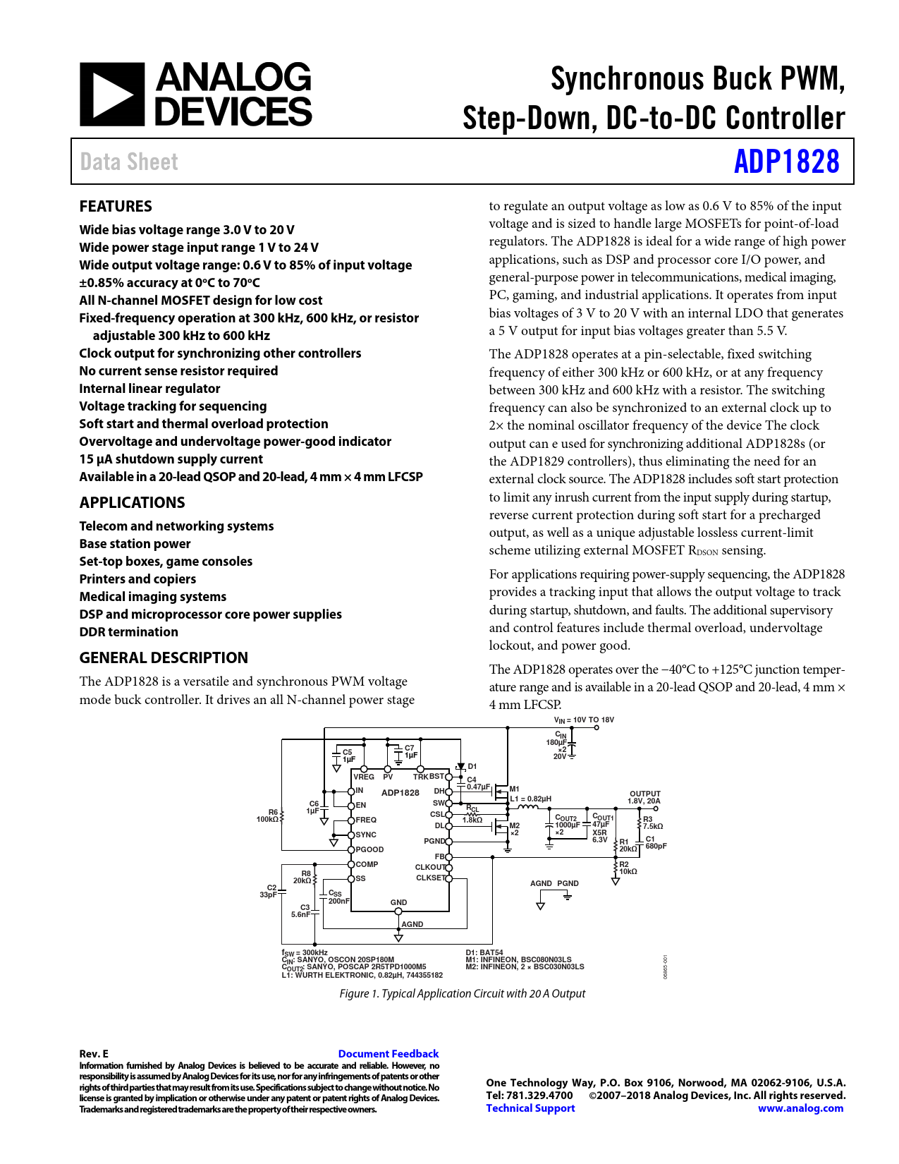

VIN = 10V TO 18V CIN 180µF C7 ×2 C5 1µF 20V 1µF D1 VREG PV TRK BST C4 0.47µF IN M1 DH ADP1828 OUTPUT L1 = 0.82µH 1.8V, 20A C6 EN SW RCL R6 1µF CSL C C 100kΩ FREQ 1.8kΩ OUT2 OUT1 R3 DL M2 1000µF 47µF 7.5kΩ SYNC ×2 ×2 X5R PGND 6.3V R1 C1 PGOOD 20kΩ 680pF FB COMP CLKOUT R2 R8 10kΩ SS CLKSET 20kΩ AGND PGND C2 C 33pF SS 200nF GND C3 5.6nF AGND f D1: BAT54 SW = 300kHz C M1: INFINEON, BSC080N03LS IN: SANYO, OSCON 20SP180M
001
C M2: INFINEON, 2 × BSC030N03LS OUT2: SANYO, POSCAP 2R5TPD1000M5 L1: WURTH ELEKTRONIC, 0.82µH, 744355182
06865- Figure 1. Typical Application Circuit with 20 A Output
