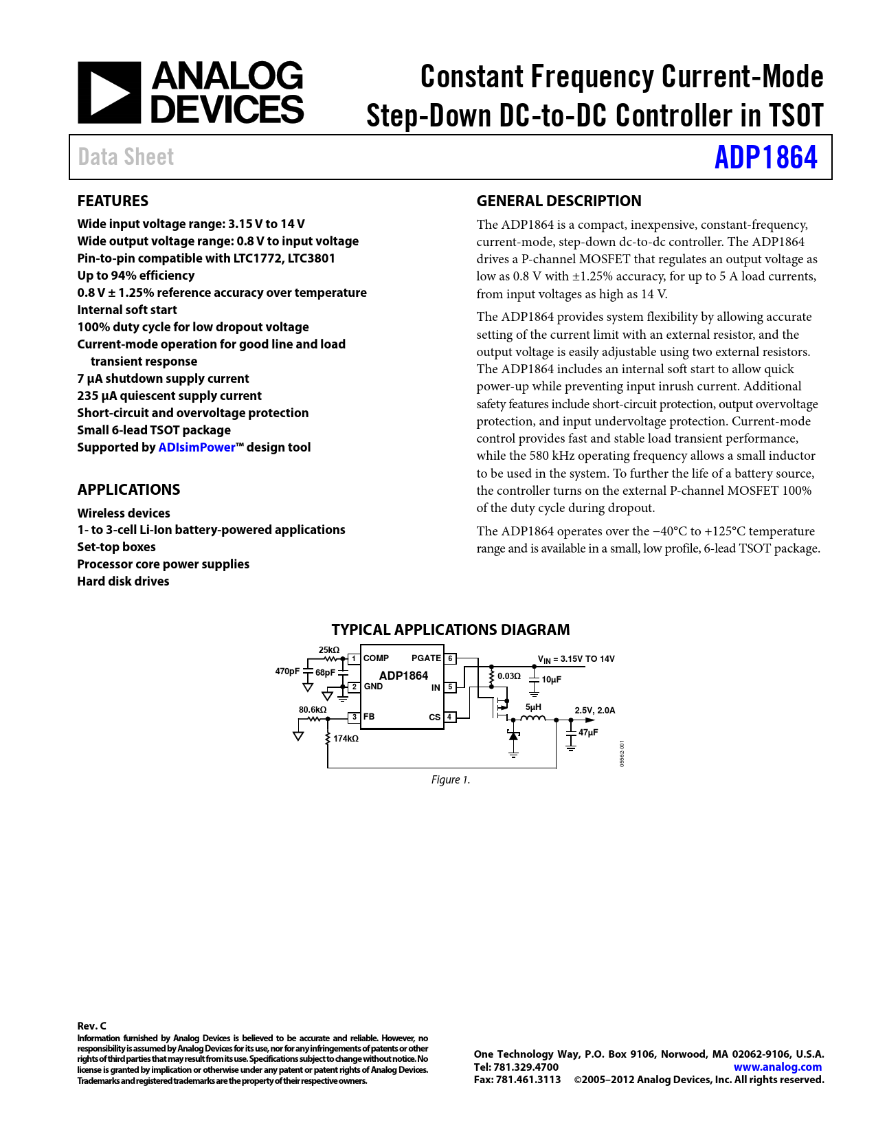

Constant Frequency Current-Mode Step-Down DC-to-DC Control er in TSOT Data Sheet ADP1864 FEATURES GENERAL DESCRIPTION Wide input voltage range: 3.15 V to 14 V
The ADP1864 is a compact, inexpensive, constant-frequency,
Wide output voltage range: 0.8 V to input voltage
current-mode, step-down dc-to-dc control er. The ADP1864
Pin-to-pin compatible with LTC1772, LTC3801
drives a P-channel MOSFET that regulates an output voltage as
Up to 94% efficiency
low as 0.8 V with ±1.25% accuracy, for up to 5 A load currents,
0.8 V ± 1.25% reference accuracy over temperature
from input voltages as high as 14 V.
Internal soft start
The ADP1864 provides system flexibility by allowing accurate
100% duty cycle for low dropout voltage
setting of the current limit with an external resistor, and the
Current-mode operation for good line and load
output voltage is easily adjustable using two external resistors.
transient response
The ADP1864 includes an internal soft start to al ow quick
7 μA shutdown supply current
power-up while preventing input inrush current. Additional
235 μA quiescent supply current
safety features include short-circuit protection, output overvoltage
Short-circuit and overvoltage protection
protection, and input undervoltage protection. Current-mode
Small 6-lead TSOT package
control provides fast and stable load transient performance,
Supported by ADIsimPower™ design tool
while the 580 kHz operating frequency allows a small inductor
to be used in the system. To further the life of a battery source,
APPLICATIONS
the control er turns on the external P-channel MOSFET 100%
Wireless devices
of the duty cycle during dropout.
1- to 3-cell Li-Ion battery-powered applications
The ADP1864 operates over the −40°C to +125°C temperature
Set-top boxes
range and is available in a small, low profile, 6-lead TSOT package.
Processor core power supplies Hard disk drives TYPICAL APPLICATIONS DIAGRAM 25kΩ 1 COMP PGATE 6 VIN = 3.15V TO 14V 470pF 68pF ADP1864 0.03Ω 10µF 2 GND IN 5 80.6kΩ 5µH 2.5V, 2.0A 3 FB CS 4 174kΩ 47µF
