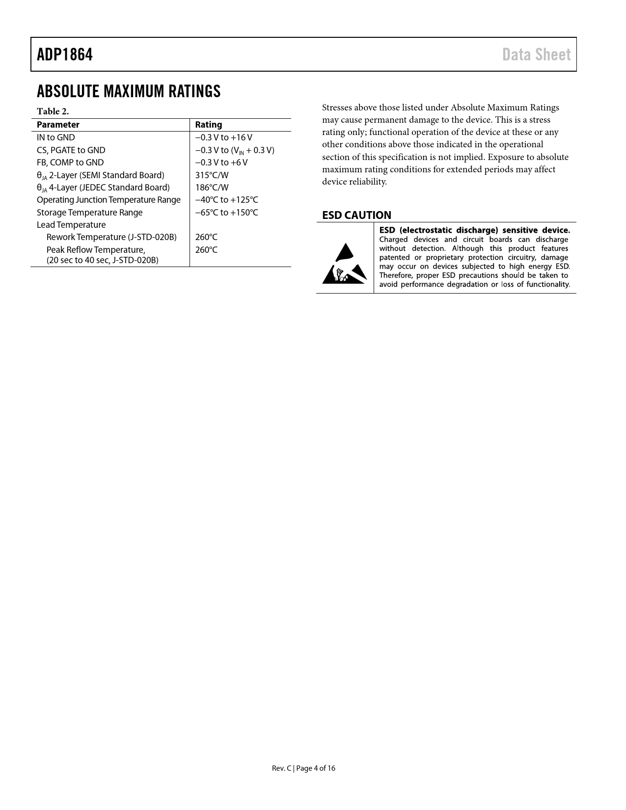

ADP1864. Data Sheet. ABSOLUTE MAXIMUM RATINGS Table 2. Parameter. Rating. ESD CAUTION
ADP1864 Data Sheet ABSOLUTE MAXIMUM RATINGS Table 2 Parameter Rating ESD CAUTION
ADP1864 Data Sheet ABSOLUTE MAXIMUM RATINGS Table 2.
Stresses above those listed under Absolute Maximum Ratings
Parameter Rating
may cause permanent damage to the device. This is a stress rating only; functional operation of the device at these or any IN to GND −0.3 V to +16 V other conditions above those indicated in the operational CS, PGATE to GND −0.3 V to (V + 0.3 V) IN section of this specification is not implied. Exposure to absolute FB, COMP to GND −0.3 V to +6 V maximum rating conditions for extended periods may affect θ 2-Layer (SEMI Standard Board) 315°C/W JA device reliability. θ 4-Layer (JEDEC Standard Board) 186°C/W JA Operating Junction Temperature Range −40°C to +125°C Storage Temperature Range −65°C to +150°C
ESD CAUTION
Lead Temperature Rework Temperature (J-STD-020B) 260°C Peak Reflow Temperature, 260°C (20 sec to 40 sec, J-STD-020B) Rev. C | Page 4 of 16 Document Outline Features Applications General Description Typical Applications Diagram Revision History Specifications Absolute Maximum Ratings ESD Caution Pin Configuration and Function Descriptions Typical Performance Characteristics Theory of Operation Loop Startup Short-Circuit Protection Undervoltage Lockout (UVLO) Overvoltage Lockout Protection (OVP) Soft Start Applications Information ADIsimPower Design Tool Duty Cycle Ripple Current Sense Resistor Inductor Value MOSFET Diode Input Capacitor Output Capacitor Feedback Resistors Layout Considerations Example Applications Circuits Outline Dimensions Ordering Guide
