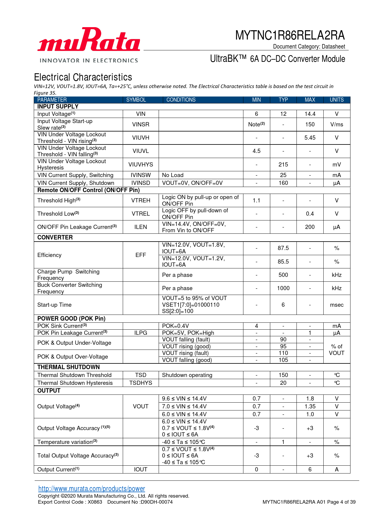

UltraBK™ 6A DC–DC Converter Module
Electrical Characteristics
VIN=12V, VOUT=1.8V, IOUT=6A, Ta=+25°C, unless otherwise noted. The Electrical Characteristics table is based on the test circuit in Figure 35.
PARAMETER SYMBOL CONDITIONS MIN TYP MAX UNITS INPUT SUPPLY
Input Voltage
(1)
VIN 6 12 14.4 V Input Voltage Start-up VINSR Note
(2)
- 150 V/ms Slew rate
(3)
VIN Under Voltage Lockout VIUVH - - 5.45 V Threshold - VIN rising
(3)
VIN Under Voltage Lockout VIUVL 4.5 - - V Threshold - VIN falling
(3)
VIN Under Voltage Lockout VIUVHYS - 215 - mV Hysteresis VIN Current Supply, Switching IVINSW No Load - 25 - mA VIN Current Supply, Shutdown IVINSD VOUT=0V, ON/OFF=0V - 160 - µA
Remote ON/OFF Control (ON/OFF Pin)
Logic ON by pull-up or open of Threshold High
(3)
VTREH 1.1 - - V ON/OFF Pin Logic OFF by pull-down of Threshold Low
(3)
VTREL - - 0.4 V ON/OFF Pin VIN=14.4V, ON/OFF=0V, ON/OFF Pin Leakage Current
(3)
ILEN - - 200 µA From Vin to ON/OFF
CONVERTER
VIN=12.0V, VOUT=1.8V, - 87.5 - % IOUT=6A Efficiency EFF VIN=12.0V, VOUT=1.2V, - 85.5 - % IOUT=6A Charge Pump Switching Per a phase - 500 - kHz Frequency Buck Converter Switching Per a phase - 1000 - kHz Frequency VOUT=5 to 95% of VOUT Start-up Time VSET1[7:0]=01000110 - 6 - msec SS[2:0]=100
POWER GOOD (POK Pin)
POK Sink Current
(3)
POK=0.4V 4 - - mA POK Pin Leakage Current
(3)
ILPG POK=5V, POK=High - - 1 µA VOUT falling (fault) - 90 - POK & Output Under-Voltage VOUT rising (good) - 95 - % of VOUT rising (fault) - 110 - VOUT POK & Output Over-Voltage VOUT falling (good) - 105 -
THERMAL SHUTDOWN
Thermal Shutdown Threshold TSD Shutdown operating - 150 - °C Thermal Shutdown Hysteresis TSDHYS - 20 - °C
OUTPUT
9.6 ≤ VIN ≤ 14.4V 0.7 - 1.8 V Output Voltage
(4)
VOUT 7.0 ≤ VIN ≤ 14.4V 0.7 - 1.35 V 6.0 ≤ VIN ≤ 14.4V 0.7 - 1.0 V 6.0 ≤ VIN ≤ 14.4V Output Voltage Accuracy
(1)(5)
0.7 ≤ VOUT ≤ 1.8V
(4)
-3 - +3 % 0 ≤ IOUT ≤ 6A Temperature variation
(3)
-40 ≤ Ta ≤ 105°C - 1 - % 0.7 ≤ VOUT ≤ 1.8V
(4)
Total Output Voltage Accuracy
(3)
0 ≤ IOUT ≤ 6A -3 - +3 % -40 ≤ Ta ≤ 105°C Output Current
(1)
IOUT 0 - 6 A
