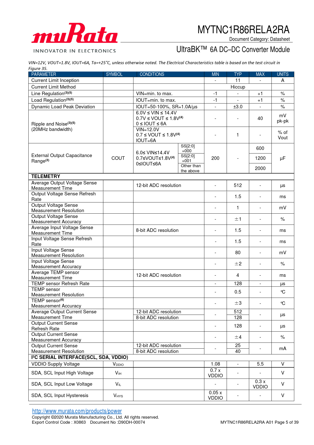

UltraBK™ 6A DC–DC Converter Module VIN=12V, VOUT=1.8V, IOUT=6A, Ta=+25°C, unless otherwise noted. The Electrical Characteristics table is based on the test circuit in Figure 35.
PARAMETER SYMBOL CONDITIONS MIN TYP MAX UNITS
Current Limit Inception - 11 - A Current Limit Method Hiccup Line Regulation
(3)(5)
VIN=min. to max. -1 - +1 % Load Regulation
(3)(5)
IOUT=min. to max. -1 - +1 % Dynamic Load Peak Deviation IOUT=50-100%, SR=1.0A/µs - ±3.0 - % 6.0V ≤ VIN ≤ 14.4V mV 0.7V ≤ VOUT ≤ 1.8V
(4)
- - 40 pk-pk Ripple and Noise
(3)(5)
0 ≤ IOUT ≤ 6A (20MHz bandwidth) VIN=12.0V % of 0.7 ≤ VOUT ≤ 1.8V
(4)
- 1 - Vout IOUT=6A SS[2:0] 600 6.0≤ VIN≤14.4V =000 External Output Capacitance SS[2:0] COUT 0.7≤VOUT≤1.8V
(4)
200 - 1200 µF Range
(3)
=001 0≤IOUT≤6A Other than 2000 the above
TELEMETRY
Average Output Voltage Sense 12-bit ADC resolution - 512 - µs Measurement Time
Output Voltage Sense Refresh - 1.5 - ms Rate Output Voltage Sense - 1 - mV Measurement Resolution Output Voltage Sense - ±1 - % Measurement Accuracy Average Input Voltage Sense 8-bit ADC resolution - 1.5 - ms Measurement Time
Input Voltage Sense Refresh - 1.5 - ms Rate Input Voltage Sense - 80 - mV Measurement Resolution Input Voltage Sense - ±2 - % Measurement Accuracy Average TEMP sensor 12-bit ADC resolution - 4 - ms Measurement Time TEMP sensor Refresh Rate - 128 - µs TEMP sensor - 0.5 - °C Measurement Resolution TEMP sensor
(6)
- ±3 - °C Measurement Accuracy Average Output Current Sense 12-bit ADC resolution 512 - - µs
Measurement Time 8-bit ADC resolution 128 Output Current Sense - 128 - µs Refresh Rate Output Current Sense - ±4 - % Measurement Accuracy Output Current Sense 12-bit ADC resolution 25 - - mA Measurement Resolution 8-bit ADC resolution 40
I2C SERIAL INTERFACE(SCL, SDA, VDDIO)
VDDIO Supply Voltage VDDIO 1.08 - 5.5 V 0.7 x SDA, SCL Input High Voltage VIH - - V VDDIO 0.3 x SDA, SCL Input Low Voltage VIL - - V VDDIO 0.05 x SDA, SCL Input Hysteresis VHYS - - V VDDIO
