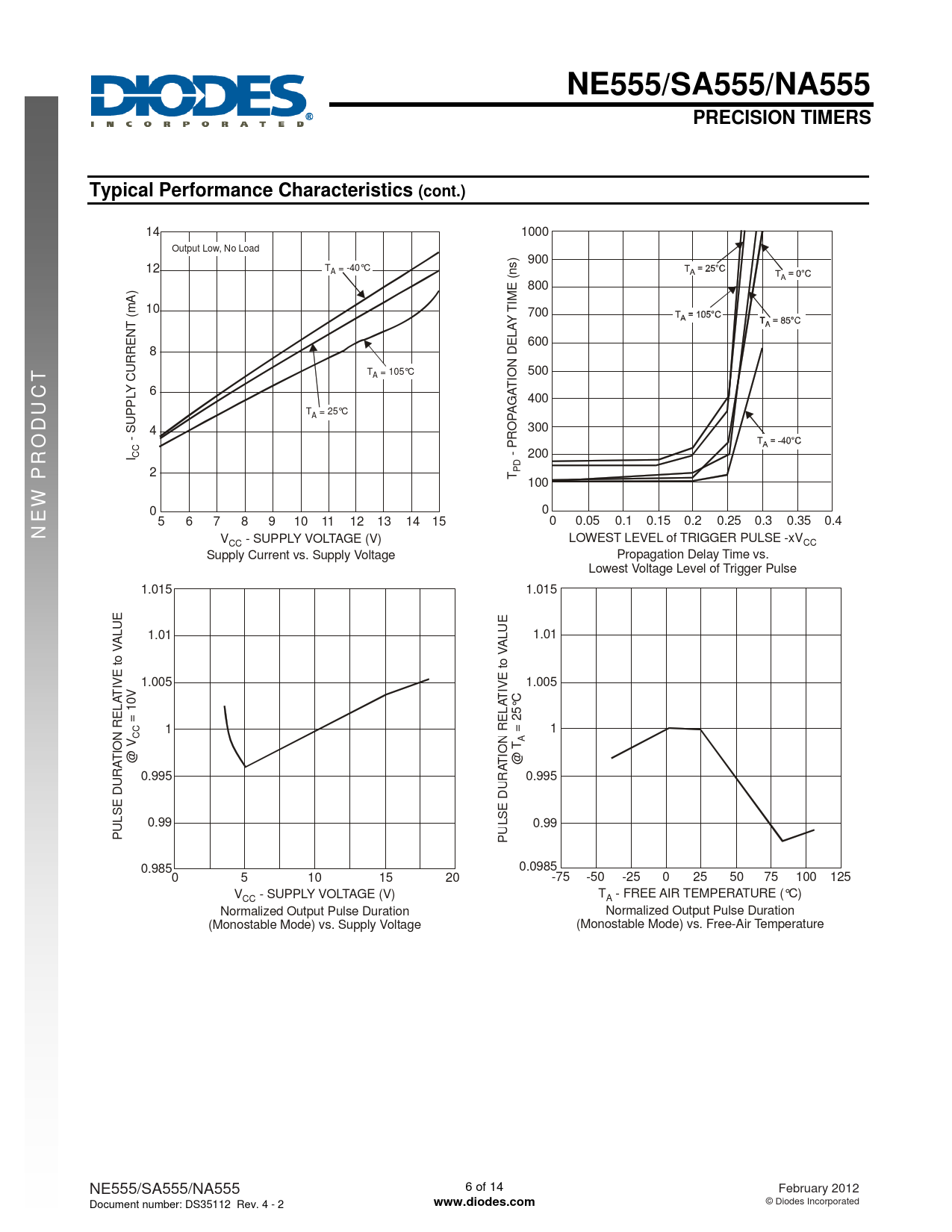

NE555/SA555/NA555. PRECISION TIMERS. Typical Performance Characteristics (cont.). NEW PROD. www.diodes.com
NE555/SA555/NA555 PRECISION TIMERS Typical Performance Characteristics (cont.)
14 1000 Output Low, No Load ) 900 12 T = -40°C s A (n ) E 800 A M 10 (m TI 700 Y A 600 8 DEL
T
N T = 105 500 A °C CURRENT IO Y T 6 A
UC
L 400 T = 25°C AG A P SUPP 4 300 - PRO I CC - 200 2 PDT 100 0 0
NEW PROD
5 6 7 8 9 10 11 12 13 14 15 0 0.05 0.1 0.15 0.2 0.25 0.3 0.35 0.4 V - SUPPLY VOLTAGE (V) LOWEST LEVEL of TRIGGER PULSE -xV CC CC Supply Current vs. Supply Voltage Propagation Delay Time vs. Lowest Voltage Level of Trigger Pulse 1.015 1.015 E E U L U A 1.01 L 1.01 A V V to to E IVE 1.005 1.005 T V IV A 0 T A °C 1 5 = EL 2 1 R 1 = CCV N A ION REL T IO @ T @ T A 0.995 R 0.995 U D SE DURA E 0.99 LS 0.99 PUL U P 0.985 0.0985 0 5 10 15 20 -75 -50 -25 0 25 50 75 100 125 V - SUPPLY VOLTAGE (V) T - FREE AIR TEMPERATURE (°C) CC A Normalized Output Pulse Duration Normalized Output Pulse Duration (Monostable Mode) vs. Supply Voltage (Monostable Mode) vs. Free-Air Temperature NE555/SA555/NA555 6 of 14 February 2012 Document number: DS35112 Rev. 4 - 2
