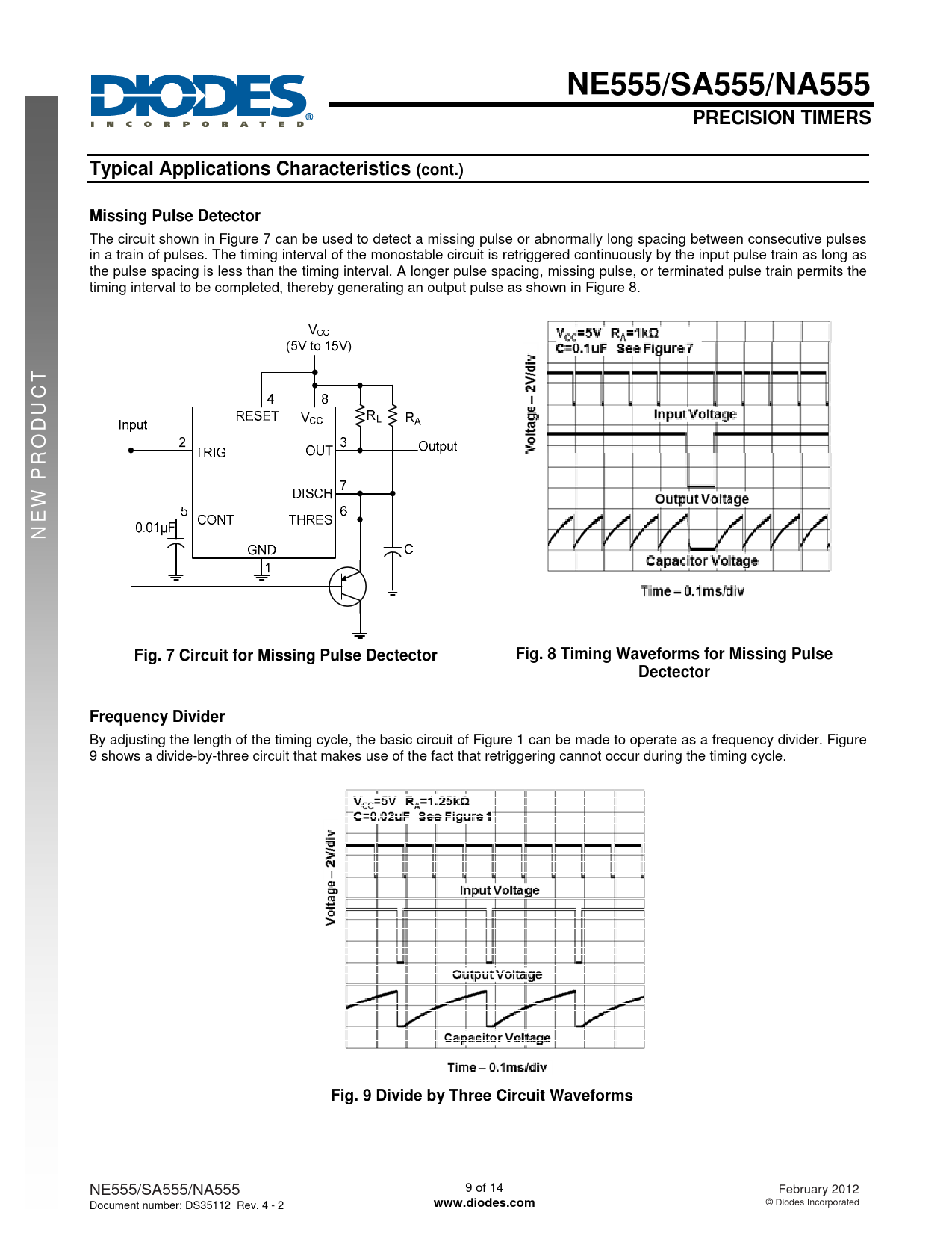

NE555/SA555/NA555. PRECISION TIMERS. Typical Applications Characteristics (cont.). Missing Pulse Detector. T UC. NEW PROD
NE555/SA555/NA555 PRECISION TIMERS Typical Applications Characteristics (cont.) Missing Pulse Detector
The circuit shown in Figure 7 can be used to detect a missing pulse or abnormally long spacing between consecutive pulses in a train of pulses. The timing interval of the monostable circuit is retriggered continuously by the input pulse train as long as the pulse spacing is less than the timing interval. A longer pulse spacing, missing pulse, or terminated pulse train permits the timing interval to be completed, thereby generating an output pulse as shown in Figure 8.
T UC NEW PROD Fig. 7 Circuit for Missing Pulse Dectector Fig. 8 Timing Waveforms for Missing Pulse Dectector Frequency Divider
By adjusting the length of the timing cycle, the basic circuit of Figure 1 can be made to operate as a frequency divider. Figure 9 shows a divide-by-three circuit that makes use of the fact that retriggering cannot occur during the timing cycle.
Fig. 9 Divide by Three Circuit Waveforms
