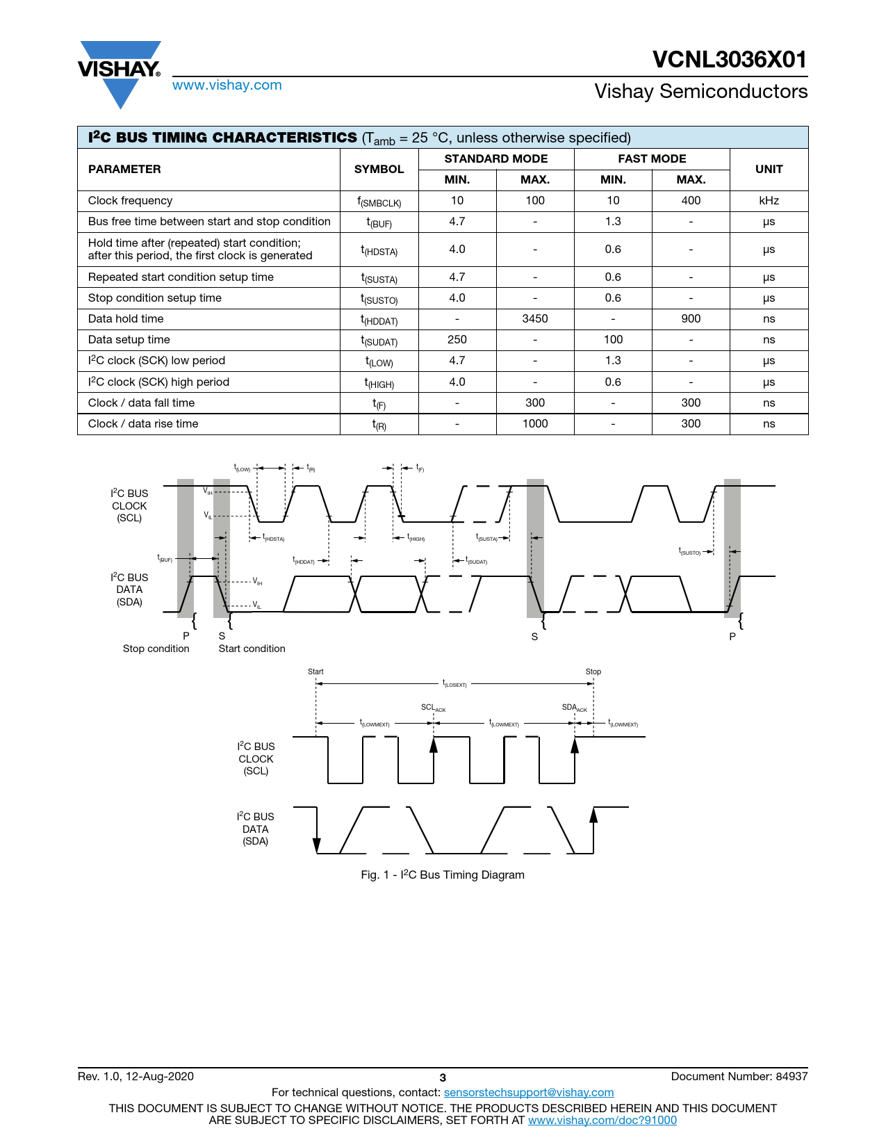

VCNL3036X01
I2C BUS TIMING CHARACTERISTICS
(Tamb = 25 °C, unless otherwise specified)
STANDARD MODE FAST MODE PARAMETER SYMBOL UNIT MIN. MAX. MIN. MAX.
Clock frequency f(SMBCLK) 10 100 10 400 kHz Bus free time between start and stop condition t(BUF) 4.7 - 1.3 - μs Hold time after (repeated) start condition; t after this period, the first clock is generated (HDSTA) 4.0 - 0.6 - μs Repeated start condition setup time t(SUSTA) 4.7 - 0.6 - μs Stop condition setup time t(SUSTO) 4.0 - 0.6 - μs Data hold time t(HDDAT) - 3450 - 900 ns Data setup time t(SUDAT) 250 - 100 - ns I2C clock (SCK) low period t(LOW) 4.7 - 1.3 - μs I2C clock (SCK) high period t(HIGH) 4.0 - 0.6 - μs Clock / data fall time t(F) - 300 - 300 ns Clock / data rise time t(R) - 1000 - 300 ns t t t (LOW) (R) (F) VIH I2C BUS CLOCK VIL (SCL) t t t (HDSTA) (HIGH) (SUSTA) t(SUSTO) t(BUF) t t (HDDAT) (SUDAT) I2C BUS VIH DATA (SDA) VIL { { { { P S S P Stop condition Start condition Start Stop t(LOSEXT) SCL SDA ACK ACK t t t (LOWMEXT) (LOWMEXT) (LOWMEXT) I2C BUS CLOCK (SCL) I2C BUS DATA (SDA) Fig. 1 - I2C Bus Timing Diagram Rev. 1.0, 12-Aug-2020
