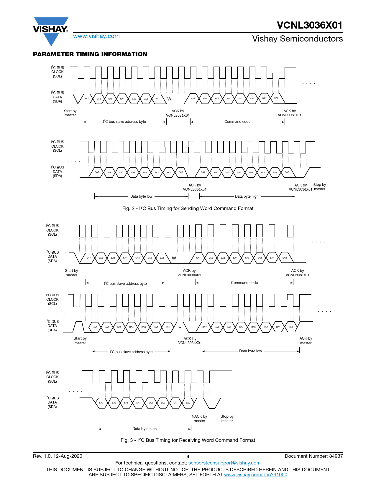

Pages / Page16 / 4 — VCNL3036X01. PARAMETER TIMING INFORMATION
File Format / SizePDF / 239 Kb
VCNL3036X01 PARAMETER TIMING INFORMATION
VCNL3036X01
I2C BUS CLOCK (SCL) I2C BUS DATA SA7 SA6 SA5 SA4 SA3 SA2 SA1 W SA6 SA5 SA4 SA3 SA2 SA1 SA0 SA7 (SDA) Start by ACK by ACK by master VCNL3036X01 VCNL3036X01 I2C bus slave address byte Command code I2C BUS CLOCK (SCL) I2C BUS DATA SA7 SA6 SA5 SA4 SA3 SA2 SA1 SA0 SA7 SA6 SA5 SA4 SA3 SA2 SA1 SA0 (SDA) ACK by ACK by Stop by VCNL3036X01 VCNL3036X01 master Data byte low Data byte high Fig. 2 - I2C Bus Timing for Sending Word Command Format I2C BUS CLOCK (SCL) I2C BUS DATA SA7 SA6 SA5 SA4 SA3 SA2 SA1 W SA7 SA6 SA5 SA4 SA3 SA2 SA1 SA0 (SDA) Start by ACK by ACK by master VCNL3036X01 VCNL3036X01 I2C bus slave address byte Command code I2C BUS CLOCK (SCL) I2C BUS DATA SA7 SA6 SA5 SA4 SA3 SA2 SA1 R SA7 SA6 SA5 SA4 SA3 SA2 SA1 SA0 (SDA) Start by ACK by ACK by master VCNL3036X01 master I2C bus slave address byte Data byte low I2C BUS CLOCK (SCL) I2C BUS DATA SA7 SA6 SA5 SA4 SA3 SA2 SA1 SA0 (SDA) NACK by Stop by master master Data byte high Fig. 3 - I2C Bus Timing for Receiving Word Command Format Rev. 1.0, 12-Aug-2020
