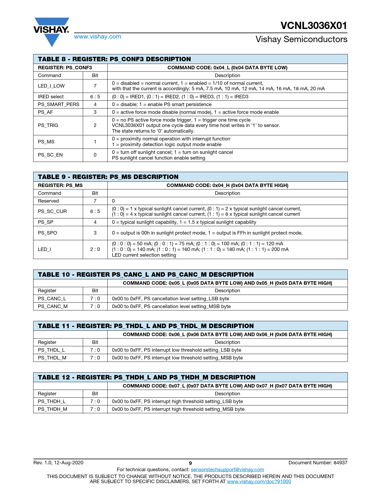

VCNL3036X01. TABLE 8 - REGISTER: PS_CONF3 DESCRIPTION REGISTER: PS_CONF3. COMMAND CODE: 0x04_L (0x04 DATA BYTE LOW)
VCNL3036X01 TABLE 8 - REGISTER: PS_CONF3 DESCRIPTION REGISTER: PS_CONF3 COMMAND CODE: 0x04_L (0x04 DATA BYTE LOW)
VCNL3036X01
Command Bit Description 0 = disabled = normal current, 1 = enabled = 1/10 of normal current, LED_I_LOW 7 with that the current is accordingly: 5 mA, 7.5 mA, 10 mA, 12 mA, 14 mA, 16 mA, 18 mA, 20 mA IRED select 6 : 5 (0 : 0) = IRED1, (0 : 1) = IRED2, (1 : 0) = IRED3, (1 : 1) = IRED3 PS_SMART_PERS 4 0 = disable; 1 = enable PS smart persistence PS_AF 3 0 = active force mode disable (normal mode), 1 = active force mode enable 0 = no PS active force mode trigger, 1 = trigger one time cycle PS_TRIG 2 VCNL3036X01 output one cycle data every time host writes in ‘1’ to sensor. The state returns to ‘0’ automatically. 0 = proximity normal operation with interrupt function PS_MS 1 1 = proximity detection logic output mode enable 0 = turn off sunlight cancel; 1 = turn on sunlight cancel PS_SC_EN 0 PS sunlight cancel function enable setting
TABLE 9 - REGISTER: PS_MS DESCRIPTION REGISTER: PS_MS COMMAND CODE: 0x04_H (0x04 DATA BYTE HIGH)
Command Bit Description Reserved 7 0 (0 : 0) = 1 x typical sunlight cancel current, (0 : 1) = 2 x typical sunlight cancel current, PS_SC_CUR 6 : 5 (1 : 0) = 4 x typical sunlight cancel current, (1 : 1) = 8 x typical sunlight cancel current PS_SP 4 0 = typical sunlight capability, 1 = 1.5 x typical sunlight capability PS_SPO 3 0 = output is 00h in sunlight protect mode, 1 = output is FFh in sunlight protect mode, (0 : 0 : 0) = 50 mA; (0 : 0 : 1) = 75 mA; (0 : 1 : 0) = 100 mA; (0 : 1 : 1) = 120 mA LED_I 2 : 0 (1 : 0 : 0) = 140 mA; (1 : 0 : 1) = 160 mA; (1 : 1 : 0) = 180 mA; (1 : 1 : 1) = 200 mA LED current selection setting
TABLE 10 - REGISTER PS_CANC_L AND PS_CANC_M DESCRIPTION COMMAND CODE: 0x05_L (0x05 DATA BYTE LOW) AND 0x05_H (0x05 DATA BYTE HIGH)
Register Bit Description PS_CANC_L 7 : 0 0x00 to 0xFF, PS cancellation level setting_LSB byte PS_CANC_M 7 : 0 0x00 to 0xFF, PS cancellation level setting_MSB byte
TABLE 11 - REGISTER: PS_THDL_L AND PS_THDL_M DESCRIPTION COMMAND CODE: 0x06_L (0x06 DATA BYTE LOW) AND 0x06_H (0x06 DATA BYTE HIGH)
Register Bit Description PS_THDL_L 7 : 0 0x00 to 0xFF, PS interrupt low threshold setting_LSB byte PS_THDL_M 7 : 0 0x00 to 0xFF, PS interrupt low threshold setting_MSB byte
TABLE 12 - REGISTER: PS_THDH_L AND PS_THDH_M DESCRIPTION COMMAND CODE: 0x07_L (0x07 DATA BYTE LOW) AND 0x07_H (0x07 DATA BYTE HIGH)
Register Bit Description PS_THDH_L 7 : 0 0x00 to 0xFF, PS interrupt high threshold setting_LSB byte PS_THDH_M 7 : 0 0x00 to 0xFF, PS interrupt high threshold setting_MSB byte Rev. 1.0, 12-Aug-2020
