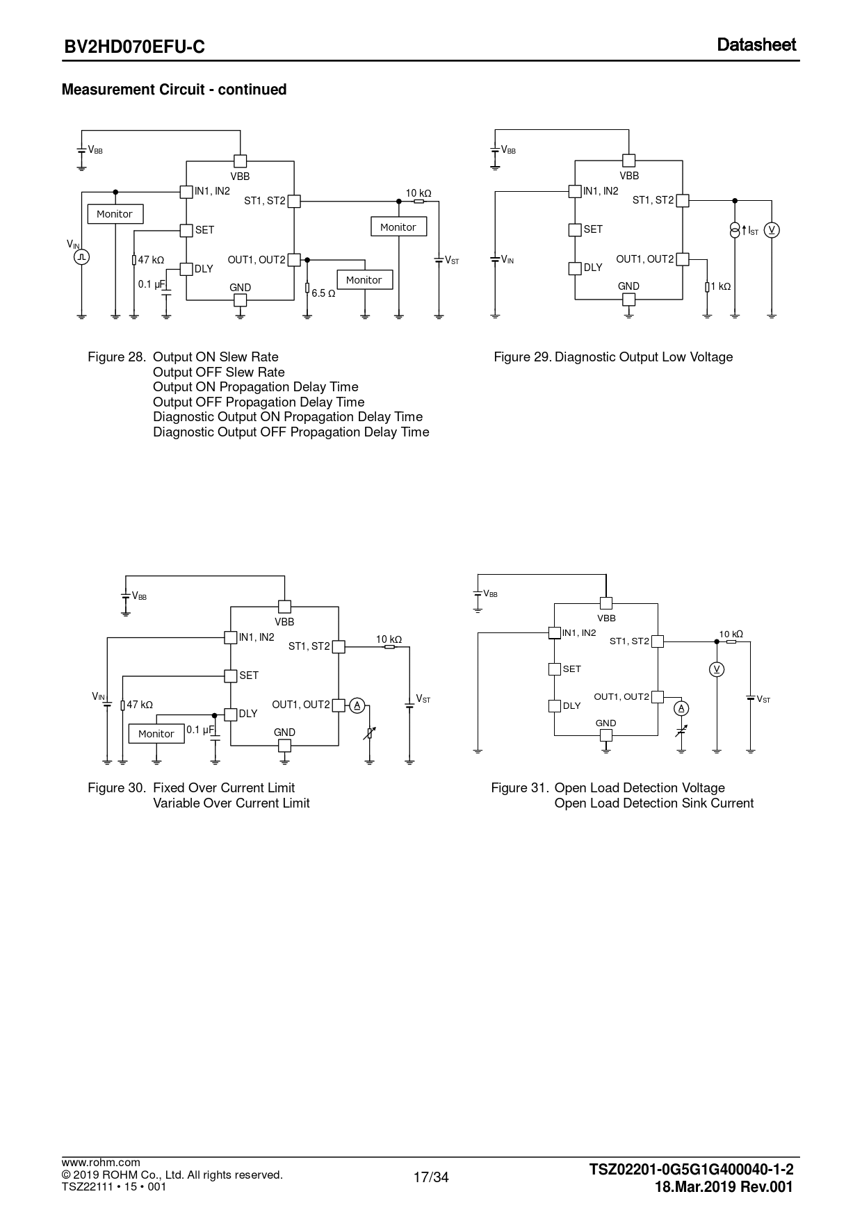

BV2HD070EFU-C. Measurement Circuit - continued. TSZ02201-0G5G1G400040-1-2. 18.Mar.2019 Rev.001
BV2HD070EFU-C Measurement Circuit - continued TSZ02201-0G5G1G400040-1-2 18.Mar.2019 Rev.001
VBB VBB VBB VBB IN1, IN2 10 kΩ IN1, IN2 ST1, ST2 ST1, ST2 Monitor Monitor SET SET IST VIN 47 kΩ OUT1, OUT2 VST VIN OUT1, OUT2 DLY DLY Monitor 0.1 μF GND GND 1 kΩ 6.5 Ω Figure 28. Output ON Slew Rate Figure 29. Diagnostic Output Low Voltage Output OFF Slew Rate Output ON Propagation Delay Time Output OFF Propagation Delay Time Diagnostic Output ON Propagation Delay Time Diagnostic Output OFF Propagation Delay Time V V BB BB VBB VBB IN1, IN2 IN1, IN2 10 kΩ 10 kΩ ST1, ST2 ST1, ST2 SET SET VIN V OUT1, OUT2 ST VST 47 kΩ OUT1, OUT2 DLY DLY GND 0.1 μF Monitor GND Figure 30. Fixed Over Current Limit Figure 31. Open Load Detection Voltage Variable Over Current Limit Open Load Detection Sink Current www.rohm.com
