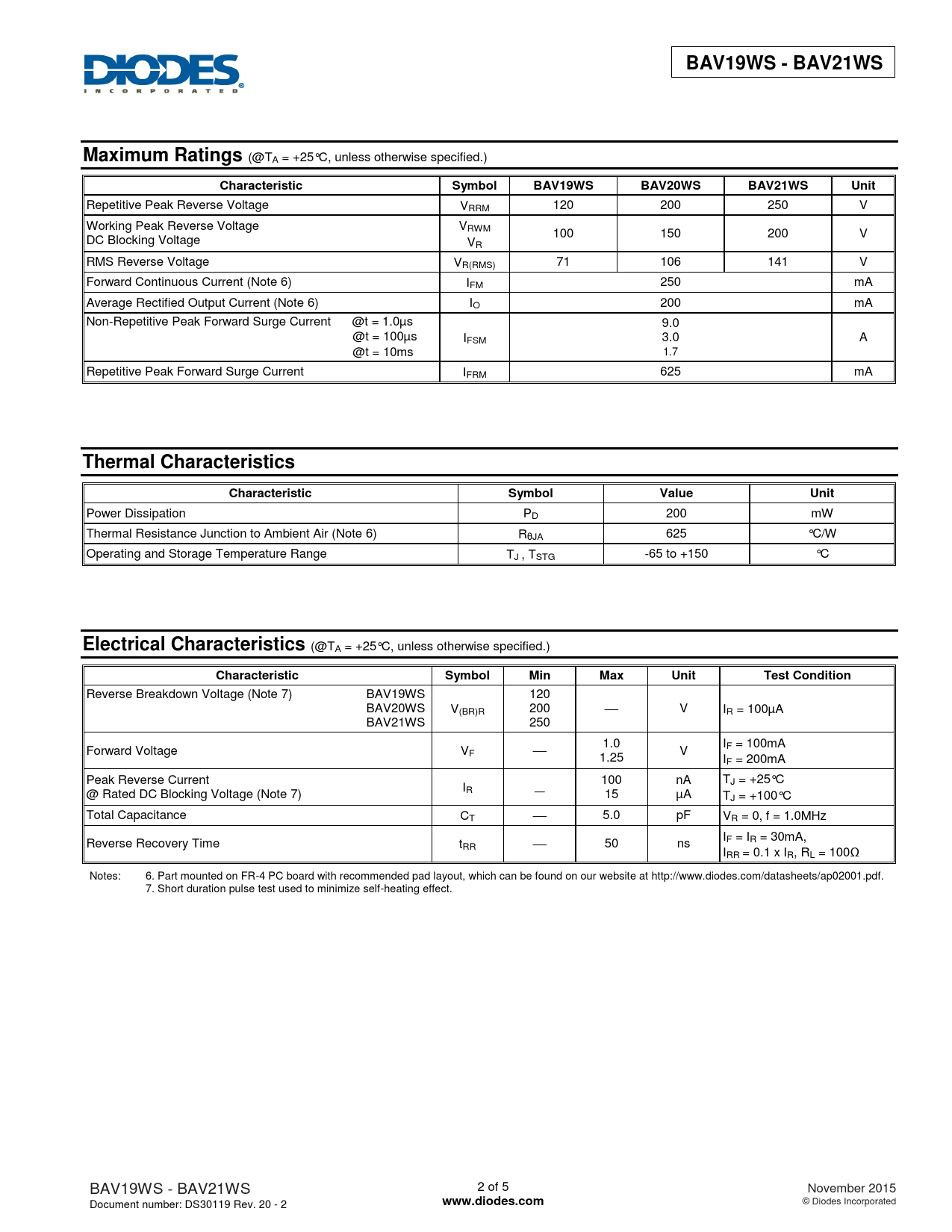

BAV19WS - BAV21WS. Maximum Ratings. Characteristic. Symbol. BAV19WS. BAV20WS. BAV21WS. Unit. Thermal Characteristics. Value
BAV19WS - BAV21WS Maximum Ratings
(@TA = +25°C, unless otherwise specified.)
Characteristic Symbol BAV19WS BAV20WS BAV21WS Unit
Repetitive Peak Reverse Voltage VRRM 120 200 250 V Working Peak Reverse Voltage VRWM 100 150 200 V DC Blocking Voltage VR RMS Reverse Voltage VR(RMS) 71 106 141 V Forward Continuous Current (Note 6) IFM 250 mA Average Rectified Output Current (Note 6) IO 200 mA Non-Repetitive Peak Forward Surge Current @t = 1.0µs 9.0 @t = 100µs IFSM 3.0 A @t = 10ms 1.7 Repetitive Peak Forward Surge Current IFRM 625 mA
Thermal Characteristics Characteristic Symbol Value Unit
Power Dissipation PD 200 mW Thermal Resistance Junction to Ambient Air (Note 6) RθJA 625 °C/W Operating and Storage Temperature Range TJ , TSTG -65 to +150 °C
Electrical Characteristics
Characteristic Symbol Min Max Unit Test Condition
Reverse Breakdown Voltage (Note 7) BAV19WS 120 BAV20WS V(BR)R 200  V IR = 100µA BAV21WS 250 1.0 I Forward Voltage V F = 100mA F  V 1.25 IF = 200mA Peak Reverse Current 100 nA T I J = +25°C @ Rated DC Blocking Voltage (Note 7) R  15 µA TJ = +100°C Total Capacitance CT  5.0 pF VR = 0, f = 1.0MHz I Reverse Recovery Time t F = IR = 30mA, RR  50 ns IRR = 0.1 x IR, RL = 100Ω Notes: 6. Part mounted on FR-4 PC board with recommended pad layout, which can be found on our website at http://www.diodes.com/datasheets/ap02001.pdf. 7. Short duration pulse test used to minimize self-heating effect. BAV19WS - BAV21WS 2 of 5 November 2015 Document number: DS30119 Rev. 20 - 2
