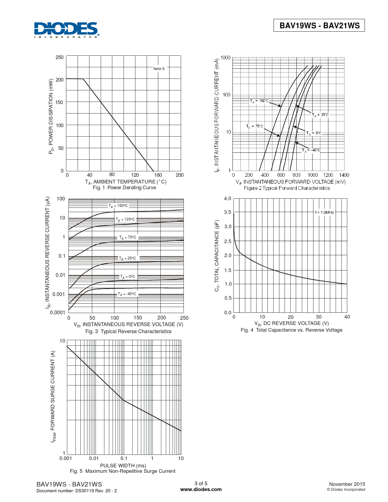

BAV19WS - BAV21WS
250 Note 6 ) 200 W m( NOIT 150 A PI S SI D 100 R E W O P , 50 DP 0 0 40 80 120 160 200 T , AMBIENT TEMPERATURE (° C) A Fig. 1 Power Derating Curve ) 100 A 4.0 ( T = 150ºC A T N 3.5 E 10 T = 125ºC R A ) R F U p( 3.0 C E E 1 T = 75ºC C A S N R 2.5 A E T V I E C R 0.1 A 2.0 T = 25ºC P A S A U C O L E 1.5 A N 0.01 T T = 0ºC A A O T T N , 1.0 A T T C S 0.001 T = -40ºC A NI 0.5 , I R 0.0001 0.0 0 50 100 150 200 250 0 10 20 30 40 V , INSTANTANEOUS REVERSE VOLTAGE (V) V , DC REVERSE VOLTAGE (V) R R Fig. 3 Typical Reverse Characteristics Fig. 4 Total Capacitance vs. Reverse Voltage 10 ) A( TNERRUC EGRUS DRAWROF ,MSIF 1 0.001 0.01 0.1 1 10 PULSE WIDTH (ms) Fig. 5 Maximum Non-Repetitive Surge Current BAV19WS - BAV21WS 3 of 5 November 2015 Document number: DS30119 Rev. 20 - 2
