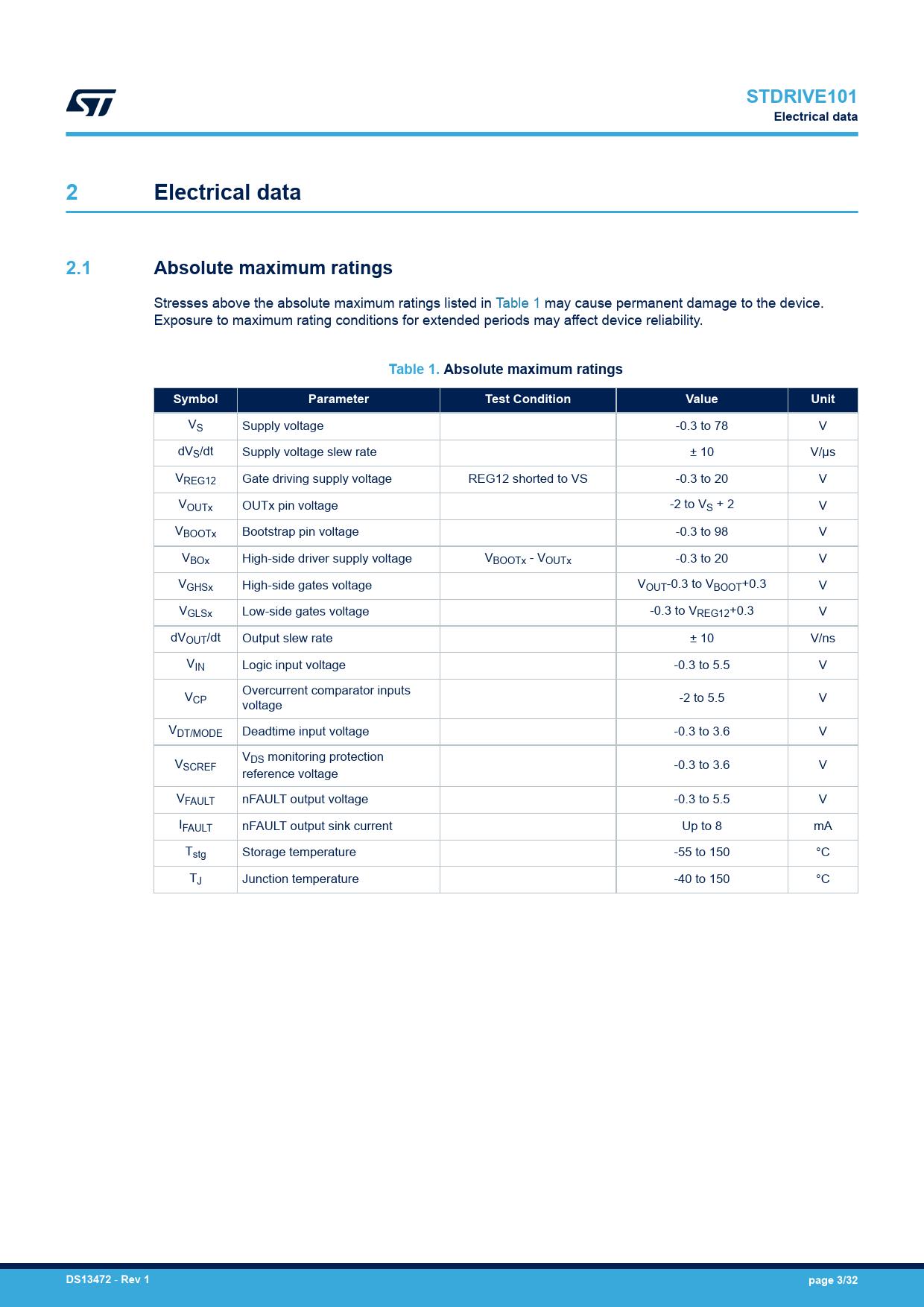

STDRIVE101. Electrical data. 2.1. Absolute maximum ratings. Table 1. Absolute maximum ratings. Symbol. Parameter. Test Condition. Value
STDRIVE101 Electrical data 2.1 Absolute maximum ratings Table 1 Absolute maximum ratings Symbol Parameter Test Condition Value
link to page 3
STDRIVE101 Electrical data 2 Electrical data 2.1 Absolute maximum ratings
Stresses above the absolute maximum ratings listed in Table 1 may cause permanent damage to the device. Exposure to maximum rating conditions for extended periods may affect device reliability.
Table 1. Absolute maximum ratings Symbol Parameter Test Condition Value Unit
VS Supply voltage -0.3 to 78 V dVS/dt Supply voltage slew rate ± 10 V/µs VREG12 Gate driving supply voltage REG12 shorted to VS -0.3 to 20 V VOUTx OUTx pin voltage -2 to VS + 2 V VBOOTx Bootstrap pin voltage -0.3 to 98 V VBOx High-side driver supply voltage VBOOTx - VOUTx -0.3 to 20 V VGHSx High-side gates voltage VOUT-0.3 to VBOOT+0.3 V VGLSx Low-side gates voltage -0.3 to VREG12+0.3 V dVOUT/dt Output slew rate ± 10 V/ns VIN Logic input voltage -0.3 to 5.5 V V Overcurrent comparator inputs CP -2 to 5.5 V voltage VDT/MODE Deadtime input voltage -0.3 to 3.6 V V V DS monitoring protection SCREF -0.3 to 3.6 V reference voltage VFAULT nFAULT output voltage -0.3 to 5.5 V IFAULT nFAULT output sink current Up to 8 mA Tstg Storage temperature -55 to 150 °C TJ Junction temperature -40 to 150 °C
