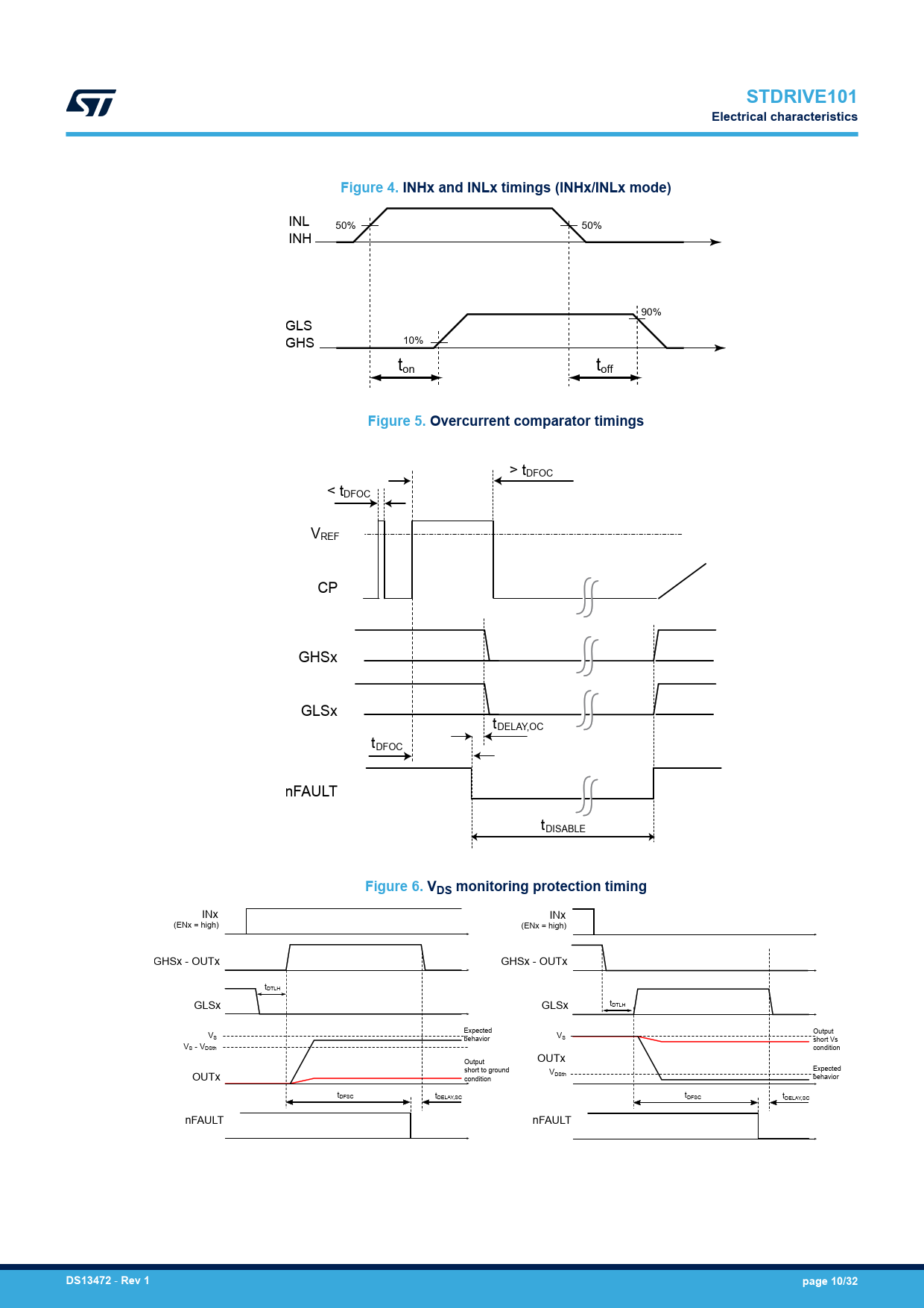

Pages / Page32 / 10 — STDRIVE101. Electrical characteristics. Figure 4. INHx and INLx timings …
File Format / SizePDF / 899 Kb
STDRIVE101. Electrical characteristics. Figure 4. INHx and INLx timings (INHx/INLx mode)
STDRIVE101 Electrical characteristics Figure 4 INHx and INLx timings (INHx/INLx mode)
STDRIVE101 Electrical characteristics Figure 4. INHx and INLx timings (INHx/INLx mode)
INL 50% 50% INH 90% GLS 10% GHS ton toff
Figure 5. Overcurrent comparator timings
> tDFOC < tDFOC VREF CP GHSx GLSx tDELAY,OC tDFOC nFAULT tDISABLE
Figure 6. VDS monitoring protection timing
INx INx (ENx = high) (ENx = high) GHSx - OUTx GHSx - OUTx tDTLH GLSx GLSx tDTLH Expected V Output S VS behavior short Vs VS - VDSth condition OUTx Output short to ground Expected OUTx VDSth condition behavior tDFSC tDELAY,SC tDFSC tDELAY,SC nFAULT nFAULT
