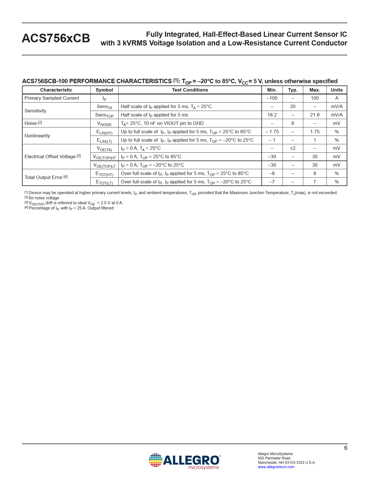

Fully Integrated, Hall-Effect-Based Linear Current Sensor IC ACS756xCB with 3 kVRMS Voltage Isolation and a Low-Resistance Current Conductor ACS756SCB-100 PERFORMANCE CHARACTERISTICS [1]: TOP = –20°C to 85°C, VCC = 5 V, unless otherwise specified Characteristic Symbol Test Conditions Min. Typ. Max. Units
