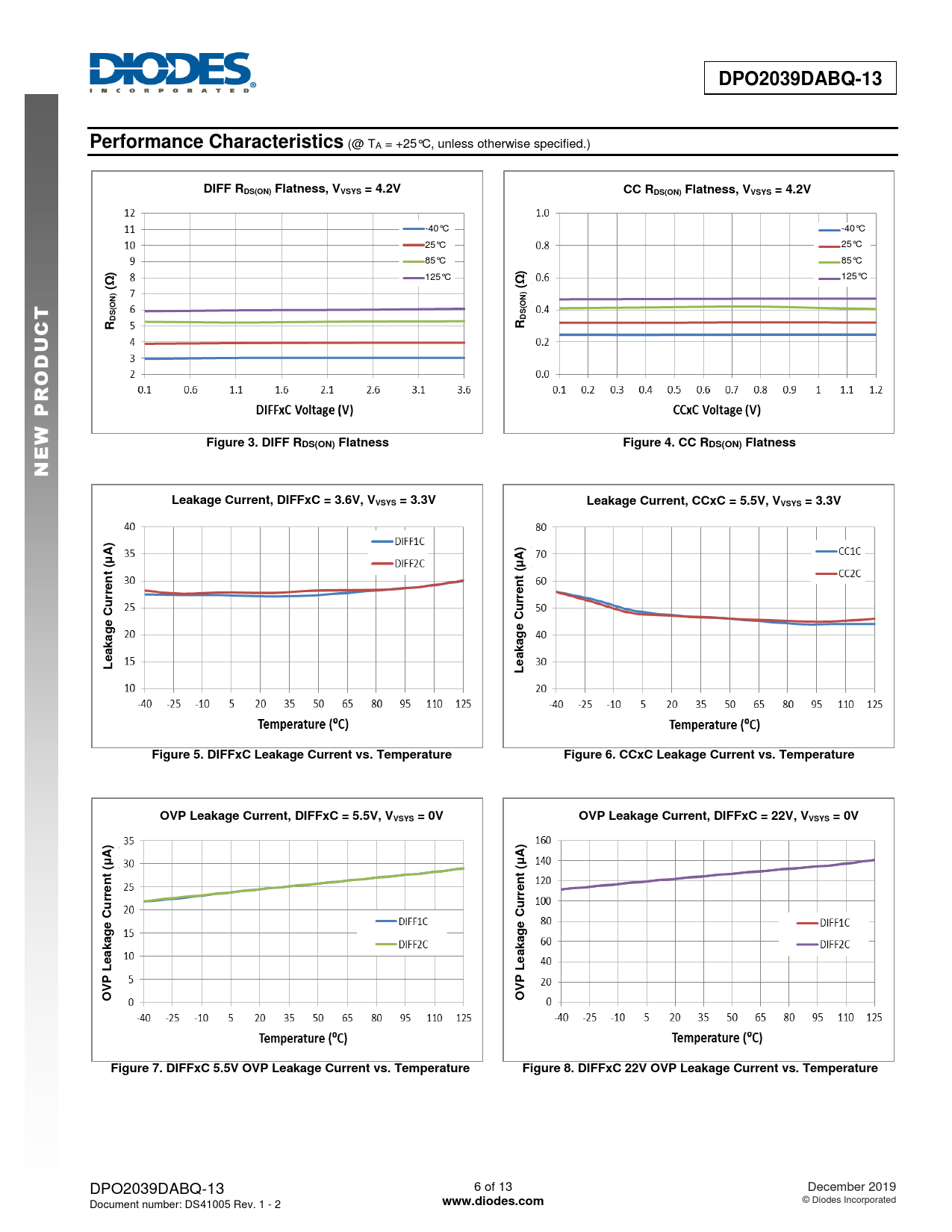

DPO2039DABQ-13. Performance Characteristics. DIFF RDS(ON) Flatness, VVSYS = 4.2V. CC RDS(ON) Flatness, VVSYS = 4.2V. S(O
DPO2039DABQ-13 Performance Characteristics
(@ TA = +25°C, unless otherwise specified.)
DIFF RDS(ON) Flatness, VVSYS = 4.2V CC RDS(ON) Flatness, VVSYS = 4.2V
-40°C -40°C 25°C 25°C 85°C 85°C
125°C 125°C
(Ω (Ω ) ) N N T S(O S(O C D D R R U D O R P W E Figure 3. DIFF RDS(ON) Flatness Figure 4. CC RDS(ON) Flatness N Leakage Current, DIFFxC = 3.6V, VVSYS = 3.3V Leakage Current, CCxC = 5.5V, VVSYS = 3.3V μA) μA) ( ( nt nt urre urre C C ge ge a a k k Lea Lea Figure 5. DIFFxC Leakage Current vs. Temperature Figure 6. CCxC Leakage Current vs. Temperature OVP Leakage Current, DIFFxC = 5.5V, VVSYS = 0V OVP Leakage Current, DIFFxC = 22V, VVSYS = 0V μA) μA) ( ( nt nt re re ur ur C C ge ge a a k k Lea Lea OVP OVP Figure 7. DIFFxC 5.5V OVP Leakage Current vs. Temperature Figure 8. DIFFxC 22V OVP Leakage Current vs. Temperature
