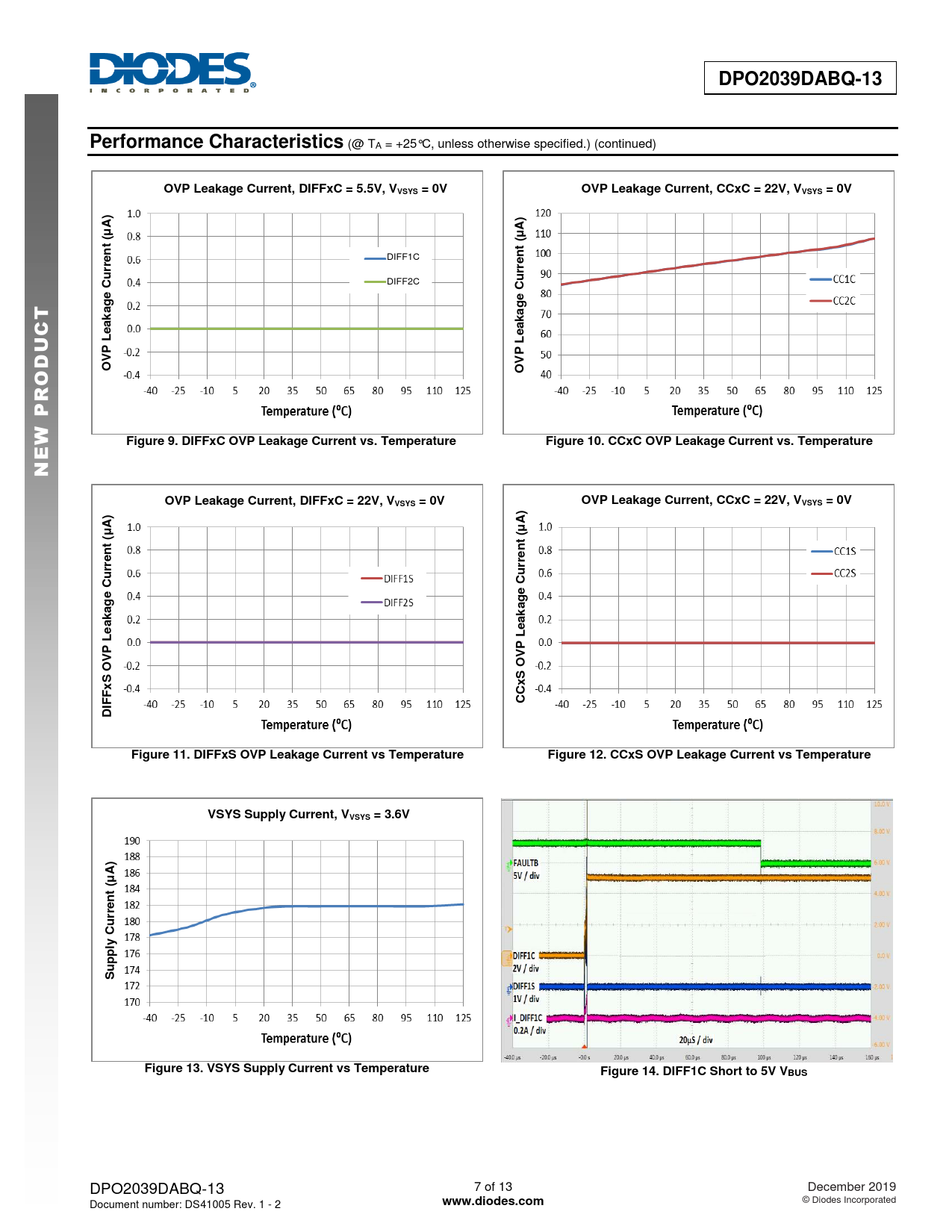

DPO2039DABQ-13. Performance Characteristics. OVP Leakage Current, DIFFxC = 5.5V, VVSYS = 0V
DPO2039DABQ-13 Performance Characteristics
(@ TA = +25°C, unless otherwise specified.) (continued)
OVP Leakage Current, DIFFxC = 5.5V, VVSYS = 0V OVP Leakage Current, CCxC = 22V, VVSYS = 0V μA) μA) ( ( nt nt
DIFF1C
re re ur ur
DIFF2C
C C T ge ge a a C k k U Lea Lea D O OVP OVP R P W E Figure 9. DIFFxC OVP Leakage Current vs. Temperature Figure 10. CCxC OVP Leakage Current vs. Temperature N OVP Leakage Current, DIFFxC = 22V, VVSYS = 0V OVP Leakage Current, CCxC = 22V, VVSYS = 0V μA) μA) ( ( nt nt urre urre C C ge ge a a k k Lea Lea P P OV OV S x C IFFxS C D Figure 11. DIFFxS OVP Leakage Current vs Temperature Figure 12. CCxS OVP Leakage Current vs Temperature VSYS Supply Current, VVSYS = 3.6V μA) ( nt urre C ly upp S Figure 13. VSYS Supply Current vs Temperature Figure 14. DI FF1C Short to 5V VBUS
