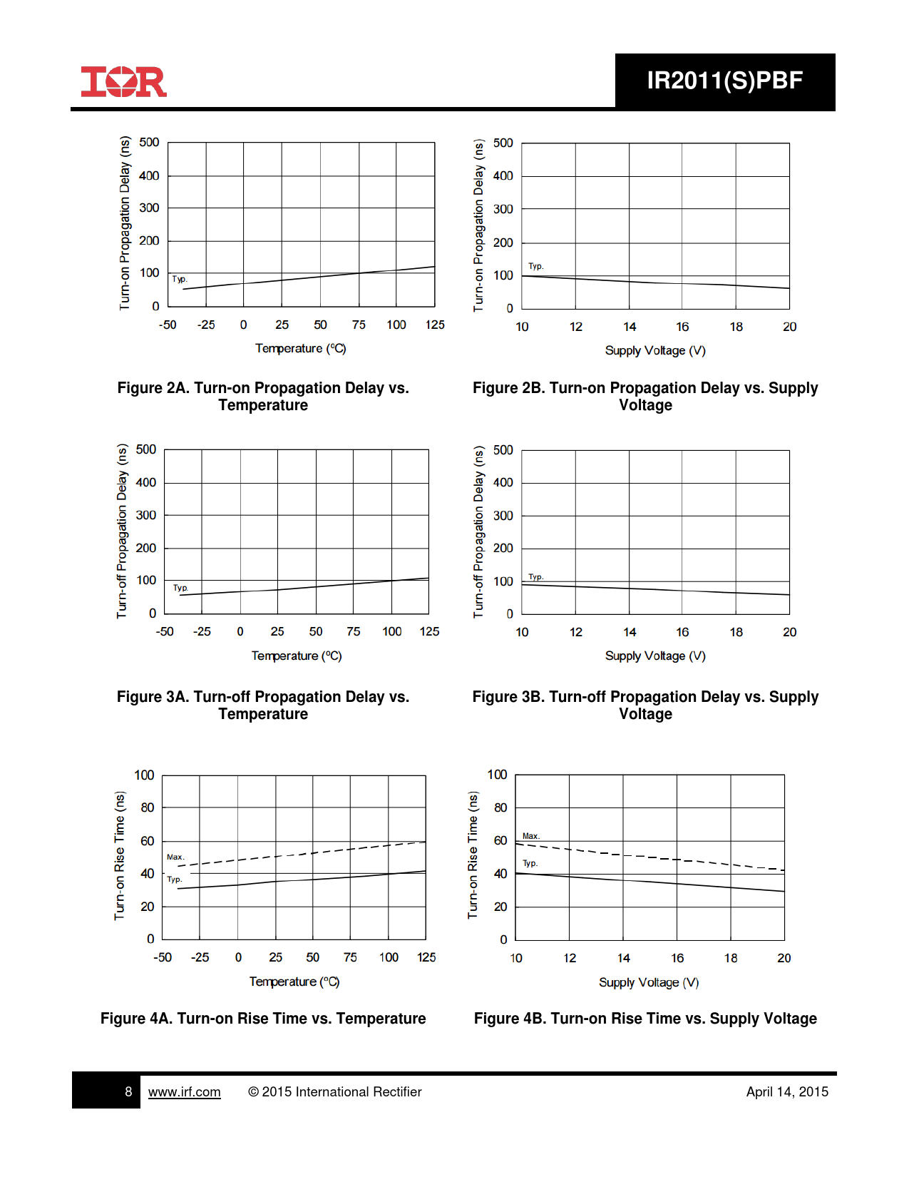

Pages / Page18 / 8 — IR2011(S)PBF. Figure 2A. Turn-on Propagation Delay vs. Figure 2B. Turn-on …
Revision01_00
IR2011(S)PBF. Figure 2A. Turn-on Propagation Delay vs. Figure 2B. Turn-on Propagation Delay vs. Supply. Temperature. Voltage
IR2011(S)PBF Figure 2A Turn-on Propagation Delay vs Figure 2B Turn-on Propagation Delay vs Supply Temperature Voltage
IR2011(S)PBF Figure 2A. Turn-on Propagation Delay vs. Figure 2B. Turn-on Propagation Delay vs. Supply Temperature Voltage Figure 3A. Turn-off Propagation Delay vs. Figure 3B. Turn-off Propagation Delay vs. Supply Temperature Voltage Figure 4A. Turn-on Rise Time vs. Temperature Figure 4B. Turn-on Rise Time vs. Supply Voltage
