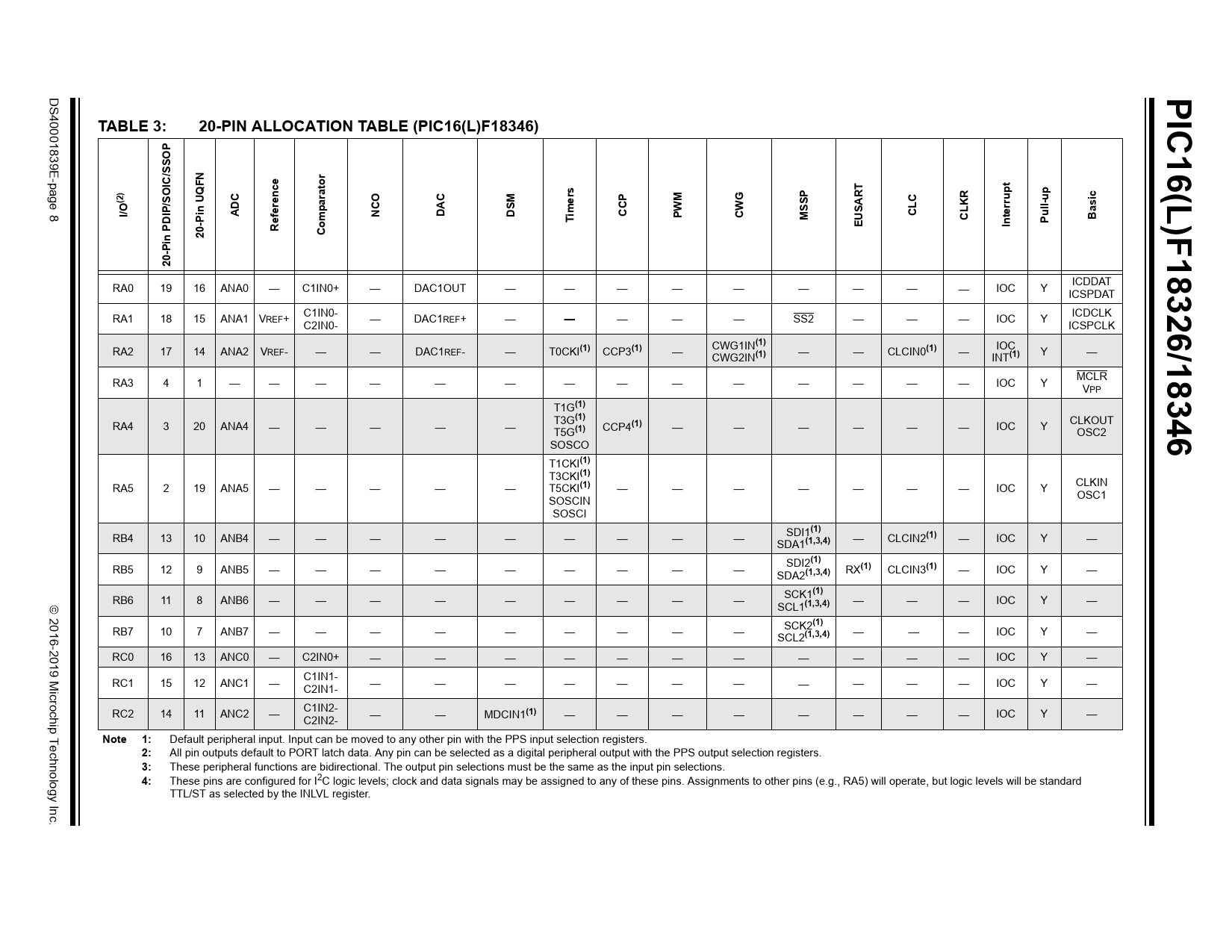

PIC16(L)F18326/18346. TABLE 3:. 20-PIN ALLOCATION TABLE (PIC16(L)F18346). OP SS C/. ator. (2). rru. ll-. I/O. n UQ. ADC. ference. NCO. DAC. ime. CCP
DS400018
PIC16(L)F18326/18346 TABLE 3: 20-PIN ALLOCATION TABLE (PIC16(L)F18346)
39E-page 8
OP SS C/ FN OI ator rs P pt (2) up ic /S ar M M C p KR rru ll- I/O IP n UQ ADC ference NCO DAC DS ime CCP SART CL D Pi T PW CWG MSS U CL Bas E Inte Pu P Re n 20- Com -Pi 20
ICDDAT RA0 19 16 ANA0 — C1IN0+ — DAC1OUT — — — — — — — — — IOC Y ICSPDAT C1IN0- ICDCLK RA1 18 15 ANA1 VREF+ — DAC1 C2IN0- REF+ —
— — — SS2 — — — IOC Y ICSPCLK CWG1IN
(1)
IOC RA2 17 14 ANA2 VREF- — — DAC1REF- — T0CKI
(1)
CCP3
(1)
— CWG2IN
(1)
— — CLCIN0
(1)
— INT
(1)
Y — MCLR RA3 4 1 — — — — — — — — — — — — — — IOC Y VPP T1G
(1)
T3G
(1)
CLKOUT RA4 3 20 ANA4 — — — — — T5G
(1)
CCP4
(1)
— — — — — — IOC Y OSC2 SOSCO T1CKI
(1)
T3CKI
(1)
CLKIN RA5 2 19 ANA5 — — — — — T5CKI
(1)
— — — — — — — IOC Y OSC1 SOSCIN SOSCI SDI1
(1)
RB4 13 10 ANB4 — — — — — — — — — SDA1
(1,3,4)
— CLCIN2
(1)
— IOC Y — SDI2
(1)
RB5 12 9 ANB5 — — — — — — — — — SDA2
(1,3,4)
RX
(1)
CLCIN3
(1)
— IOC Y — SCK1
(1)
RB6 11 8 ANB6 — — — — — — — — — 2016- SCL1
(1,3,4)
— — — IOC Y — SCK2
(1)
RB7 10 7 ANB7 — — — — — — — — — SCL2
(1,3,4)
— — — IOC Y — 2019 Microchip T RC0 16 13 ANC0 — C2IN0+ — — — — — — — — — — — IOC Y — C1IN1- RC1 15 12 ANC1 — — — — — — — — C2IN1- — — — — IOC Y — C1IN2- RC2 14 11 ANC2 — C2IN2- — — MDCIN1
(1)
— — — — — — — — IOC Y — e
Note 1:
Default peripheral input. Input can be moved to any other pin with the PPS input selection registers. chnolo
2:
All pin outputs default to PORT latch data. Any pin can be selected as a digital peripheral output with the PPS output selection registers.
3:
These peripheral functions are bidirectional. The output pin selections must be the same as the input pin selections. g
4:
