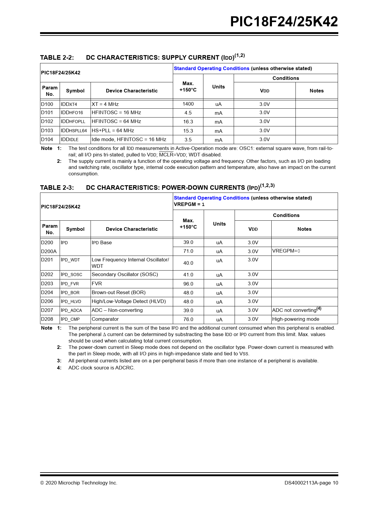

PIC18F24/25K42. TABLE 2-2:. DC CHARACTERISTICS: SUPPLY CURRENT (IDD)(1,2). Standard Operating Conditions
PIC18F24/25K42 TABLE 2-2: DC CHARACTERISTICS: SUPPLY CURRENT (IDD)(1,2) Standard Operating Conditions
link to page 9 link to page 9
PIC18F24/25K42 TABLE 2-2: DC CHARACTERISTICS: SUPPLY CURRENT (IDD)(1,2) Standard Operating Conditions (unless otherwise stated) PIC18F24/25K42 Conditions Max. Param Units Symbol Device Characteristic +150°C VDD Notes No.
D100 IDDXT4 XT = 4 MHz 1400 uA 3.0V D101 IDDHFO16 HFINTOSC = 16 MHz 4.5 mA 3.0V D102 IDDHFOPLL HFINTOSC = 64 MHz 16.3 mA 3.0V D103 IDDHSPLL64 HS+PLL = 64 MHz 15.3 mA 3.0V D104 IDDIDLE Idle mode, HFINTOSC = 16 MHz 3.5 mA 3.0V
Note 1:
The test conditions for all IDD measurements in Active-Operation mode are: OSC1: external square wave, from rail-to- rail; all I/O pins tri-stated, pulled to VDD; MCLR=VDD; WDT disabled.
2:
The supply current is mainly a function of the operating voltage and frequency. Other factors, such as I/O pin loading and switching rate, oscillator type, internal code execution pattern and temperature, also have an impact on the current consumption.
TABLE 2-3: DC CHARACTERISTICS: POWER-DOWN CURRENTS (IPD)(1,2,3) Standard Operating Conditions (unless otherwise stated) PIC18F24/25K42 VREPGM = 1 Conditions Max. Units Param +150°C Symbol Device Characteristic VDD Notes No.
D200 IPD IPD Base 39.0 uA 3.0V D200A 71.0 uA 3.0V VREGPM=0 D201 IPD_WDT Low Frequency Internal Oscillator/ 40.0 uA 3.0V WDT D202 IPD_SOSC Secondary Oscillator (SOSC) 41.0 uA 3.0V D203 IPD_FVR FVR 96.0 uA 3.0V D204 IPD_BOR Brown-out Reset (BOR) 48.0 uA 3.0V D206 IPD_HLVD High/Low-Voltage Detect (HLVD) 48.0 uA 3.0V D207 IPD_ADCA ADC – Non-converting 39.0 uA 3.0V ADC not converting
(4)
D208 IPD_CMP Comparator 76.0 uA 3.0V High-powering mode
Note 1:
The peripheral current is the sum of the base IPD and the additional current consumed when this peripheral is enabled. The peripheral  current can be determined by substracting the base IDD or IPD current from this limit. Max. values should be used when calculating total current consumption.
2:
The power-down current in Sleep mode does not depend on the oscil ator type. Power-down current is measured with the part in Sleep mode, with all I/O pins in high-impedance state and tied to VSS.
3:
All peripheral currents listed are on a per-peripheral basis if more than one instance of a peripheral is available.
4:
ADC clock source is ADCRC.  2020 Microchip Technology Inc. DS40002113A-page 10 Document Outline Description Family Types Table of Contents 1.0 Device Overview 2.0 Electrical Characteristics TABLE 2-1: Supply Voltage (High Temperature) FIGURE 2-1: Voltage-Frequency Graph, -40°C £ Ta £ +150°C TABLE 2-2: DC Characteristics: Supply Current (Idd)(1,2) TABLE 2-3: DC Characteristics: Power-Down Currents (Ipd)(1,2,3) TABLE 2-4: Memory Specifications (150°C) TABLE 2-5: Internal Oscillator Parameters(1) FIGURE 3-2: Precision-Calibrated HFINTOSC Frequency Accuracy Over Device Vdd and Temperature TABLE 2-6: Reset, Watchdog Timer, Oscillator Start-up Timer, Power-up Timer, Brown-out Timer and Low-Power Brown-out Reset Specifications TABLE 2-7: High/Low-Voltage Detect Characteristics TABLE 2-8: Fixed Voltage Reference (FVR) Specifications Appendix A: Revision History Product ID System Trademarks Worldwide Sales
