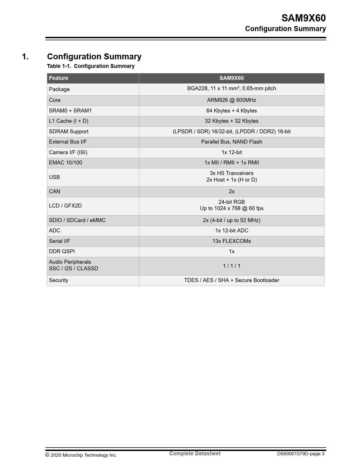

SAM9X60. Configuration Summary. Configuration Summary Table 1-1. Configuration Summary. Feature. Complete Datasheet
SAM9X60 Configuration Summary Configuration Summary Table 1-1. Configuration Summary Feature Complete Datasheet
SAM9X60 Configuration Summary 1. Configuration Summary Table 1-1. Configuration Summary Feature SAM9X60
Package BGA228, 11 x 11 mm², 0.65-mm pitch Core ARM926 @ 600MHz SRAM0 + SRAM1 64 Kbytes + 4 Kbytes L1 Cache (I + D) 32 Kbytes + 32 Kbytes SDRAM Support (LPSDR / SDR) 16/32-bit, (LPDDR / DDR2) 16-bit External Bus I/F Parallel Bus, NAND Flash Camera I/F (ISI) 1x 12-bit EMAC 10/100 1x MII / RMII + 1x RMII 3x HS Tranceivers USB 2x Host + 1x (H or D) CAN 2x 24-bit RGB LCD / GFX2D Up to 1024 x 768 @ 60 fps SDIO / SDCard / eMMC 2x (4-bit / up to 52 MHz) ADC 1x 12-bit ADC Serial I/F 13x FLEXCOMs DDR QSPI 1x Audio Peripherals SSC / I2S / CLASSD 1 / 1 / 1 Security TDES / AES / SHA + Secure Bootloader © 2020 Microchip Technology Inc.
