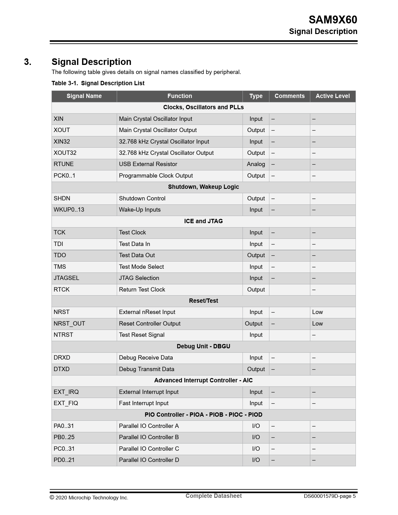

SAM9X60 Signal Description 3. Signal Description
The following table gives details on signal names classified by peripheral.
Table 3-1. Signal Description List Signal Name Function Type Comments Active Level Clocks, Oscillators and PLLs
XIN Main Crystal Oscillator Input Input – – XOUT Main Crystal Oscillator Output Output – – XIN32 32.768 kHz Crystal Oscillator Input Input – – XOUT32 32.768 kHz Crystal Oscillator Output Output – – RTUNE USB External Resistor Analog – – PCK0..1 Programmable Clock Output Output – –
Shutdown, Wakeup Logic
SHDN Shutdown Control Output – – WKUP0..13 Wake-Up Inputs Input – –
ICE and JTAG
TCK Test Clock Input – – TDI Test Data In Input – – TDO Test Data Out Output – – TMS Test Mode Select Input – – JTAGSEL JTAG Selection Input – – RTCK Return Test Clock Output –
Reset/Test
NRST External nReset Input Input – Low NRST_OUT Reset Controller Output Output – Low NTRST Test Reset Signal Input –
Debug Unit - DBGU
DRXD Debug Receive Data Input – – DTXD Debug Transmit Data Output – –
Advanced Interrupt Controller - AIC
EXT_IRQ External Interrupt Input Input – – EXT_FIQ Fast Interrupt Input Input – –
PIO Controller - PIOA - PIOB - PIOC - PIOD
PA0..31 Parallel IO Controller A I/O – – PB0..25 Parallel IO Controller B I/O – – PC0..31 Parallel IO Controller C I/O – – PD0..21 Parallel IO Controller D I/O – – © 2020 Microchip Technology Inc.
