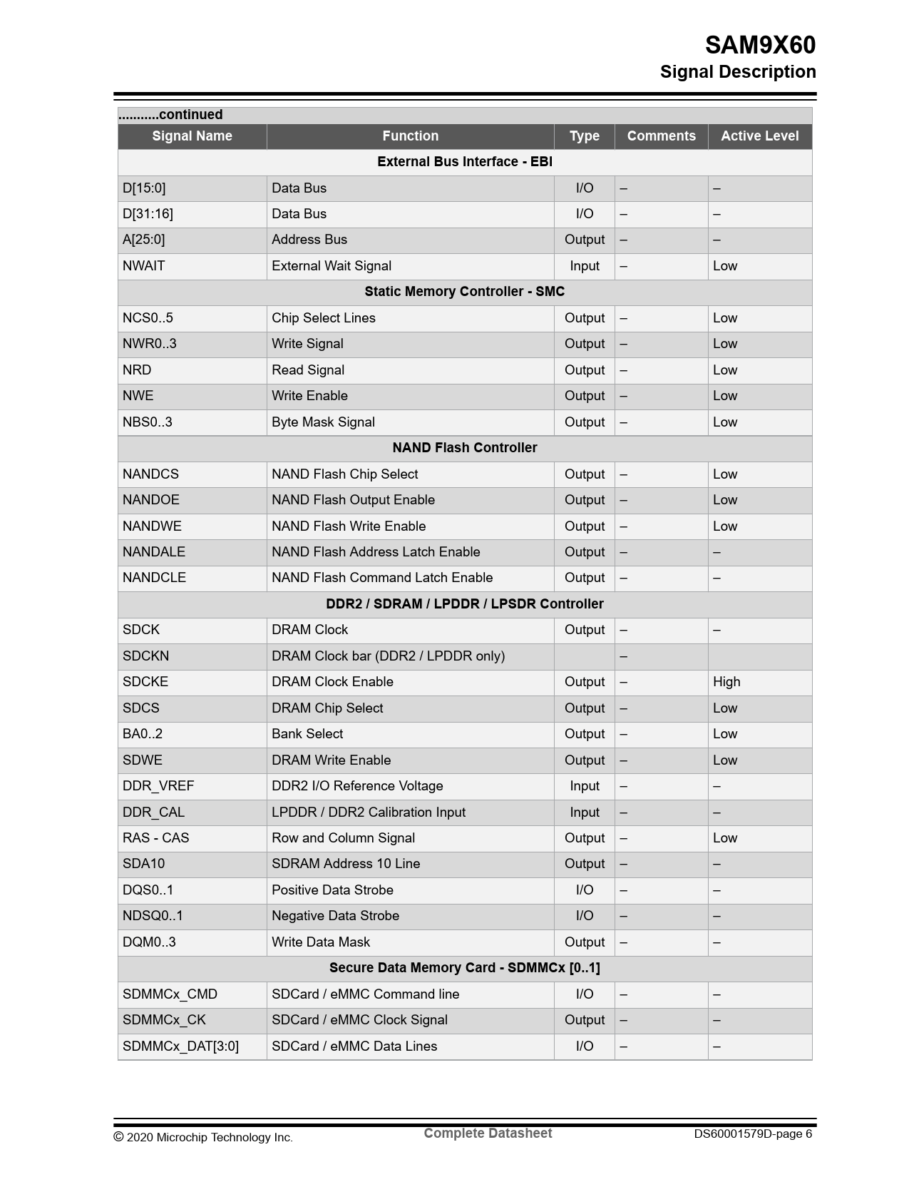

SAM9X60. Signal Description. ...continued. Signal Name. Function. Type. Comments. Active Level. External Bus Interface - EBI
SAM9X60 Signal Description ...continued Signal Name Function Type Comments Active Level External Bus Interface - EBI
D[15:0] Data Bus I/O – – D[31:16] Data Bus I/O – – A[25:0] Address Bus Output – – NWAIT External Wait Signal Input – Low
Static Memory Controller - SMC
NCS0..5 Chip Select Lines Output – Low NWR0..3 Write Signal Output – Low NRD Read Signal Output – Low NWE Write Enable Output – Low NBS0..3 Byte Mask Signal Output – Low
NAND Flash Controller
NANDCS NAND Flash Chip Select Output – Low NANDOE NAND Flash Output Enable Output – Low NANDWE NAND Flash Write Enable Output – Low NANDALE NAND Flash Address Latch Enable Output – – NANDCLE NAND Flash Command Latch Enable Output – –
DDR2 / SDRAM / LPDDR / LPSDR Controller
SDCK DRAM Clock Output – – SDCKN DRAM Clock bar (DDR2 / LPDDR only) – SDCKE DRAM Clock Enable Output – High SDCS DRAM Chip Select Output – Low BA0..2 Bank Select Output – Low SDWE DRAM Write Enable Output – Low DDR_VREF DDR2 I/O Reference Voltage Input – – DDR_CAL LPDDR / DDR2 Calibration Input Input – – RAS - CAS Row and Column Signal Output – Low SDA10 SDRAM Address 10 Line Output – – DQS0..1 Positive Data Strobe I/O – – NDSQ0..1 Negative Data Strobe I/O – – DQM0..3 Write Data Mask Output – –
Secure Data Memory Card - SDMMCx [0..1]
SDMMCx_CMD SDCard / eMMC Command line I/O – – SDMMCx_CK SDCard / eMMC Clock Signal Output – – SDMMCx_DAT[3:0] SDCard / eMMC Data Lines I/O – – © 2020 Microchip Technology Inc.
