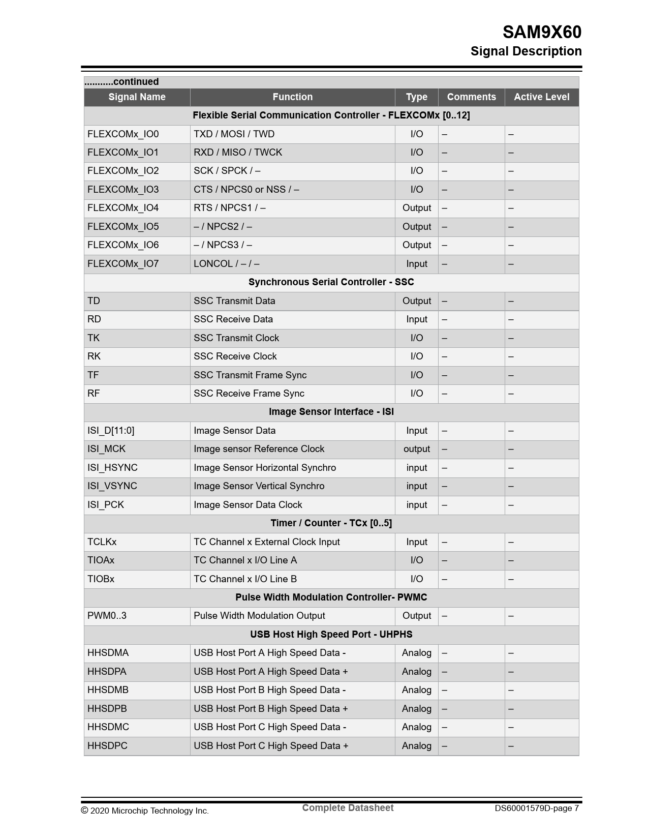

SAM9X60. Signal Description. ...continued. Signal Name. Function. Type. Comments. Active Level
SAM9X60 Signal Description ...continued Signal Name Function Type Comments Active Level Flexible Serial Communication Controller - FLEXCOMx [0..12]
FLEXCOMx_IO0 TXD / MOSI / TWD I/O – – FLEXCOMx_IO1 RXD / MISO / TWCK I/O – – FLEXCOMx_IO2 SCK / SPCK / – I/O – – FLEXCOMx_IO3 CTS / NPCS0 or NSS / – I/O – – FLEXCOMx_IO4 RTS / NPCS1 / – Output – – FLEXCOMx_IO5 – / NPCS2 / – Output – – FLEXCOMx_IO6 – / NPCS3 / – Output – – FLEXCOMx_IO7 LONCOL / – / – Input – –
Synchronous Serial Controller - SSC
TD SSC Transmit Data Output – – RD SSC Receive Data Input – – TK SSC Transmit Clock I/O – – RK SSC Receive Clock I/O – – TF SSC Transmit Frame Sync I/O – – RF SSC Receive Frame Sync I/O – –
Image Sensor Interface - ISI
ISI_D[11:0] Image Sensor Data Input – – ISI_MCK Image sensor Reference Clock output – – ISI_HSYNC Image Sensor Horizontal Synchro input – – ISI_VSYNC Image Sensor Vertical Synchro input – – ISI_PCK Image Sensor Data Clock input – –
Timer / Counter - TCx [0..5]
TCLKx TC Channel x External Clock Input Input – – TIOAx TC Channel x I/O Line A I/O – – TIOBx TC Channel x I/O Line B I/O – –
Pulse Width Modulation Controller- PWMC
PWM0..3 Pulse Width Modulation Output Output – –
USB Host High Speed Port - UHPHS
HHSDMA USB Host Port A High Speed Data - Analog – – HHSDPA USB Host Port A High Speed Data + Analog – – HHSDMB USB Host Port B High Speed Data - Analog – – HHSDPB USB Host Port B High Speed Data + Analog – – HHSDMC USB Host Port C High Speed Data - Analog – – HHSDPC USB Host Port C High Speed Data + Analog – – © 2020 Microchip Technology Inc.
