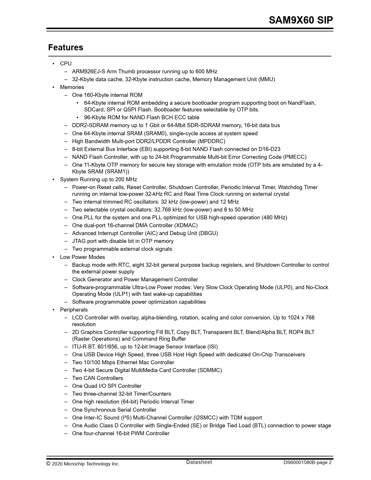

SAM9X60 SIP. Features. Datasheet
SAM9X60 SIP Features Datasheet
• CPU – ARM926EJ-S Arm Thumb processor running up to 600 MHz – 32-Kbyte data cache, 32-Kbyte instruction cache, Memory Management Unit (MMU) • Memories – One 160-Kbyte internal ROM • 64-Kbyte internal ROM embedding a secure bootloader program supporting boot on NandFlash, SDCard, SPI or QSPI Flash. Bootloader features selectable by OTP bits. • 96-Kbyte ROM for NAND Flash BCH ECC table – DDR2-SDRAM memory up to 1 Gbit or 64-Mbit SDR-SDRAM memory, 16-bit data bus – One 64-Kbyte internal SRAM (SRAM0), single-cycle access at system speed – High Bandwidth Multi-port DDR2/LPDDR Controller (MPDDRC) – 8-bit External Bus Interface (EBI) supporting 8-bit NAND Flash connected on D16-D23 – NAND Flash Controller, with up to 24-bit Programmable Multi-bit Error Correcting Code (PMECC) – One 11-Kbyte OTP memory for secure key storage with emulation mode (OTP bits are emulated by a 4- Kbyte SRAM (SRAM1)) • System Running up to 200 MHz – Power-on Reset cells, Reset Controller, Shutdown Controller, Periodic Interval Timer, Watchdog Timer running on internal low-power 32-kHz RC and Real Time Clock running on external crystal – Two internal trimmed RC oscillators: 32 kHz (low-power) and 12 MHz – Two selectable crystal oscillators: 32.768 kHz (low-power) and 8 to 50 MHz – One PLL for the system and one PLL optimized for USB high-speed operation (480 MHz) – One dual-port 16-channel DMA Controller (XDMAC) – Advanced Interrupt Controller (AIC) and Debug Unit (DBGU) – JTAG port with disable bit in OTP memory – Two programmable external clock signals • Low Power Modes – Backup mode with RTC, eight 32-bit general purpose backup registers, and Shutdown Controller to control the external power supply – Clock Generator and Power Management Controller – Software-programmable Ultra-Low Power modes: Very Slow Clock Operating Mode (ULP0), and No-Clock Operating Mode (ULP1) with fast wake-up capabilities – Software programmable power optimization capabilities • Peripherals – LCD Controller with overlay, alpha-blending, rotation, scaling and color conversion. Up to 1024 x 768 resolution – 2D Graphics Controller supporting Fill BLT, Copy BLT, Transparent BLT, Blend/Alpha BLT, ROP4 BLT (Raster Operations) and Command Ring Buffer – ITU-R BT. 601/656, up to 12-bit Image Sensor Interface (ISI) – One USB Device High Speed, three USB Host High Speed with dedicated On-Chip Transceivers – Two 10/100 Mbps Ethernet Mac Controller – Two 4-bit Secure Digital MultiMedia Card Controller (SDMMC) – Two CAN Controllers – One Quad I/O SPI Controller – Two three-channel 32-bit Timer/Counters – One high resolution (64-bit) Periodic Interval Timer – One Synchronous Serial Controller – One Inter-IC Sound (I²S) Multi-Channel Controller (I2SMCC) with TDM support – One Audio Class D Controller with Single-Ended (SE) or Bridge Tied Load (BTL) connection to power stage – One four-channel 16-bit PWM Controller © 2020 Microchip Technology Inc.
