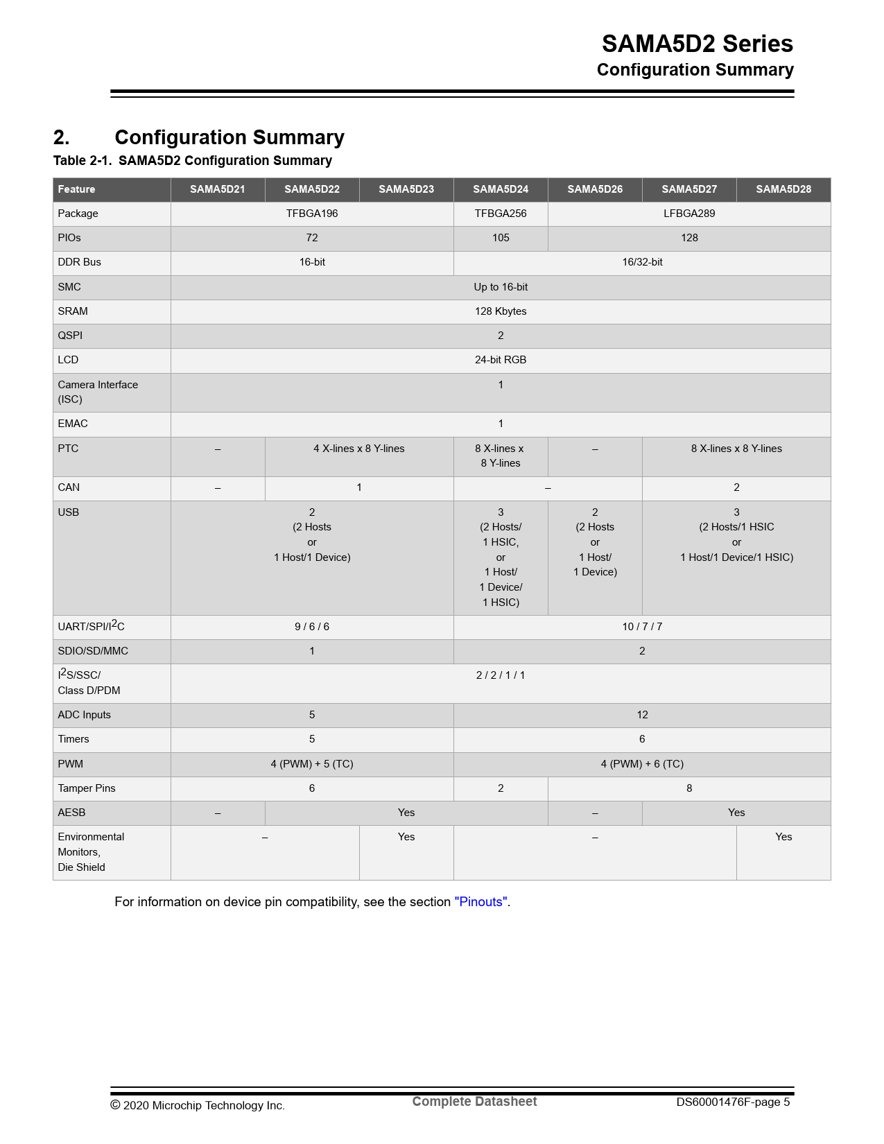

SAMA5D2 Series. Configuration Summary. Table 2-1. SAMA5D2 Configuration Summary. Feature. SAMA5D21. SAMA5D22. SAMA5D23. SAMA5D24
SAMA5D2 Series Configuration Summary Table 2-1. SAMA5D2 Configuration Summary Feature SAMA5D21 SAMA5D22 SAMA5D23 SAMA5D24
link to page 20
SAMA5D2 Series Configuration Summary 2. Configuration Summary Table 2-1. SAMA5D2 Configuration Summary Feature SAMA5D21 SAMA5D22 SAMA5D23 SAMA5D24 SAMA5D26 SAMA5D27 SAMA5D28
Package TFBGA196 TFBGA256 LFBGA289 PIOs 72 105 128 DDR Bus 16-bit 16/32-bit SMC Up to 16-bit SRAM 128 Kbytes QSPI 2 LCD 24-bit RGB Camera Interface 1 (ISC) EMAC 1 PTC – 4 X-lines x 8 Y-lines 8 X-lines x – 8 X-lines x 8 Y-lines 8 Y-lines CAN – 1 – 2 USB 2 3 2 3 (2 Hosts (2 Hosts/ (2 Hosts (2 Hosts/1 HSIC or 1 HSIC, or or 1 Host/1 Device) or 1 Host/ 1 Host/1 Device/1 HSIC) 1 Host/ 1 Device) 1 Device/ 1 HSIC) UART/SPI/I2C 9 / 6 / 6 10 / 7 / 7 SDIO/SD/MMC 1 2 I2S/SSC/ 2 / 2 / 1 / 1 Class D/PDM ADC Inputs 5 12 Timers 5 6 PWM 4 (PWM) + 5 (TC) 4 (PWM) + 6 (TC) Tamper Pins 6 2 8 AESB – Yes – Yes Environmental – Yes – Yes Monitors, Die Shield For information on device pin compatibility, see the section "Pinouts". © 2020 Microchip Technology Inc.
