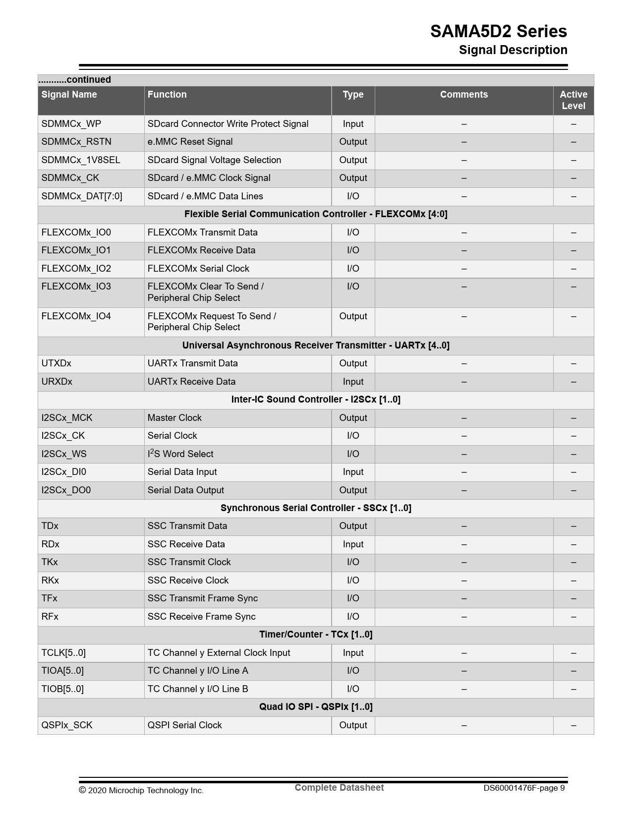

SAMA5D2 Series. Signal Description. ...continued. Signal Name. Function. Type. Comments. Active. Level
SAMA5D2 Series Signal Description ...continued Signal Name Function Type Comments Active Level
SDMMCx_WP SDcard Connector Write Protect Signal Input – – SDMMCx_RSTN e.MMC Reset Signal Output – – SDMMCx_1V8SEL SDcard Signal Voltage Selection Output – – SDMMCx_CK SDcard / e.MMC Clock Signal Output – – SDMMCx_DAT[7:0] SDcard / e.MMC Data Lines I/O – –
Flexible Serial Communication Controller - FLEXCOMx [4:0]
FLEXCOMx_IO0 FLEXCOMx Transmit Data I/O – – FLEXCOMx_IO1 FLEXCOMx Receive Data I/O – – FLEXCOMx_IO2 FLEXCOMx Serial Clock I/O – – FLEXCOMx_IO3 FLEXCOMx Clear To Send / I/O – – Peripheral Chip Select FLEXCOMx_IO4 FLEXCOMx Request To Send / Output – – Peripheral Chip Select
Universal Asynchronous Receiver Transmitter - UARTx [4..0]
UTXDx UARTx Transmit Data Output – – URXDx UARTx Receive Data Input – –
Inter-IC Sound Controller - I2SCx [1..0]
I2SCx_MCK Master Clock Output – – I2SCx_CK Serial Clock I/O – – I2SCx_WS I2S Word Select I/O – – I2SCx_DI0 Serial Data Input Input – – I2SCx_DO0 Serial Data Output Output – –
Synchronous Serial Controller - SSCx [1..0]
TDx SSC Transmit Data Output – – RDx SSC Receive Data Input – – TKx SSC Transmit Clock I/O – – RKx SSC Receive Clock I/O – – TFx SSC Transmit Frame Sync I/O – – RFx SSC Receive Frame Sync I/O – –
Timer/Counter - TCx [1..0]
TCLK[5..0] TC Channel y External Clock Input Input – – TIOA[5..0] TC Channel y I/O Line A I/O – – TIOB[5..0] TC Channel y I/O Line B I/O – –
Quad IO SPI - QSPIx [1..0]
QSPIx_SCK QSPI Serial Clock Output – – © 2020 Microchip Technology Inc.
