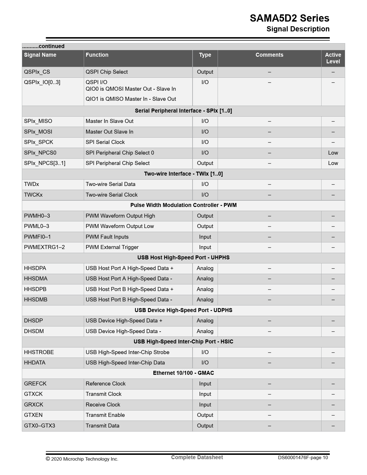

SAMA5D2 Series. Signal Description. ...continued. Signal Name. Function. Type. Comments. Active. Level
SAMA5D2 Series Signal Description ...continued Signal Name Function Type Comments Active Level
QSPIx_CS QSPI Chip Select Output – – QSPIx_IO[0..3] QSPI I/O I/O – – QIO0 is QMOSI Master Out - Slave In QIO1 is QMISO Master In - Slave Out
Serial Peripheral Interface - SPIx [1..0]
SPIx_MISO Master In Slave Out I/O – – SPIx_MOSI Master Out Slave In I/O – – SPIx_SPCK SPI Serial Clock I/O – – SPIx_NPCS0 SPI Peripheral Chip Select 0 I/O – Low SPIx_NPCS[3..1] SPI Peripheral Chip Select Output – Low
Two-wire Interface - TWIx [1..0]
TWDx Two-wire Serial Data I/O – – TWCKx Two-wire Serial Clock I/O – –
Pulse Width Modulation Controller - PWM
PWMH0–3 PWM Waveform Output High Output – – PWML0–3 PWM Waveform Output Low Output – – PWMFI0–1 PWM Fault Inputs Input – – PWMEXTRG1–2 PWM External Trigger Input – –
USB Host High-Speed Port - UHPHS
HHSDPA USB Host Port A High-Speed Data + Analog – – HHSDMA USB Host Port A High-Speed Data - Analog – – HHSDPB USB Host Port B High-Speed Data + Analog – – HHSDMB USB Host Port B High-Speed Data - Analog – –
USB Device High-Speed Port - UDPHS
DHSDP USB Device High-Speed Data + Analog – – DHSDM USB Device High-Speed Data - Analog – –
USB High-Speed Inter-Chip Port - HSIC
HHSTROBE USB High-Speed Inter-Chip Strobe I/O – – HHDATA USB High-Speed Inter-Chip Data I/O – –
Ethernet 10/100 - GMAC
GREFCK Reference Clock Input – – GTXCK Transmit Clock Input – – GRXCK Receive Clock Input – – GTXEN Transmit Enable Output – – GTX0–GTX3 Transmit Data Output – – © 2020 Microchip Technology Inc.
