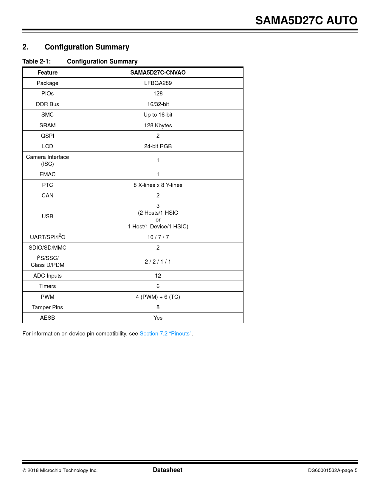

SAMA5D27C AUTO. Configuration Summary. Table 2-1:. Feature. SAMA5D27C-CNVAO. Datasheet
SAMA5D27C AUTO Configuration Summary Table 2-1: Feature SAMA5D27C-CNVAO Datasheet
link to page 19
SAMA5D27C AUTO 2. Configuration Summary Table 2-1: Configuration Summary Feature SAMA5D27C-CNVAO
Package LFBGA289 PIOs 128 DDR Bus 16/32-bit SMC Up to 16-bit SRAM 128 Kbytes QSPI 2 LCD 24-bit RGB Camera Interface 1 (ISC) EMAC 1 PTC 8 X-lines x 8 Y-lines CAN 2 3 (2 Hosts/1 HSIC USB or 1 Host/1 Device/1 HSIC) UART/SPI/I2C 10 / 7 / 7 SDIO/SD/MMC 2 I2S/SSC/ 2 / 2 / 1 / 1 Class D/PDM ADC Inputs 12 Timers 6 PWM 4 (PWM) + 6 (TC) Tamper Pins 8 AESB Yes For information on device pin compatibility, see Section 7.2 “Pinouts”.  2018 Microchip Technology Inc.
